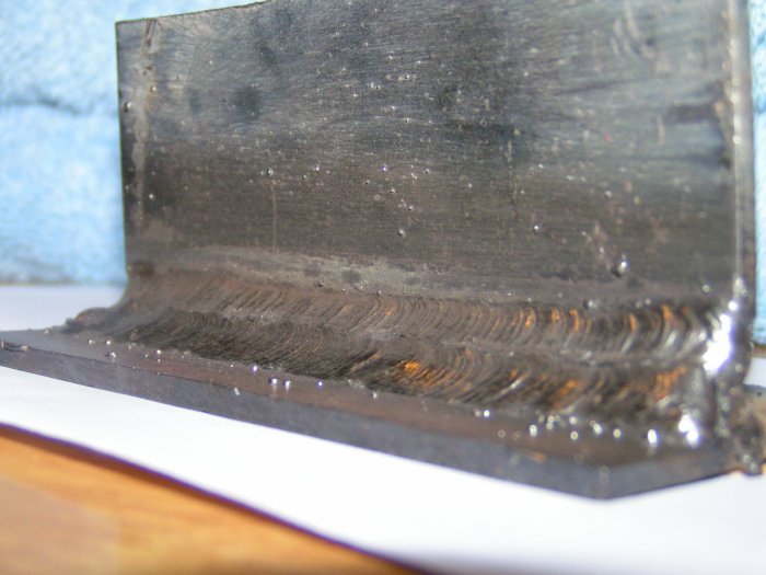

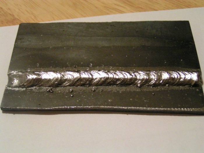

Looking good, you just need to keep everything a bit tighter, on the first photo it looks as if you strayed out onto the bottom plate a bit far, with a bit more practise you'll have it cracked
The fillet is looking a lot better, the lap joint is a bit peaky and you're not getting a smooth transition at the toe of the weld, try playing around with power settings, angles and travel speeds a bit
angle the rod towards the lower plate?
i seem to run them hotter,120ish for flat.we were given budget rods for a week,Geko.slag was a right effort to get off.i wouldnt mind but the good rods,Oerlikon,they were getting for a quid per kilo!
90 is very cold, 115 is normal i could do it vertical at that. Better off way too hot than too cold, you could do it at 150 no problem
