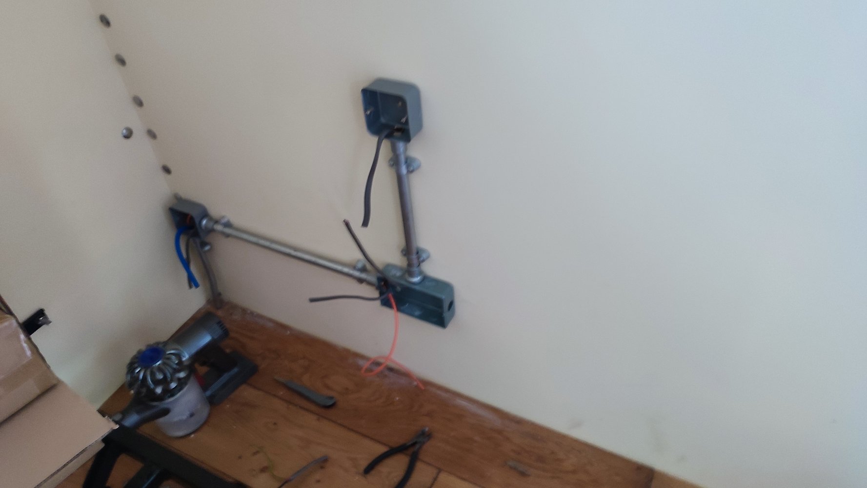

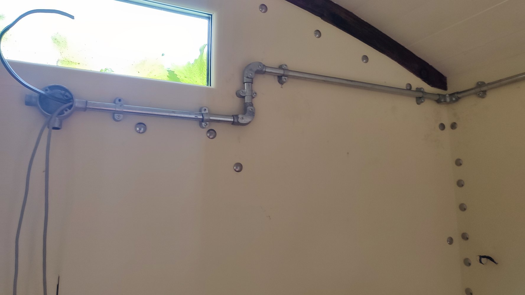

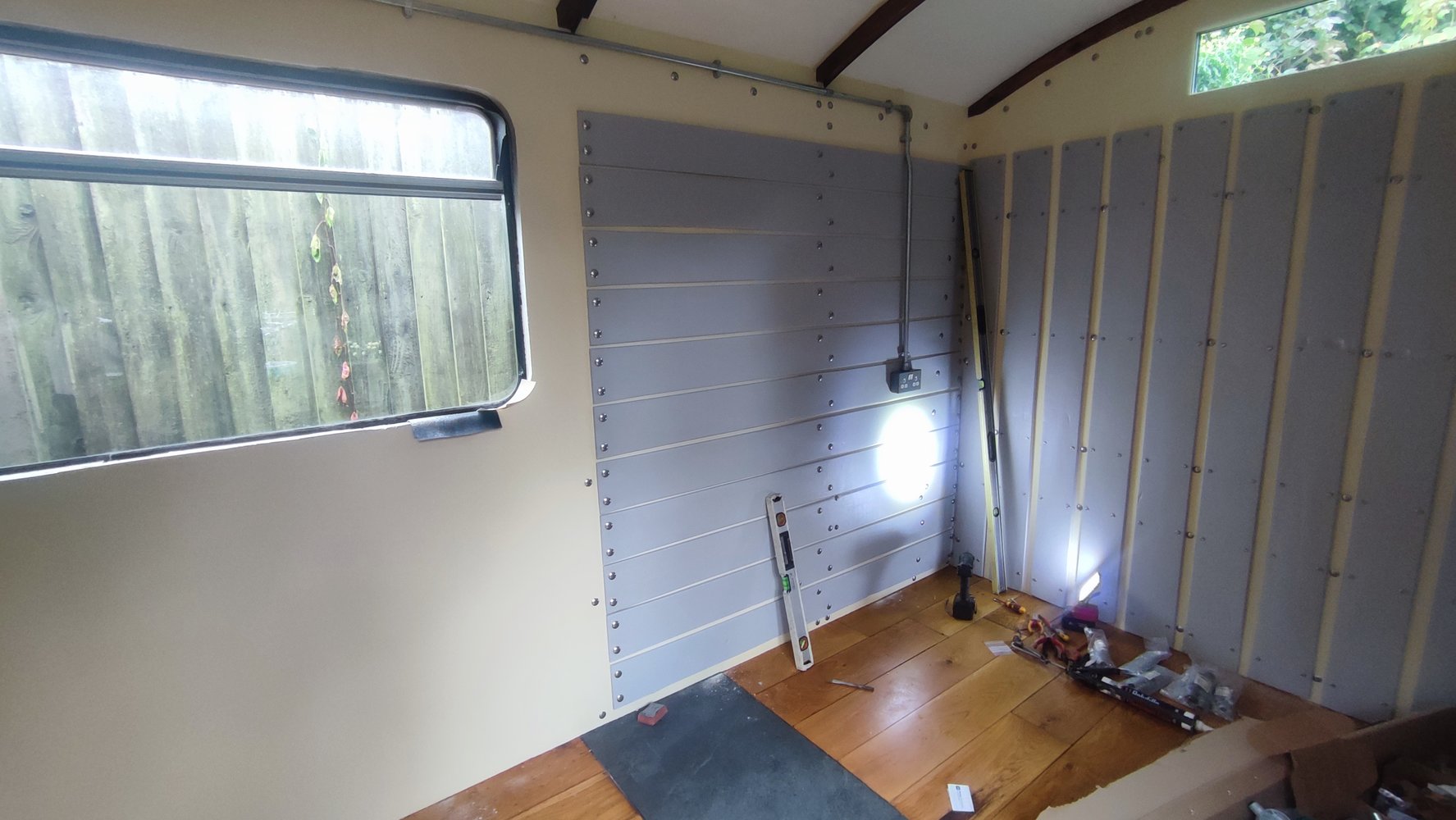

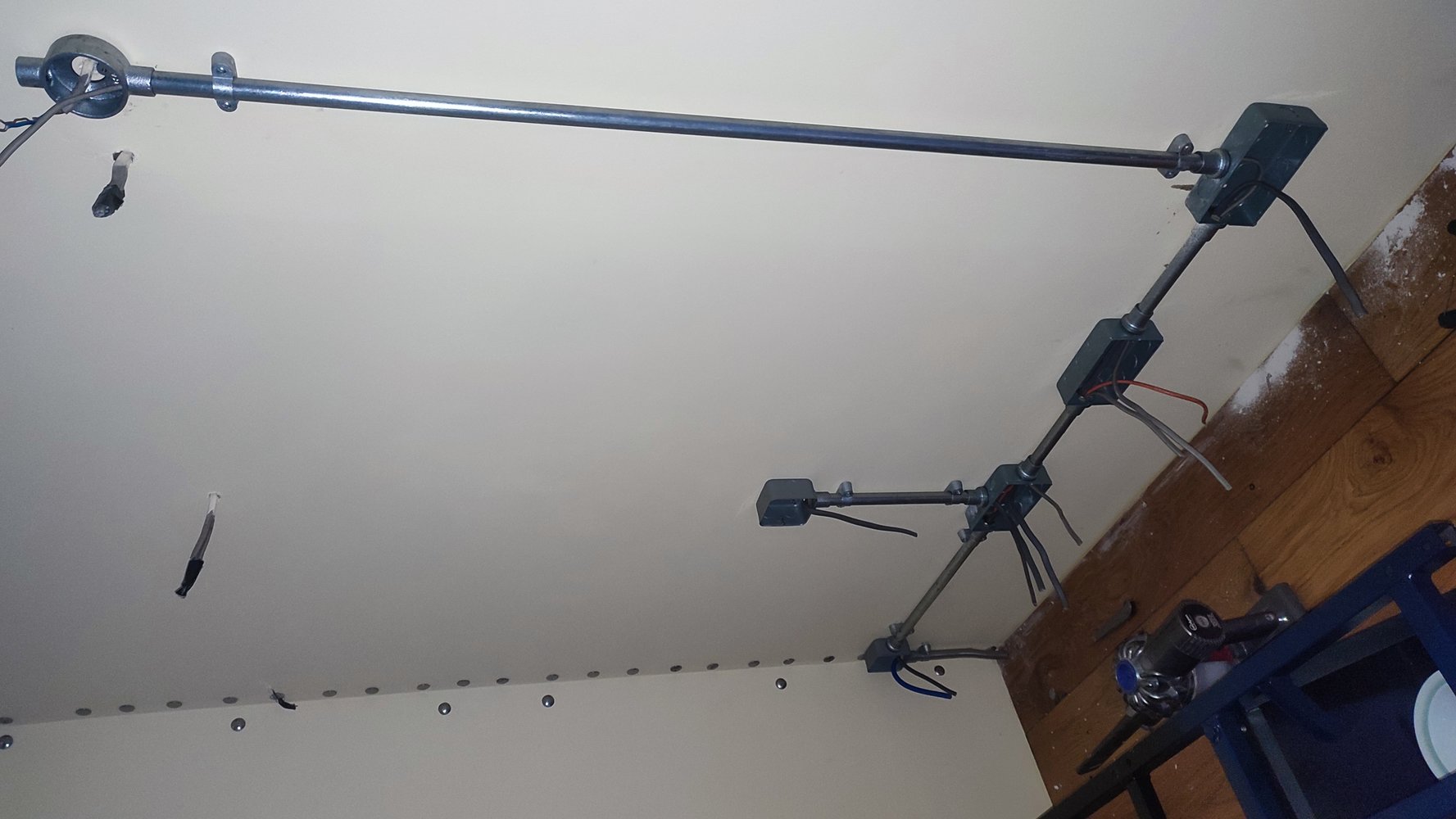

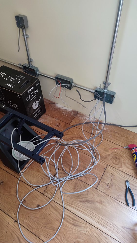

Cat5 and mains cabling should be in separate containment.
that looks all ott why metal conduit and 4 saddlesProgress, this is quite satisfying.
View attachment 465884 View attachment 465885 View attachment 465886
doesnt need any at that distance .no need for for those couplings as well plastic conduit would have been better,its not a workshop that could be damaged with heavy metal dropping on itAgree on the saddles and spacing of them.that looks all ott why metal conduit and 4 saddlesdoesnt need any at that distance .no need for for those couplings as well plastic conduit would have been better,its not a workshop that could be damaged with heavy metal dropping on it
