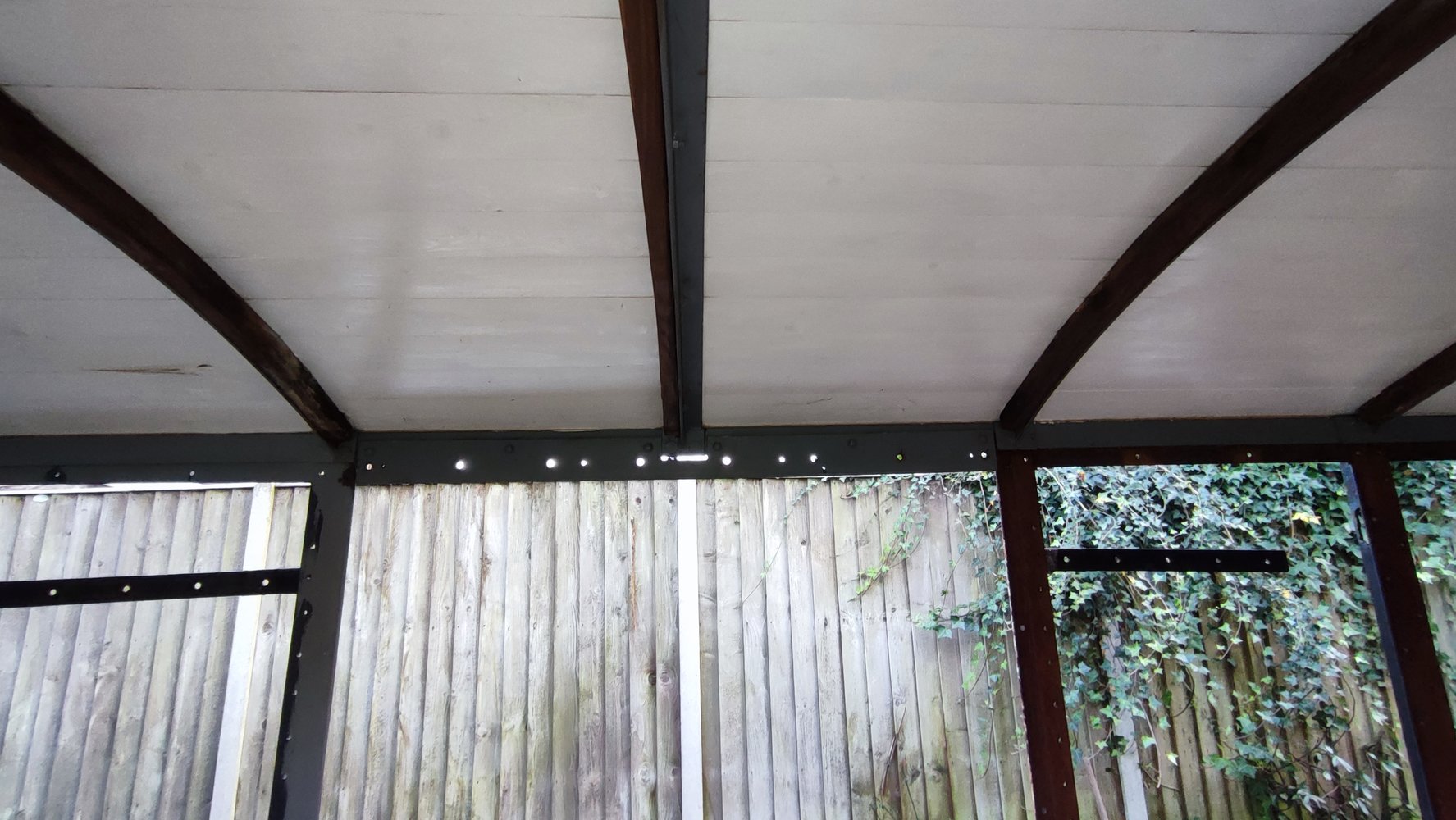

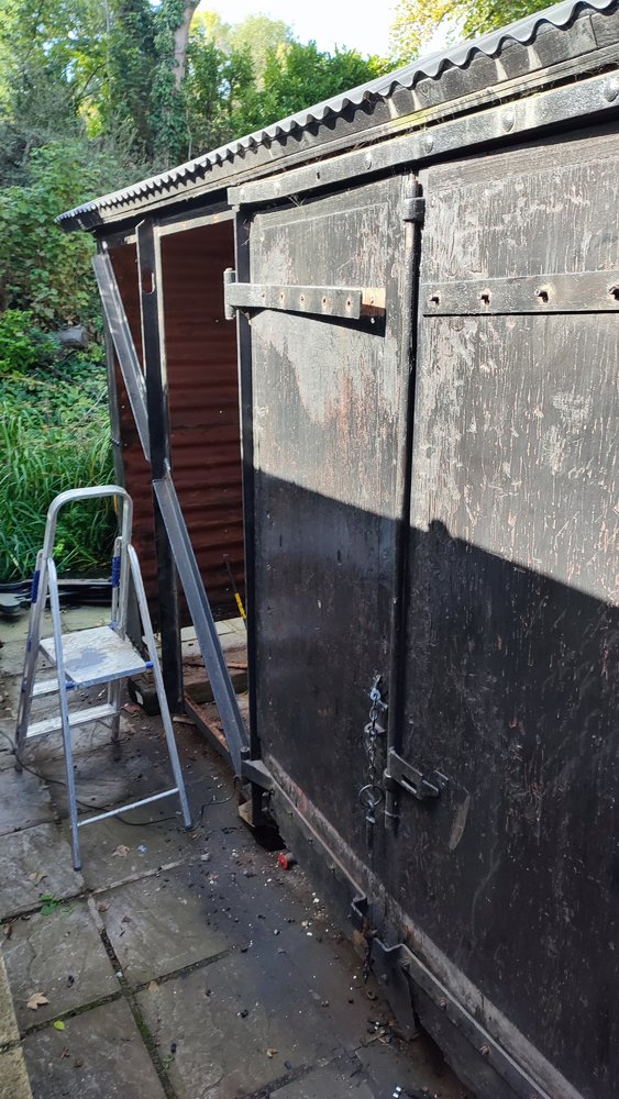

have a little space between the foam and the wood as it will sweat
if you want to space it right use use some d bead plastic and space it out a little its cheap in 5m lengths
this will allow a little air flow in the hut and if you have it ported out at top it will be fine same with if you have it the same on the rear side it will allow it to breath
this is your choice if you want to use it or not
