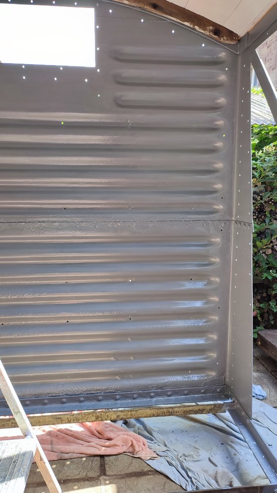

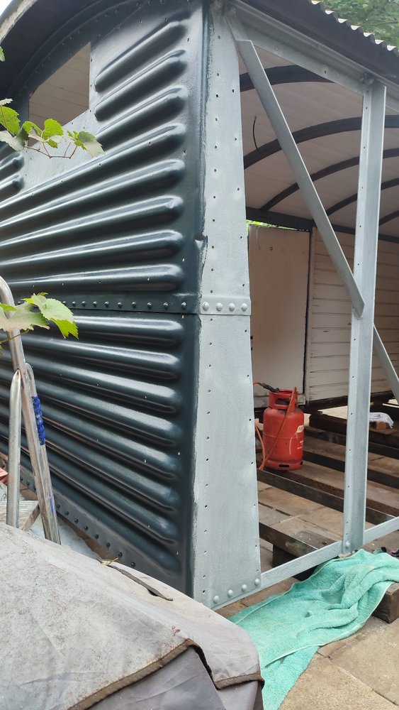

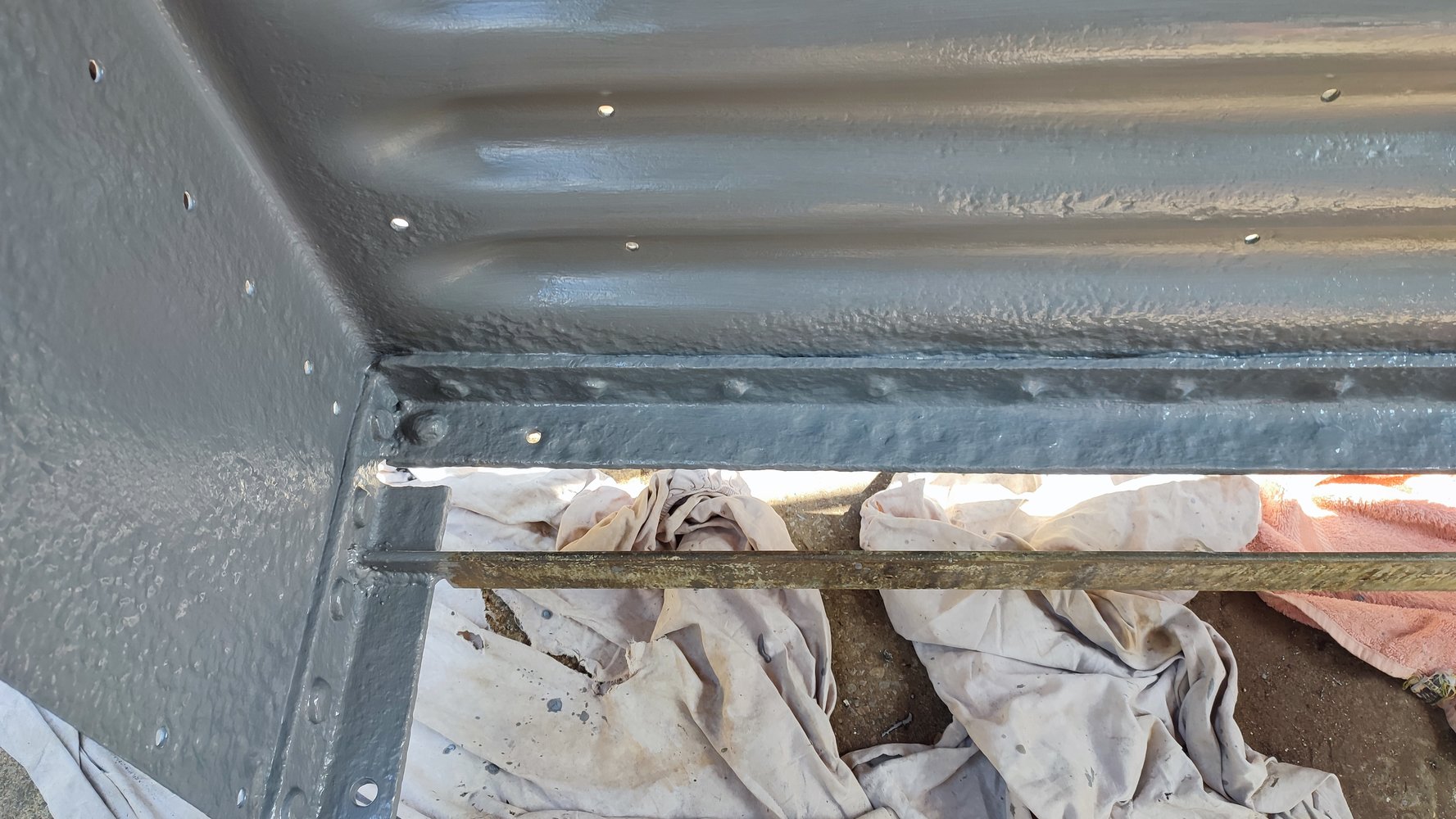

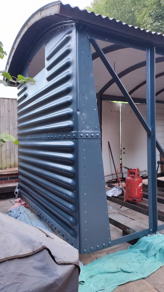

leaving one spare either fit with an external plugI'll finish the jotamastic tomorrow morning, then take a break.
Thanks.Don't take too long a break or you will have to flat it to get good adhesion with the next coat.
Unless, of course, you do want to sand it in which take a week off as it will sand much nicer when it is fully hard.
If the Jotamastic "balls" on the sand paper it is not cured enough.
Very nice job by the way.
Ended up deciding on topcoat HB. The Jotun range is very confusing.
I bought this paint from SML, got to say, very impressed. Superb packaging, and, get this, a decent weight chart, which agrees to the calculations I made.
