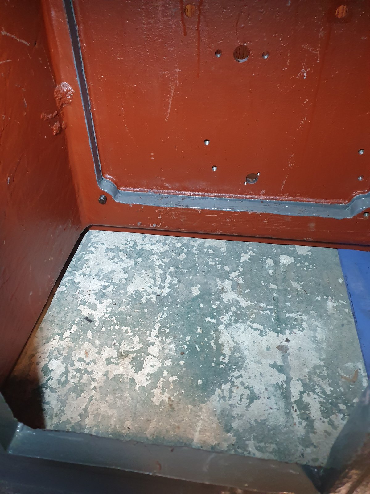

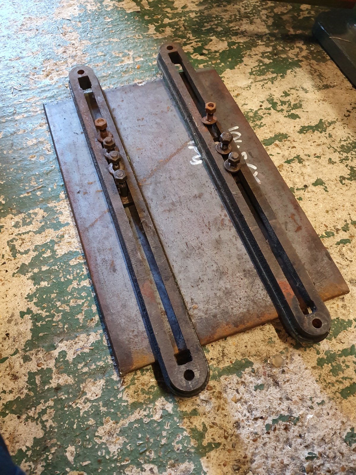

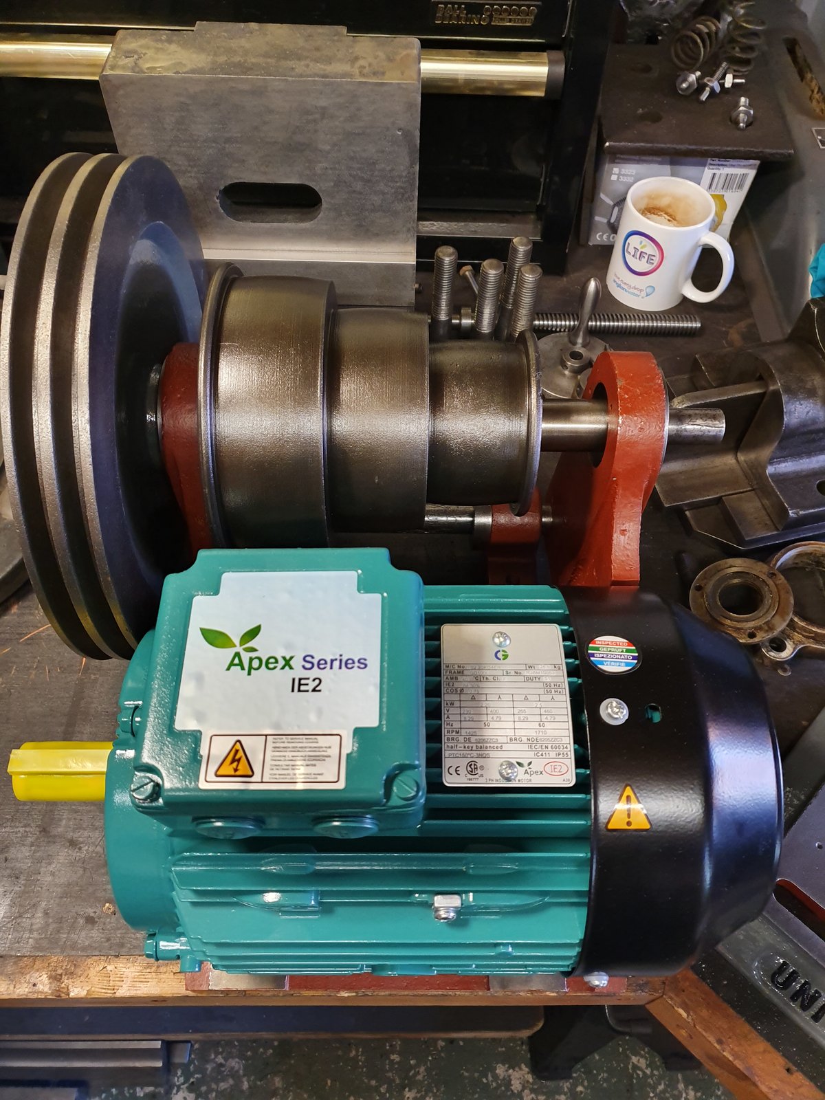

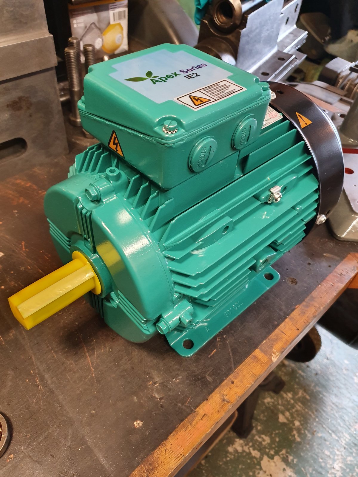

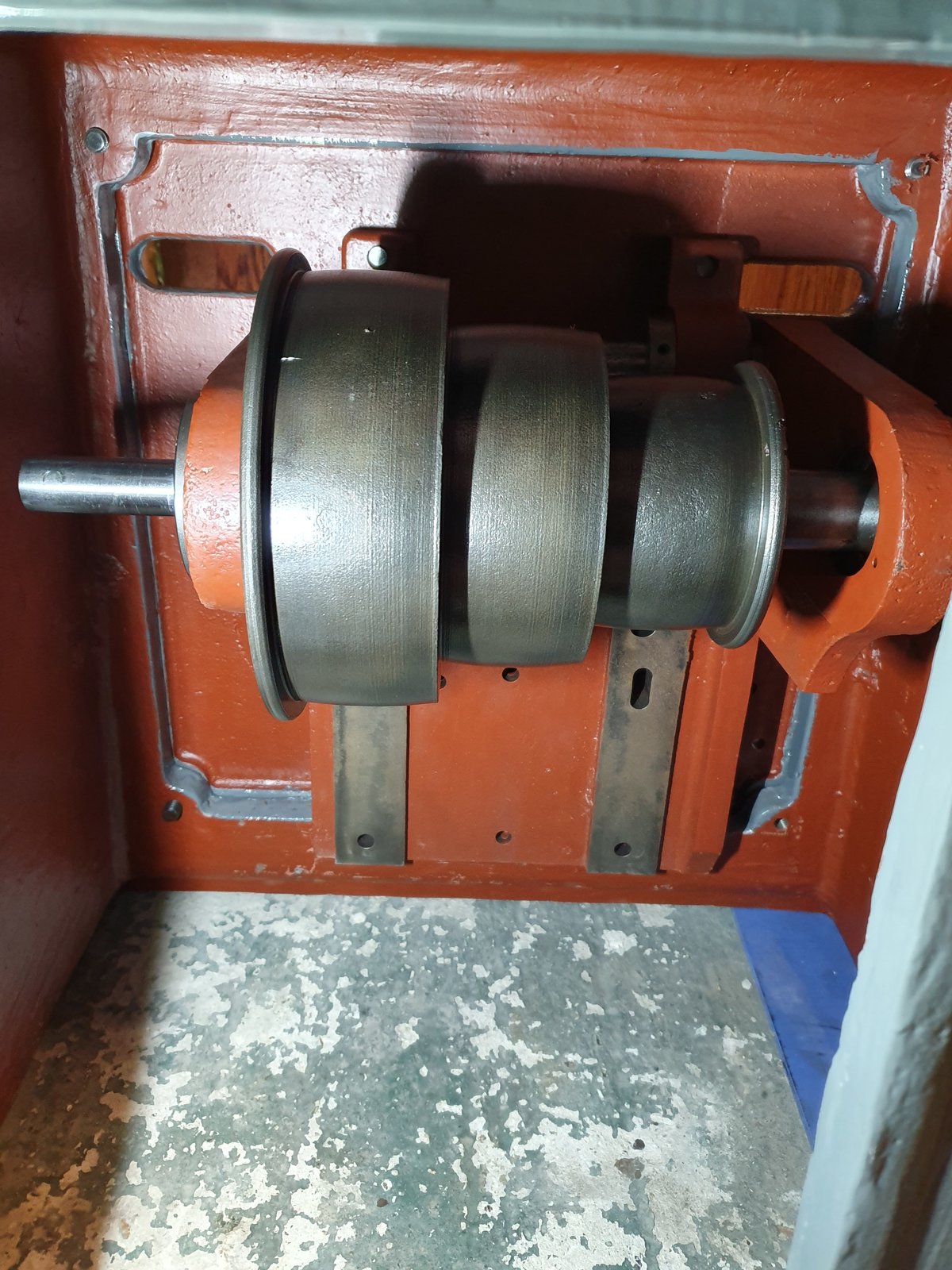

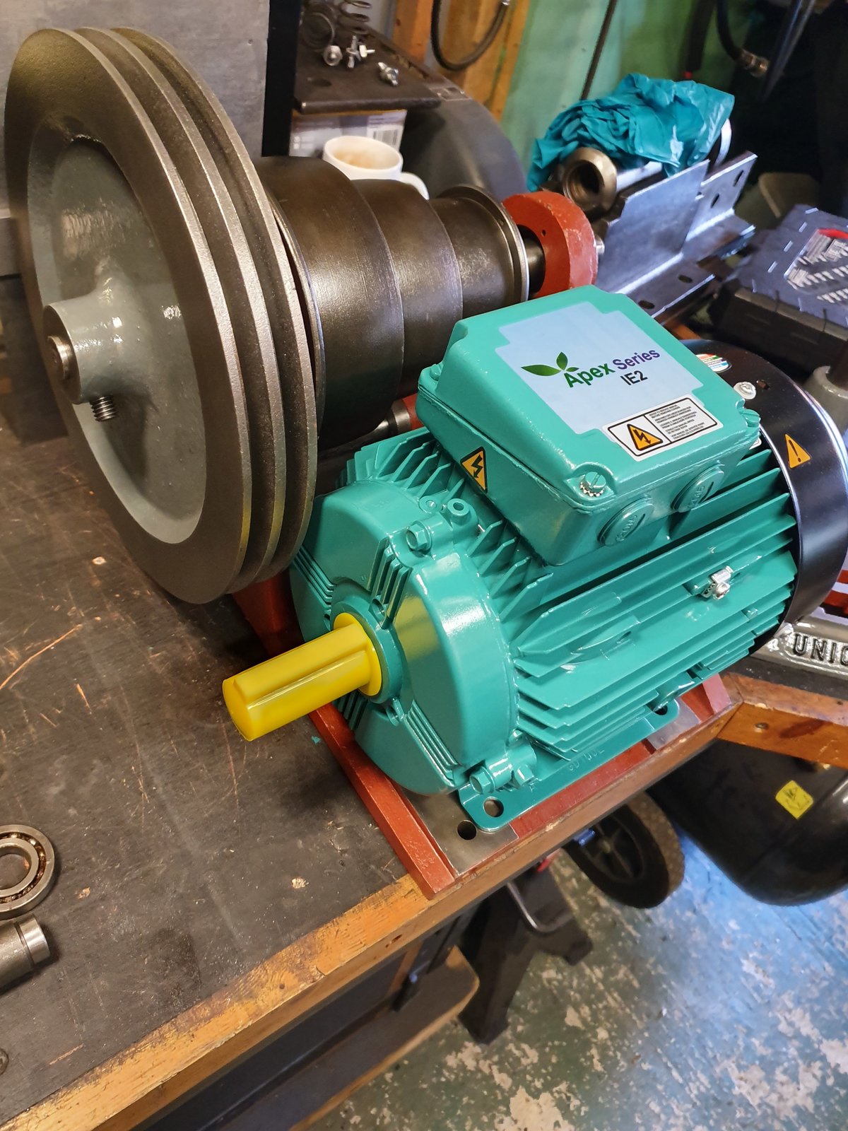

Yes .I did look at that. I think my best bet is to fabricate a new stand for the motor to sit on. This will make it easier to install and remove .The original set up is the motor and all the other parts are bolted and hinged off the back panel. Its impossible to lift it.You can move the foot on that motor so the connection block is at the front, not on top. Probably still not enough room I guess?
Yer the Harrison motor is a monster .I had the task of moving it the other day...I was looking at that motor thinking that's absurdly small for this size of machine.
But then I realised I was thinking of the Harrison.![]()
Yes. I have had a good look and found a slab of 20mm. Plus some heavy motor adjustment brackets that I can cut and shut shorter.5mm plate would do but it might be a bit noisy.
Looking at the pic above I see there are two holes in the bottom edge of the cast iron backplate. I would be tempted to bolt the motor plate up to those holes, perhaps with a rubber bush or hinge block to allow adjustment. That will sit the motor foot very close to the floor to allow space for the junction box.
