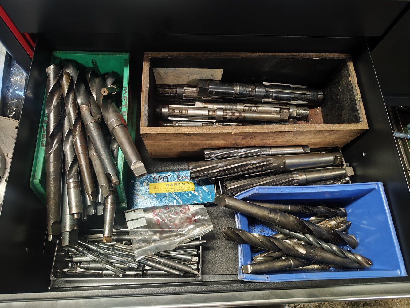

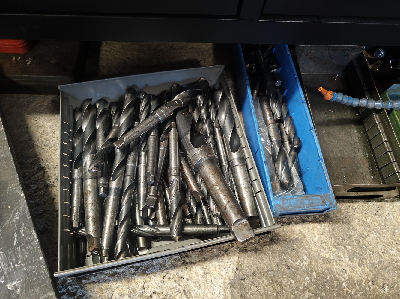

I have LOADS of blunt/tip-damaged Morse taper drill bits which I acquired through various auctions/FB marketplace over the last few years.
Here is a small selection

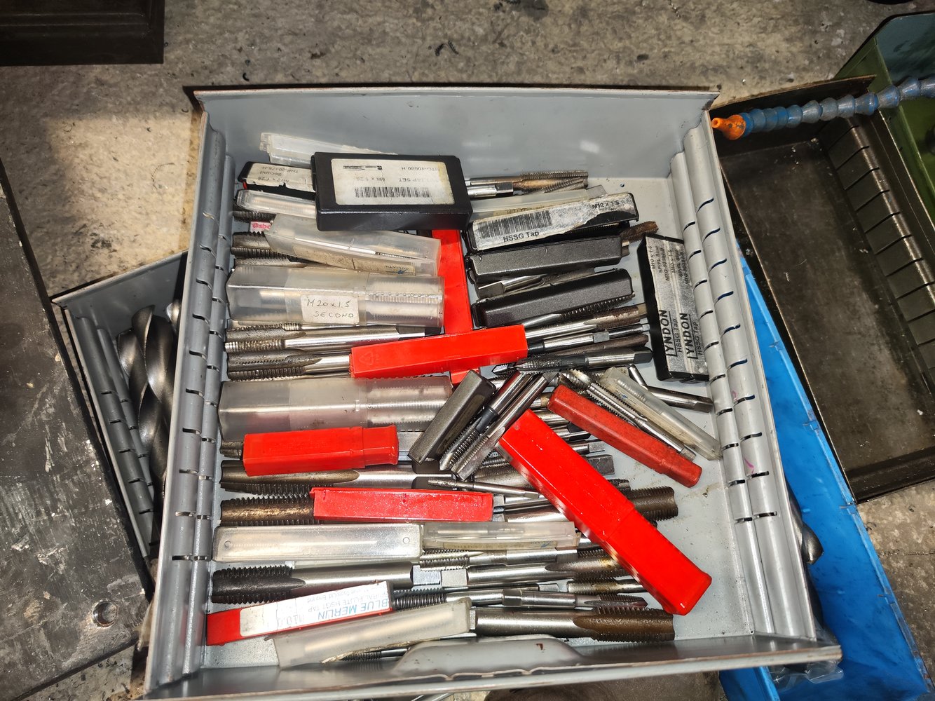

I also have a fairly expansive tap selection and I am certain there will be some blunt ones mixed in between the good ones.

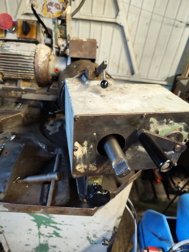

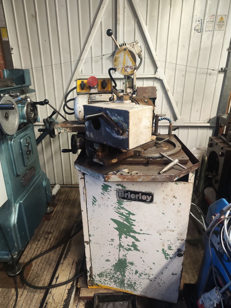

The Brierley ZB50 when I got it home in 2023.
The Brierley back home in 2024

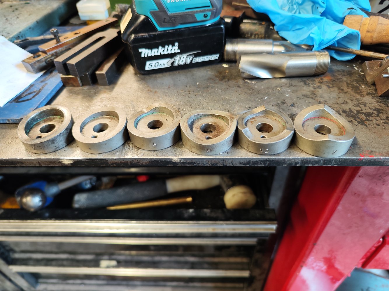

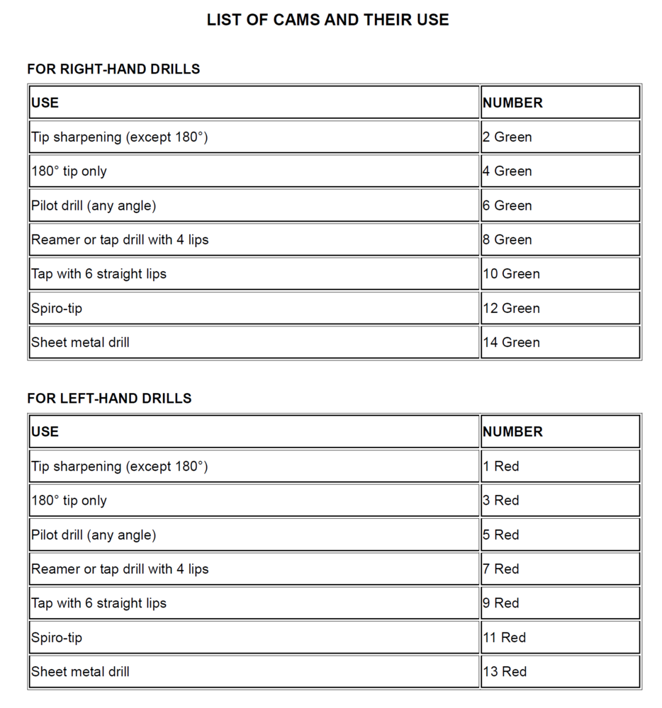

My Brierley ZB50 came with a few cams.
2, 4, 6, 8 and 10 green cams.
7 red cam.
The cams' uses are listed below.

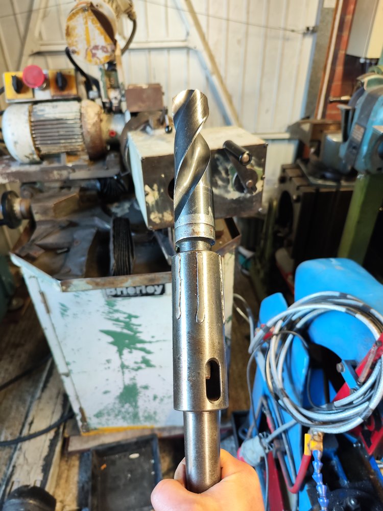

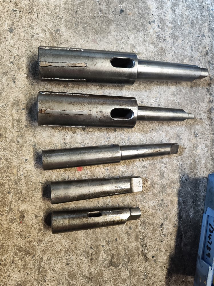

The original drill steady for round shank drill bits.
Modified Morse Taper adapters (welded on the outside to increase OD) to hold MT drill bits and a few MT sleeves.

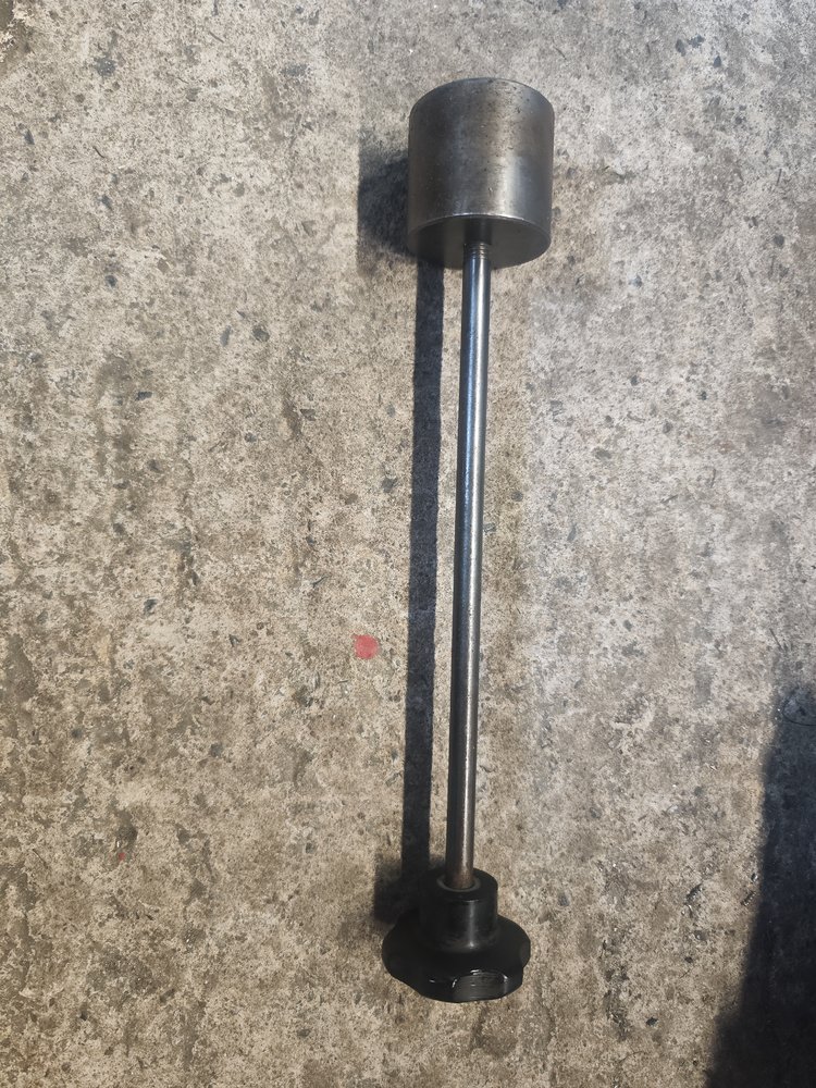

The Brierley also came with a few accessories.
