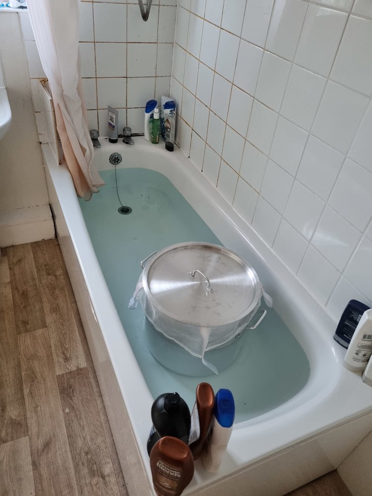

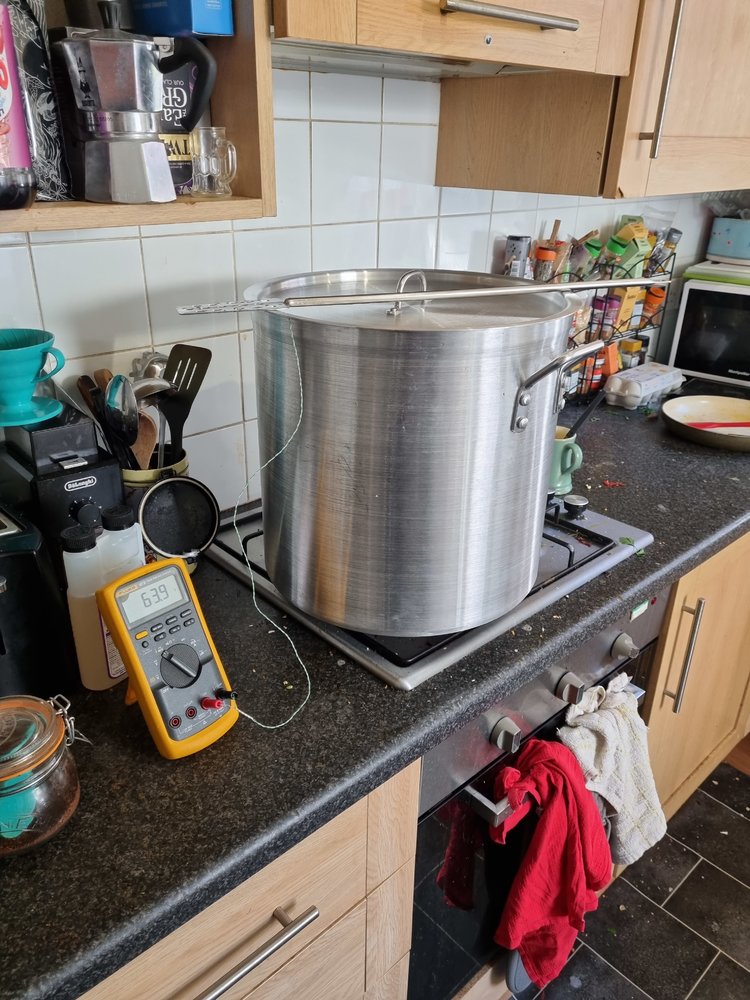

Only 13 litres of water this time, in a big muslin bag and much closer to the right temperature, 66 degrees, aiming for 65. This recipe mashes out at 75 degrees with an out time of 10 minutes, I assume that means after an hour, start heating again, then leave it at 75 for a further ten minutes before sparging.

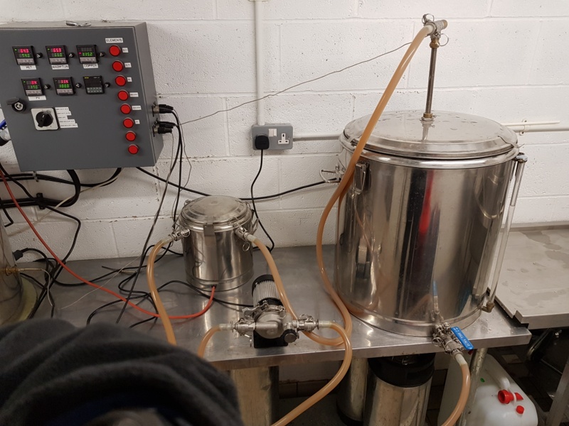

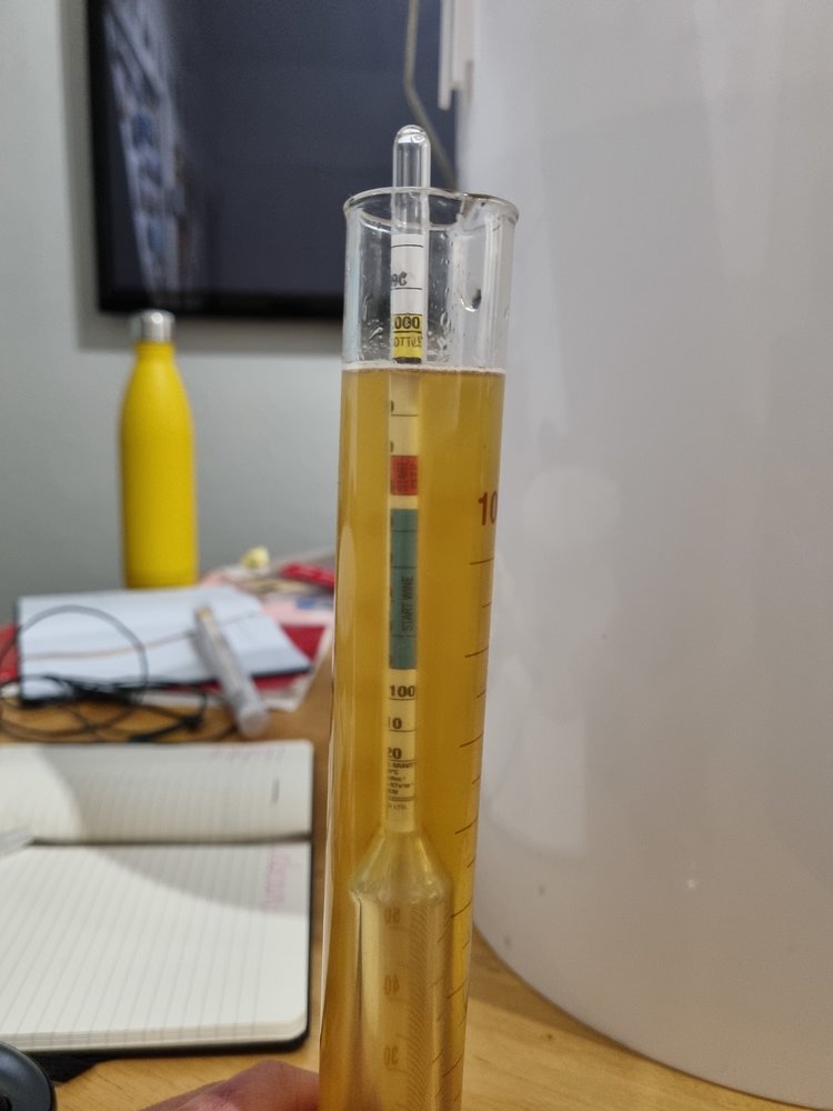

Came out 20.something litres (forgot to weigh the empty fermenter) at 1.064, was aiming for 19 litres at 1.066 so I'm pretty pleased with that. Hopefully come out around 7.1% ABV.Weird coincidence; I watched The Friends episode where they mention drinking Boddingtons in London just a few days ago, I did wonder if it was a real thing.I've been doing all grain brews since February, working on a HERMS mash system at the moment using my 20L boiler as HLT, 30L boiler for the wort to go into. Ferment it out and serve with this...
I made mine from a length of 8mm copper tube coiled around a handy round thing with a bit of garden hose stuck on each end.Really should look at immersion chillers
he hop stopper in the copper, when pumping out of the copper through the plater heat exchanger into the fermenter, this and the hop bed act as a filter and catch most of the trub.
