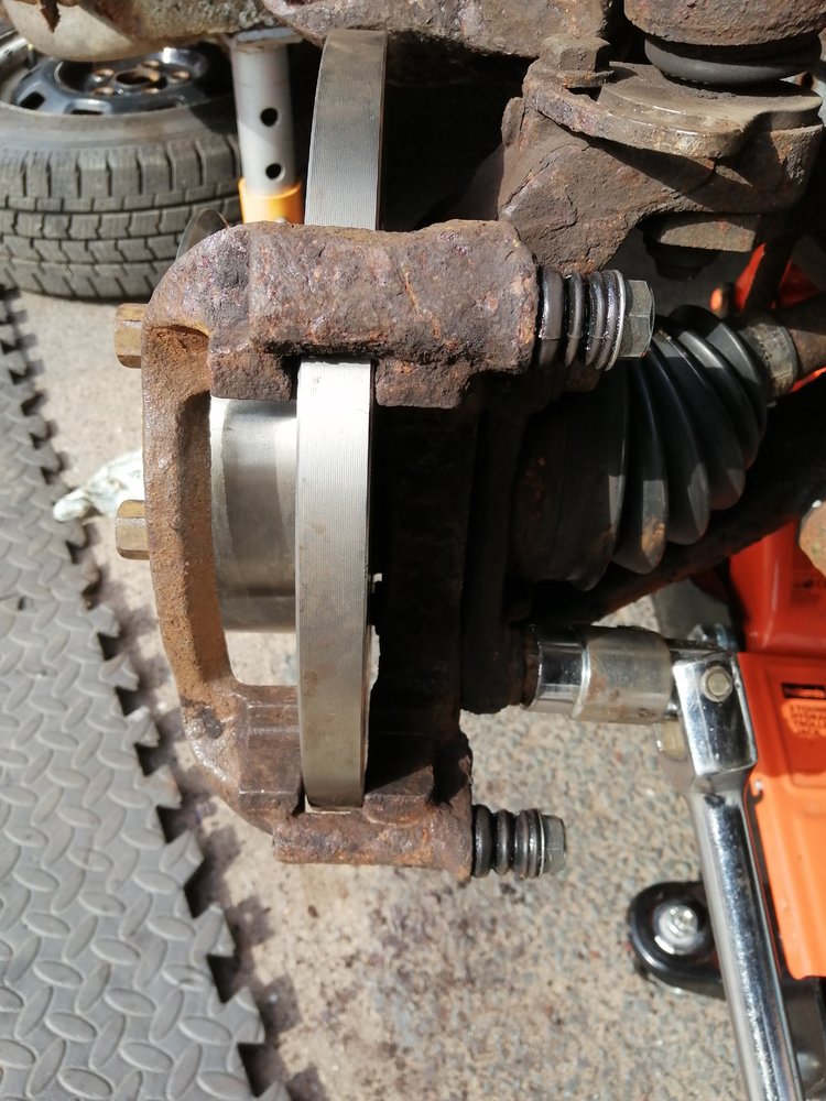

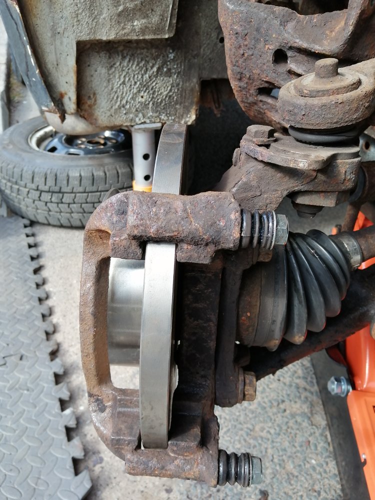

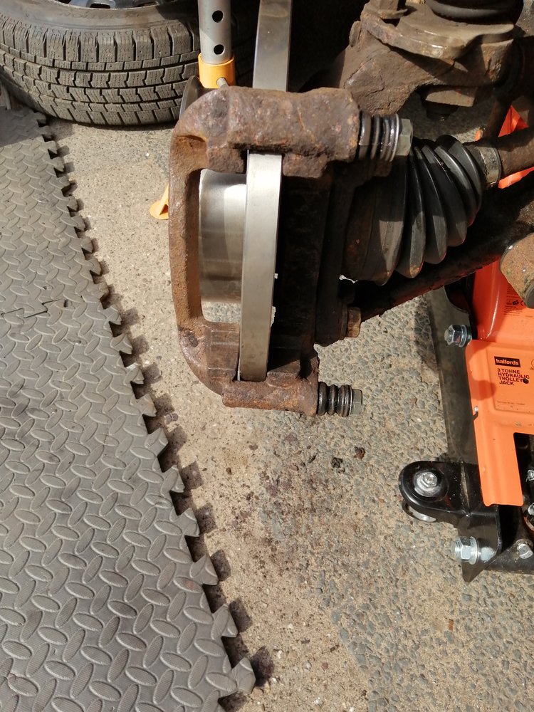

try cracking off the bleed nipple, if the wheel then turns there is pressure in the brake pipes/hoses which maybe the hose has collapsed internally
This would be the first thing on the list after a clean up, has proven to be the problem on more than one occasion on our trucks.
