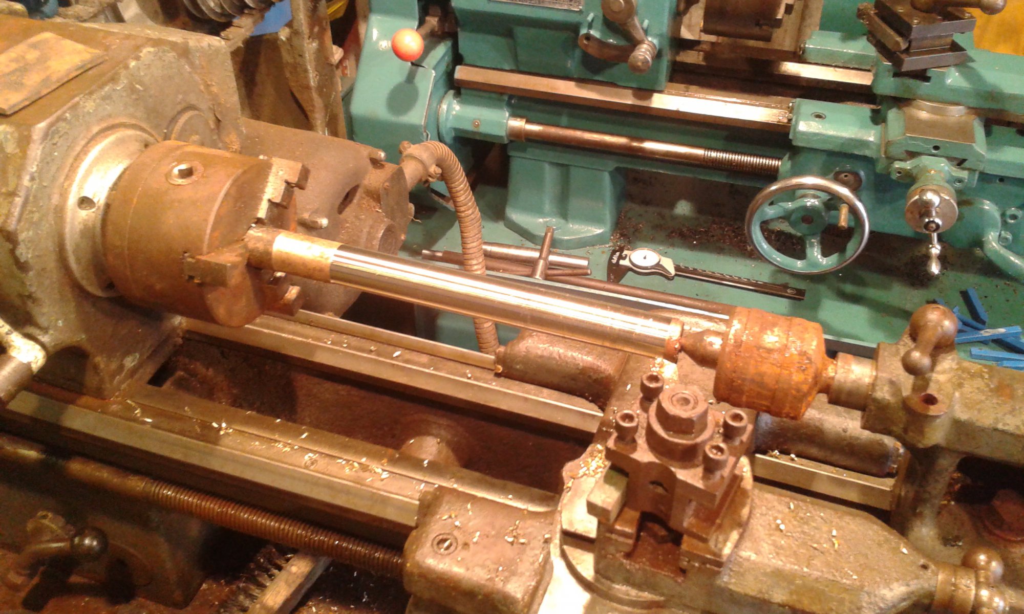

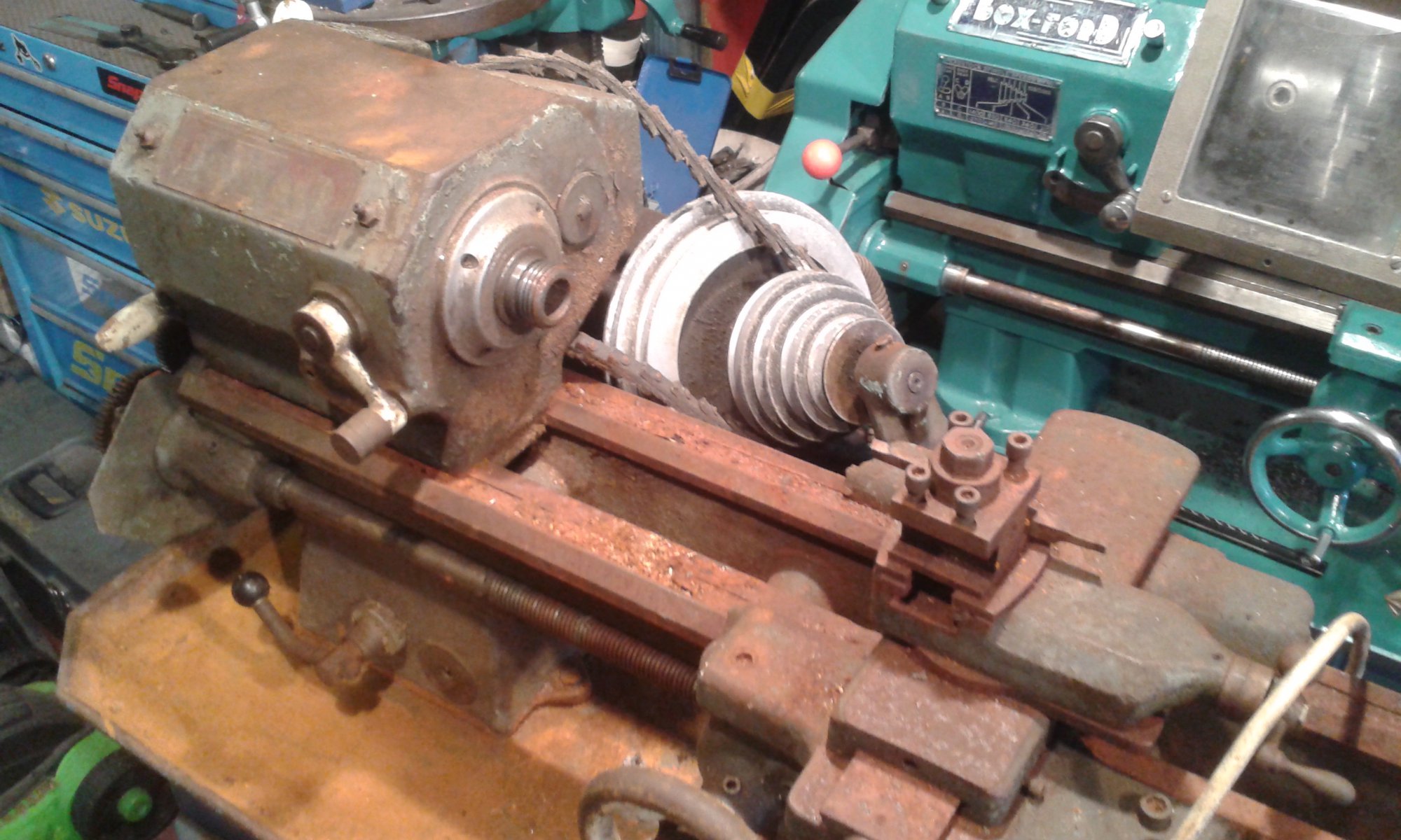

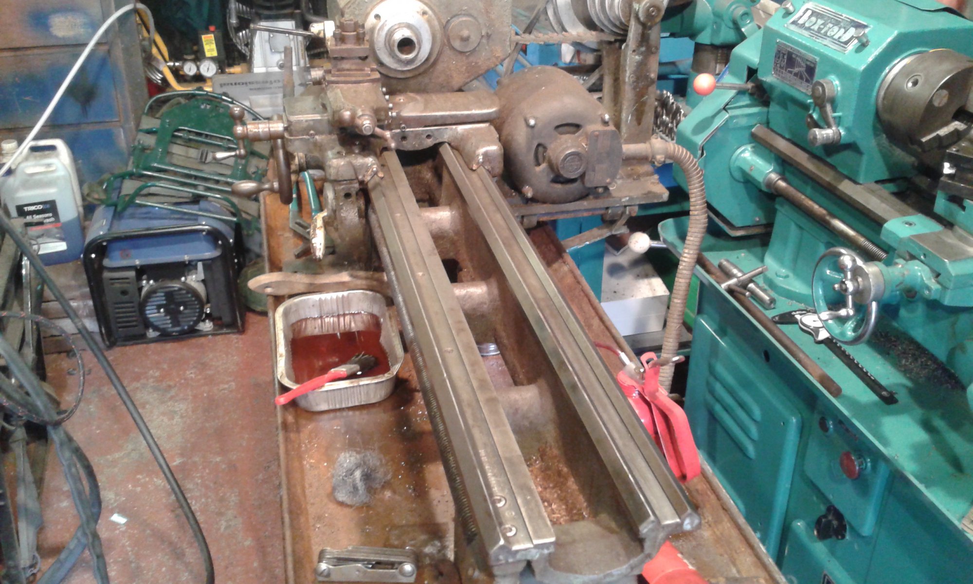

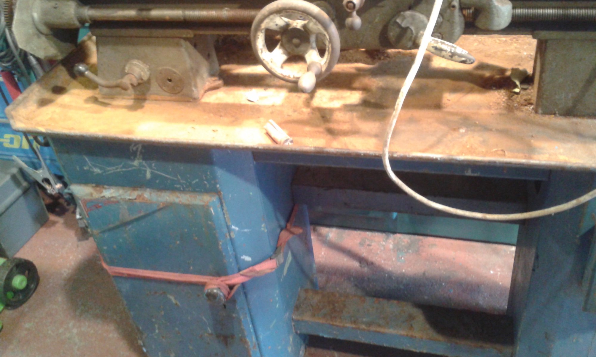

It will work, it's just not a good idea as if the switch is used while the motor is running there's a definite risk of mischief being done to the power output components in the VFD.incidentally the vfd has had no problem running the hacksaw which has a start and auto shut off switch.

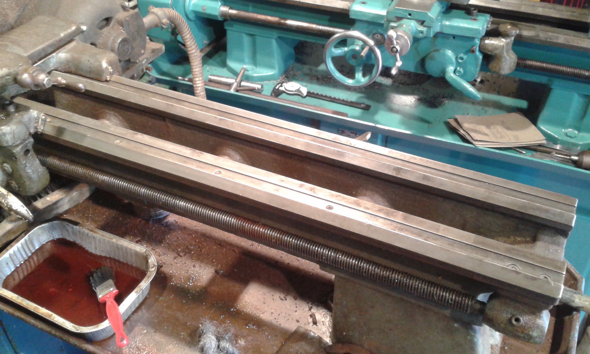

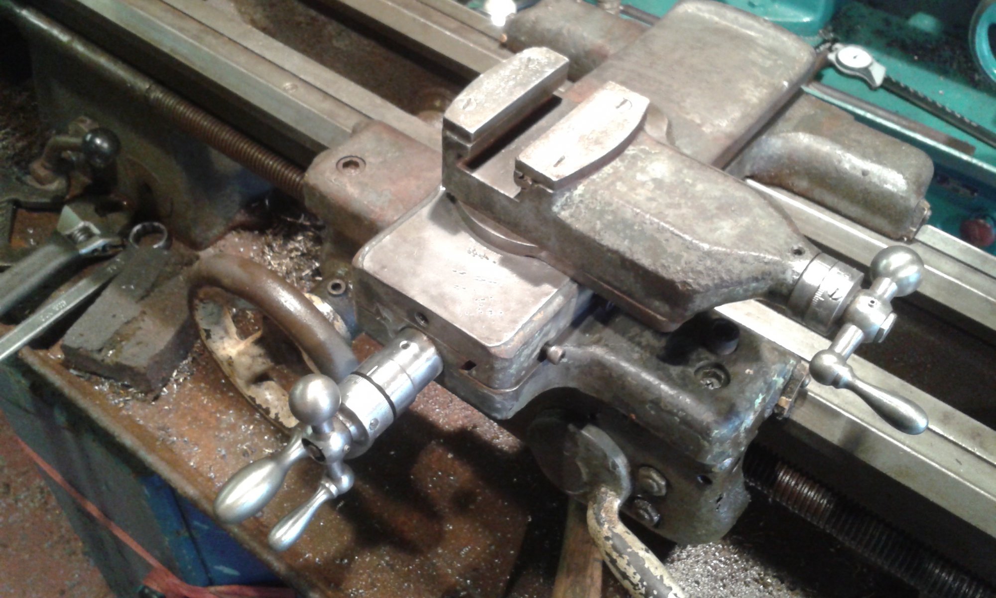

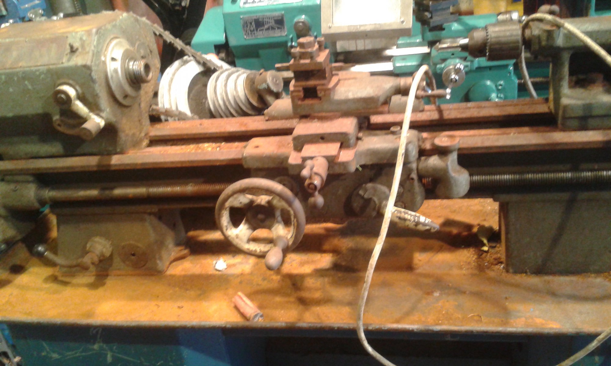

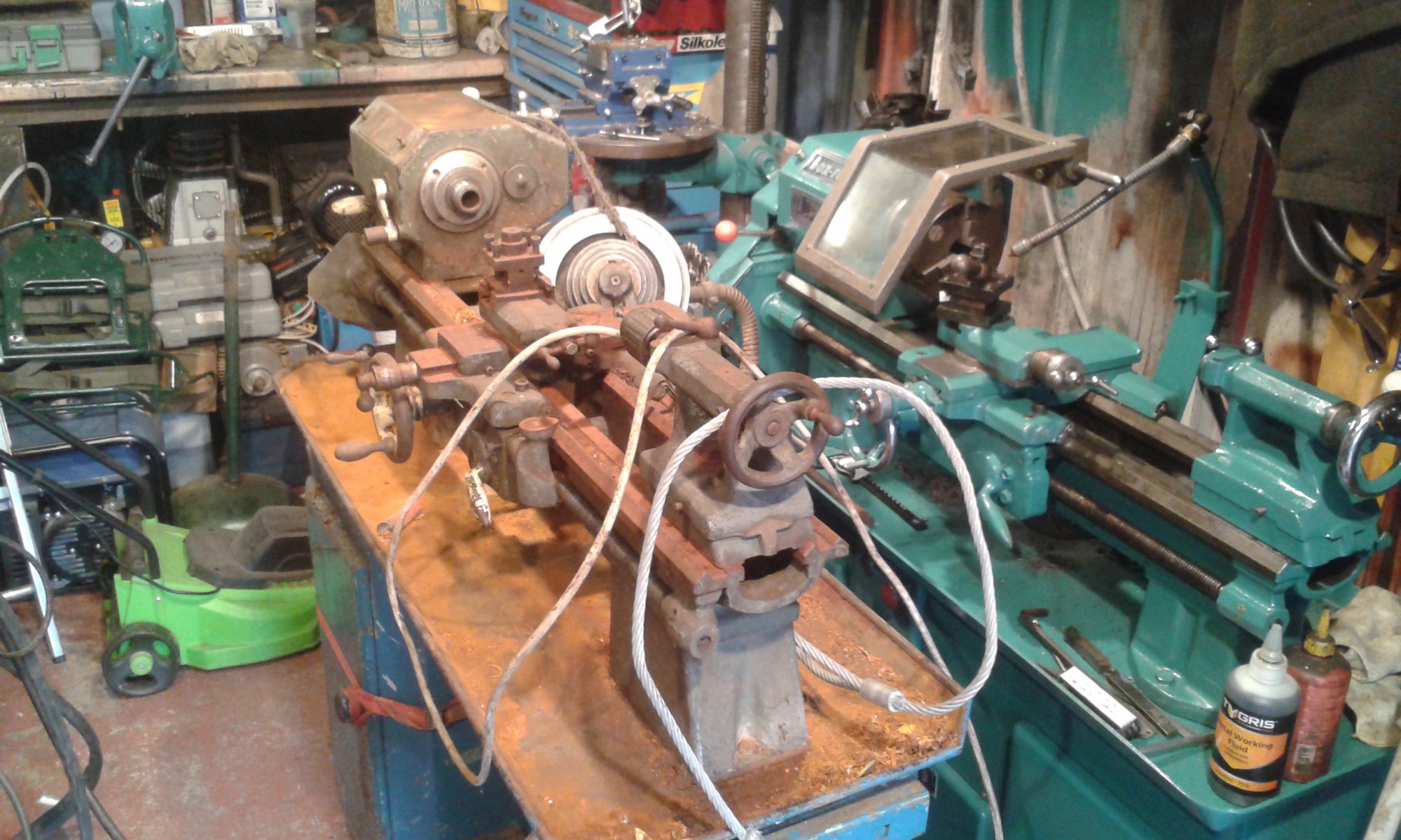

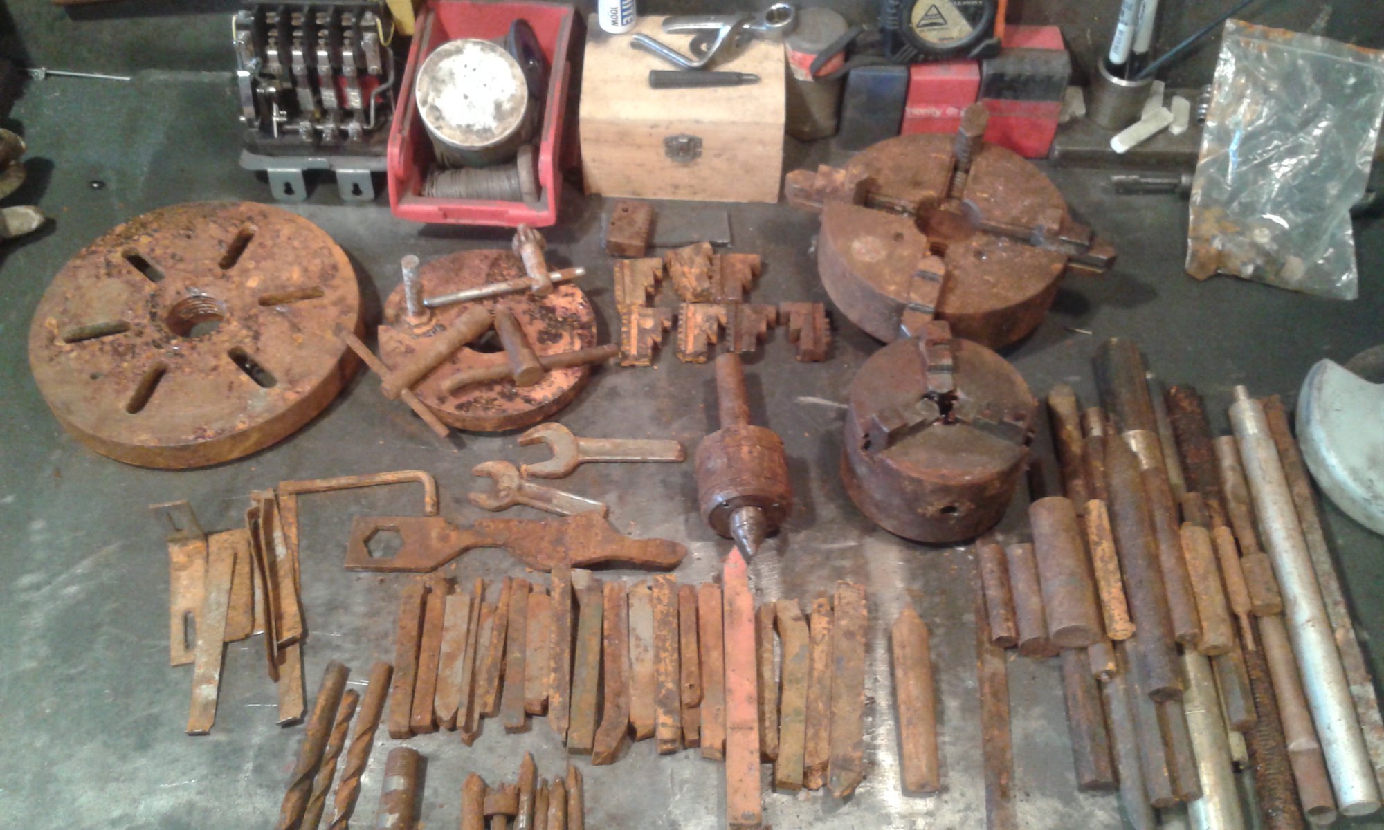

the chap that owned it had it stored in a shed at the bottom of the garden, unfortunately the roof had leaked directly over the lathe. his son repaired the roof but neglected to dry out the shed contents
