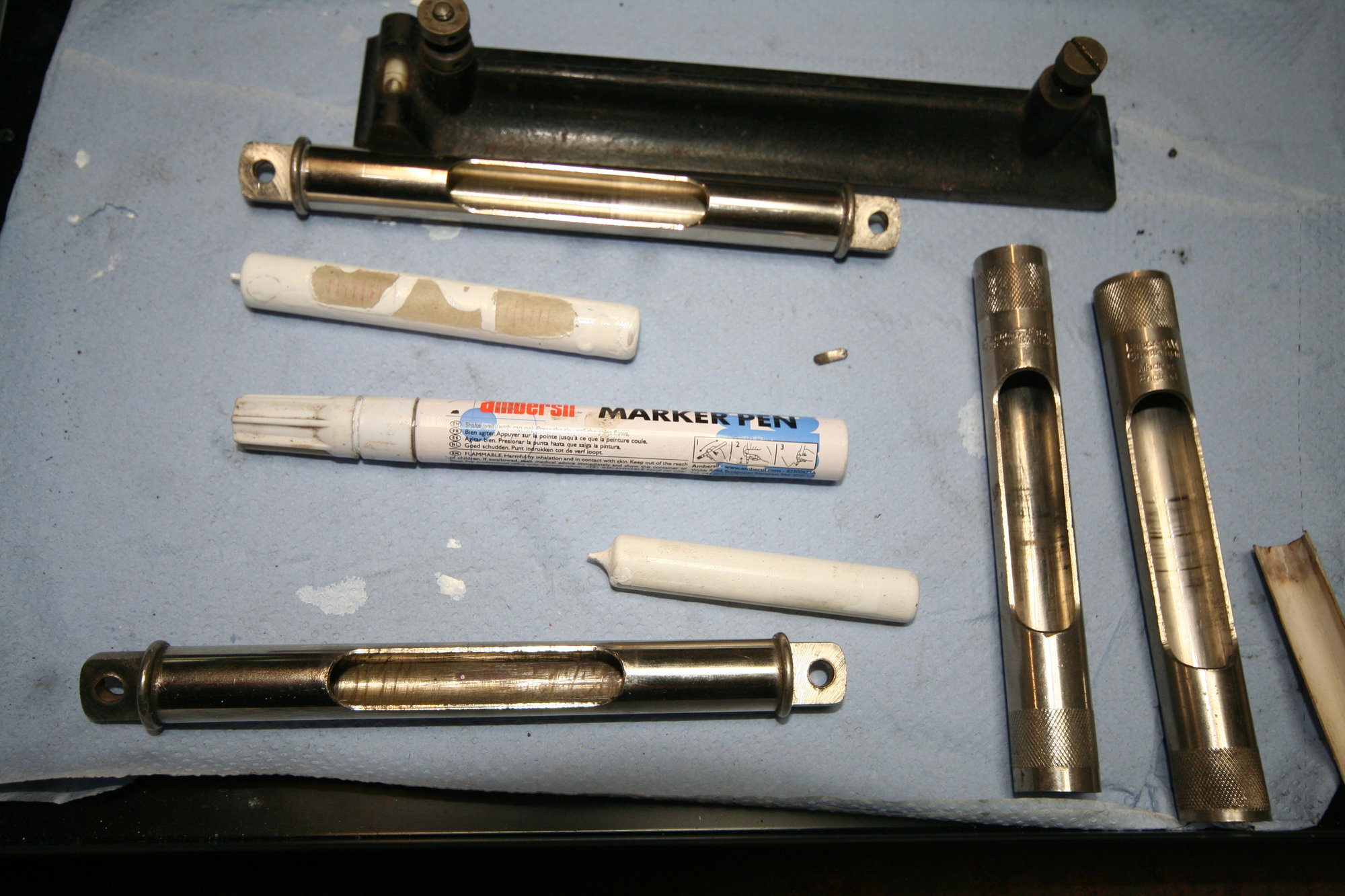

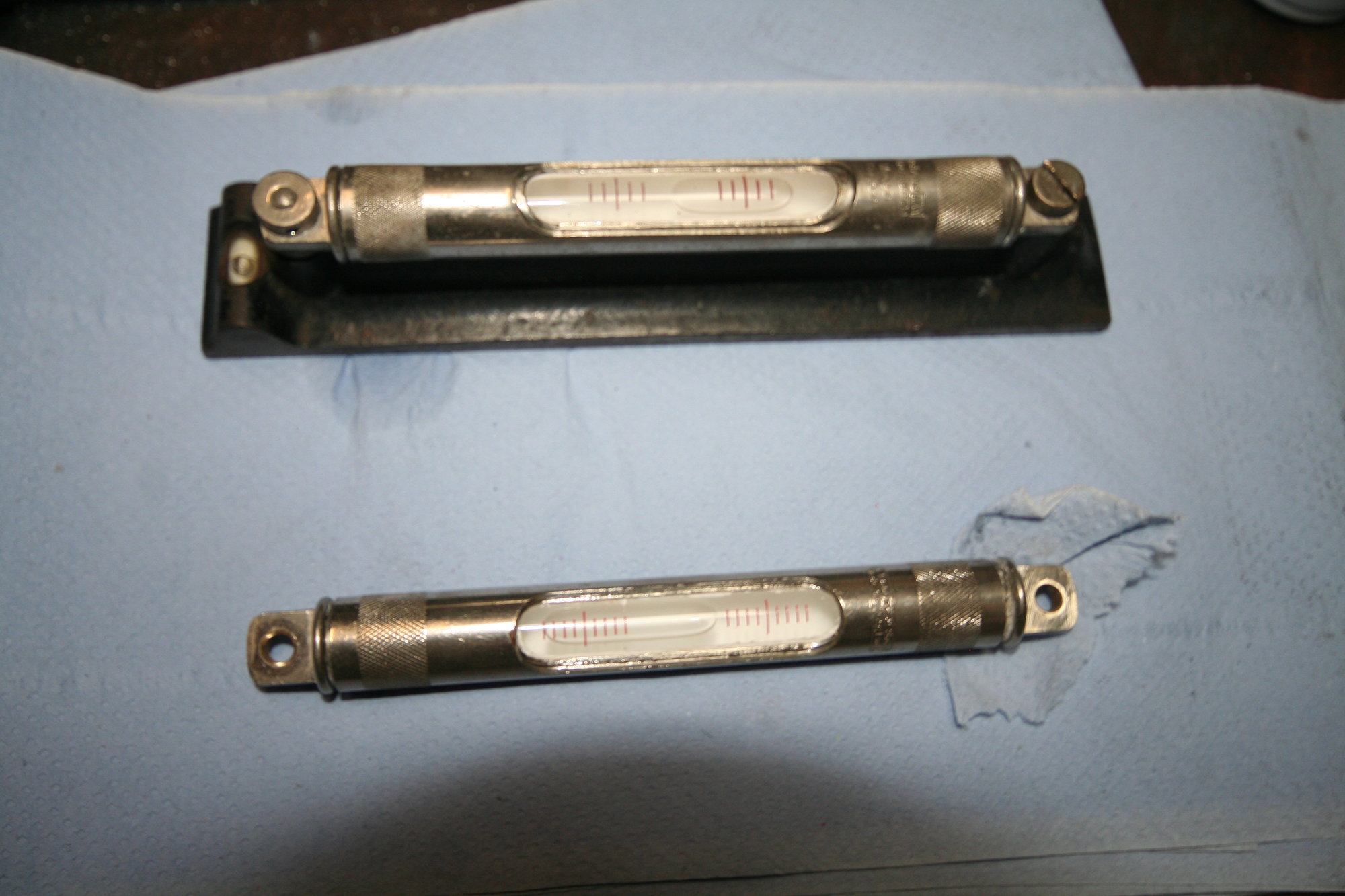

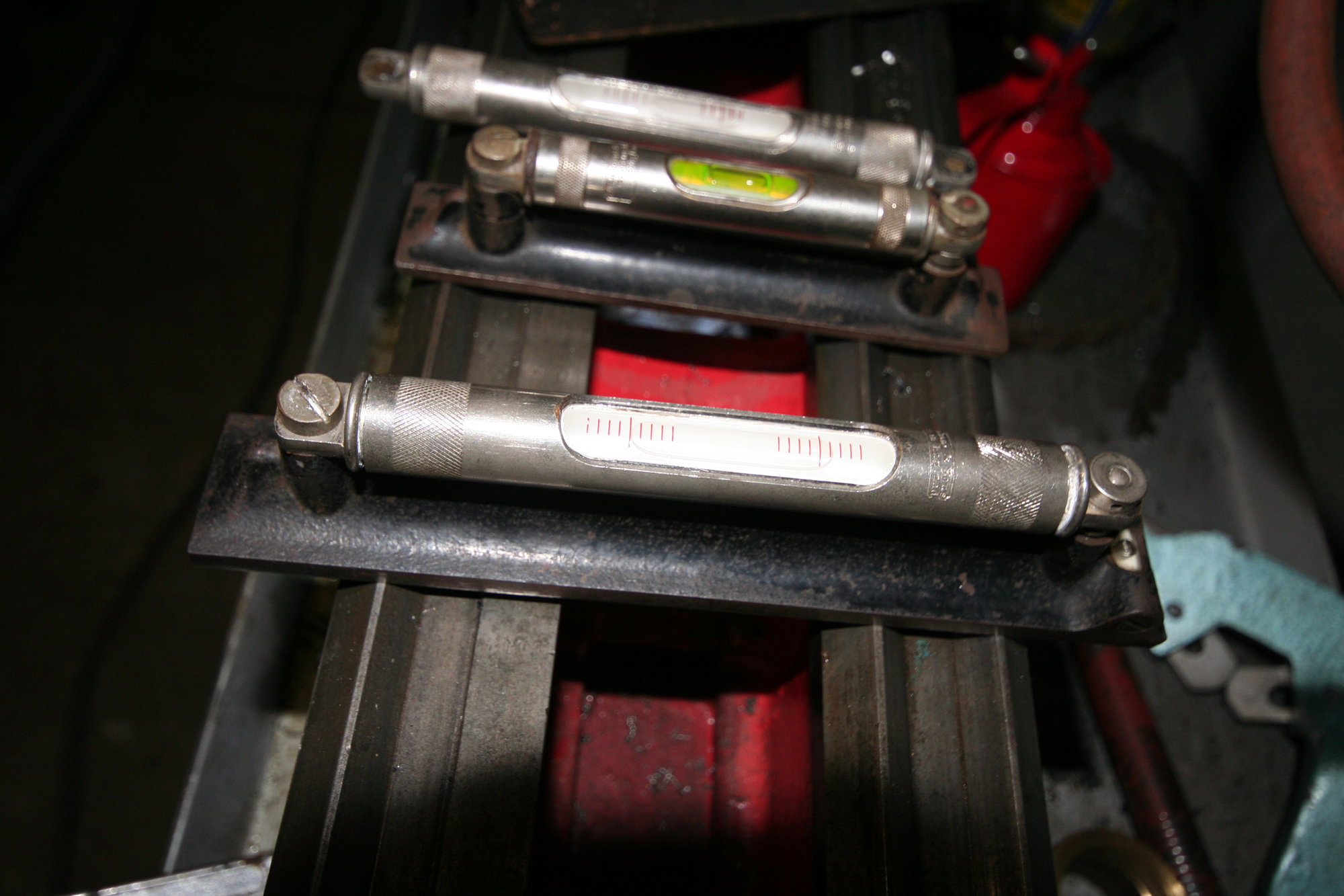

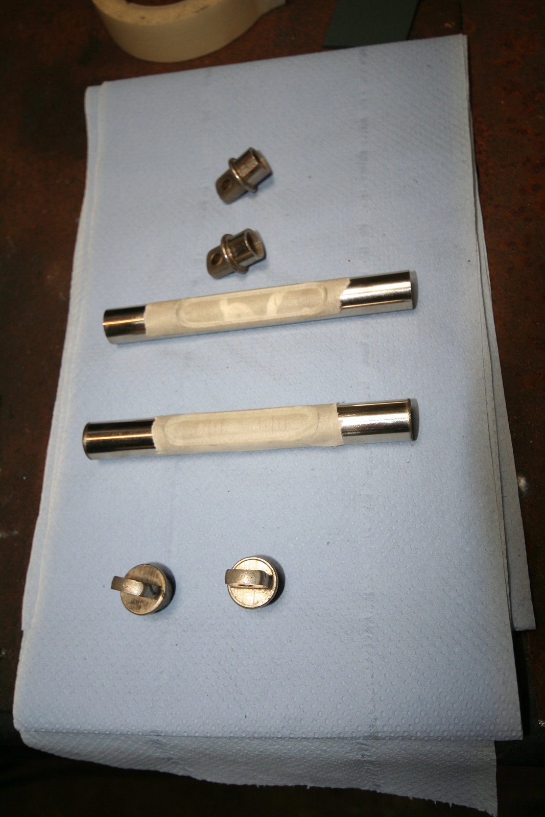

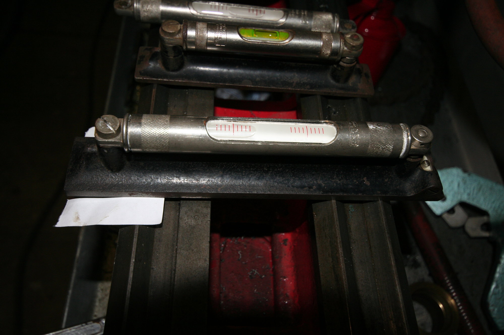

The vial I sent is about a 20 or 30 arc second vial I think. That import one is probably 5 or 10 arc seconds so much more sensitive.
Try putting your Chinese level on the lathe bed then walk around to the other side. It might register the bend in the slab from your body weight.
