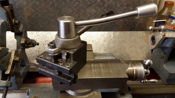

Thanks Daniel, bear with me, but am I right in saying the rdg post holds a single tool holder whereas the the Amadeal one holds 4 but they are both quick change?
I'll take a photo tomorrow of the original and the one I made.If you get a chance would you be kind enough to send me a picture of the plate please Graham. Just need an idea of what's involved.
It is. UT - if you have to buy tool holders for them you need a rather large bank balance. Also, if you need spares for one, as I did, they are also very dear and on a long lead time.I'm confused. The Dickson (sp?) toolpost is a quick change. Are people after the piston type so they can be more like Abom79?
That is the one I hadThat's the one I bought. Exactly the same as the offering from Arc, but as they are just around the corner I saved a bit on P&P. Regarding the bottom plate, I made a new one as the one it comes with is hardened. AS far as buying some extra holders, I'm quite happy to share a batch, but I won't be doing anything until the New Year. I'll make a note to check out prices and PM you when I know. Graham

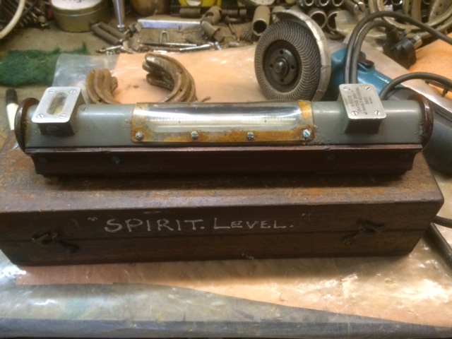

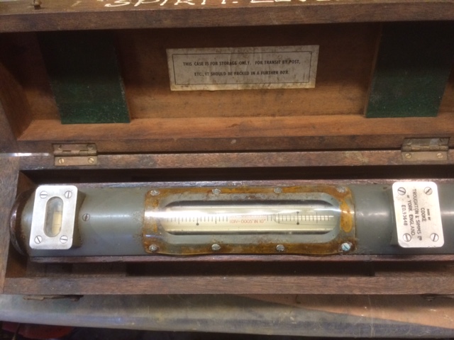

So while having a lathe perfectly level may not in itself be of any consequence, having it level is part of the process for dialling out any distortions.
It's not. A piece of rod/bar and a DTI will let you know if there's any distortion when bolting down. Being level is a nicety, not a necessity.
