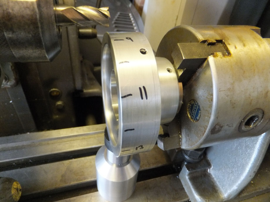

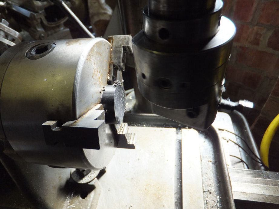

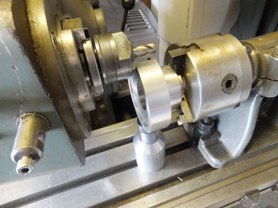

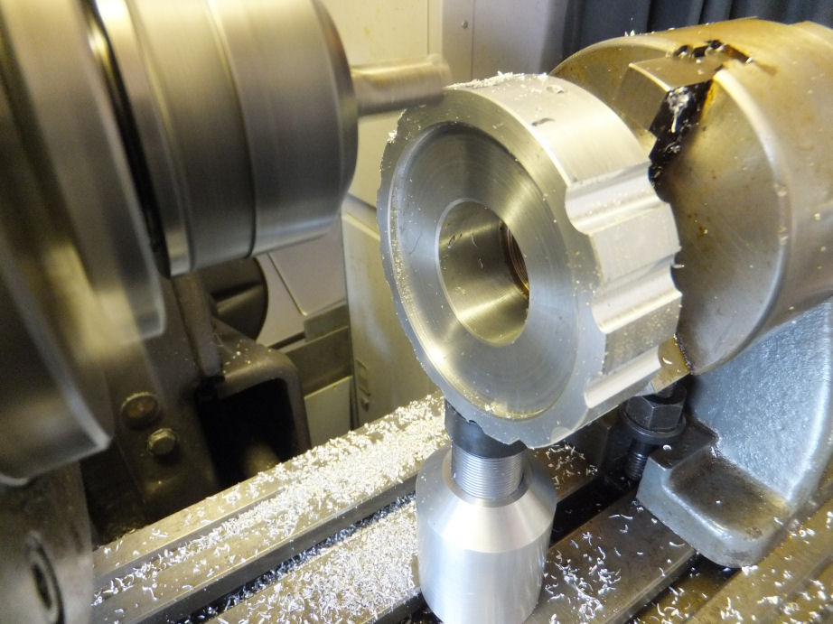

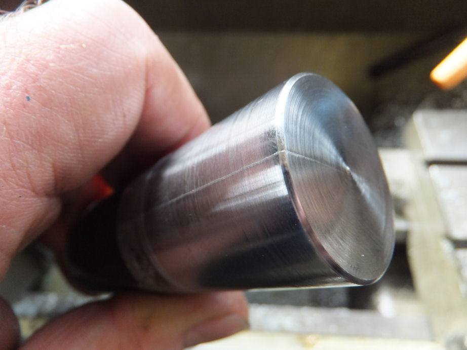

Not just that the shank is too large for my holders, I expected that and could soon mill it down, but the head is so bulky that even with the topslide wound all the way back the tool won't clear the drawtube handwheel when held in the chuck.

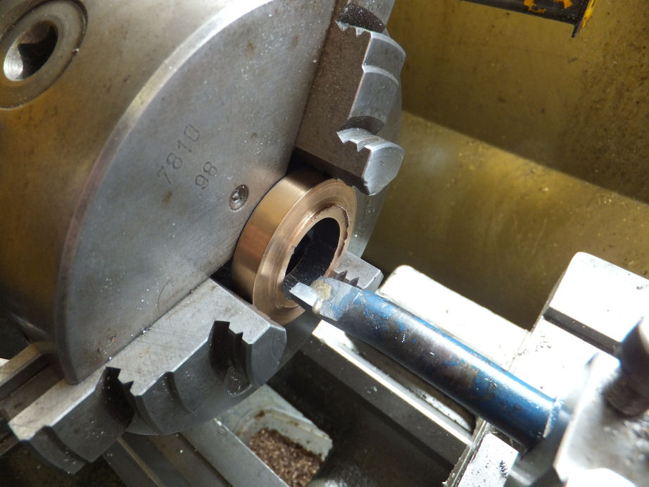

I thought I'd add that I ran the offcut of 'bronze' through the PMI at work and it came back as about 89% Cu, 7.5% Sn, 2.5% Pb and a bit of Zn... a composition which doesn't appear to exist - i.e. Unobtanium

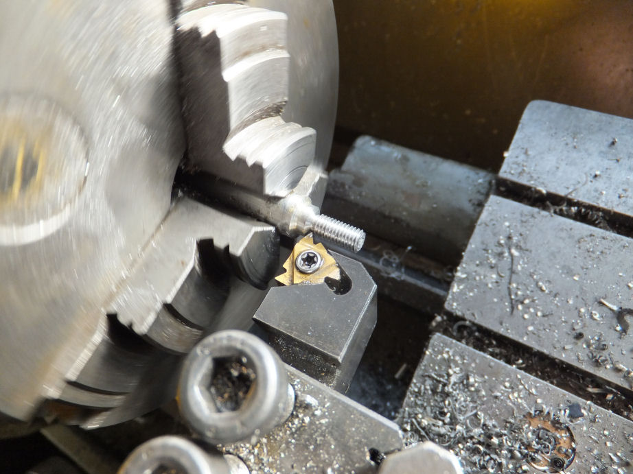

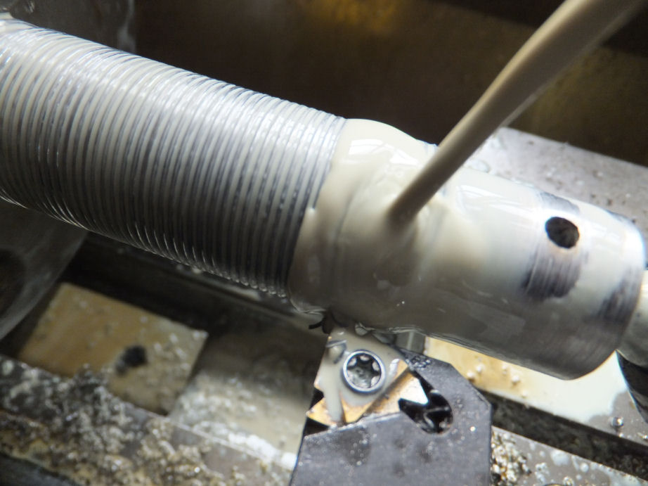

Internal threading up to a shoulder when you can't drop the halfnuts or use a carriage stop can be a bit
