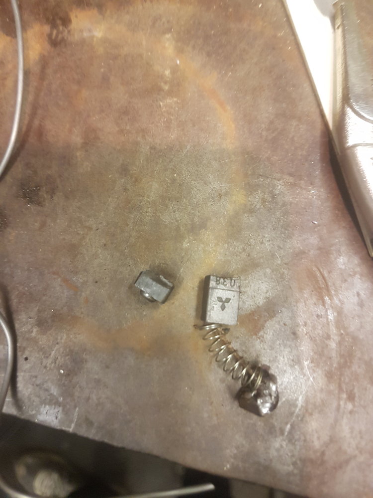

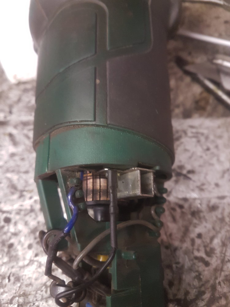

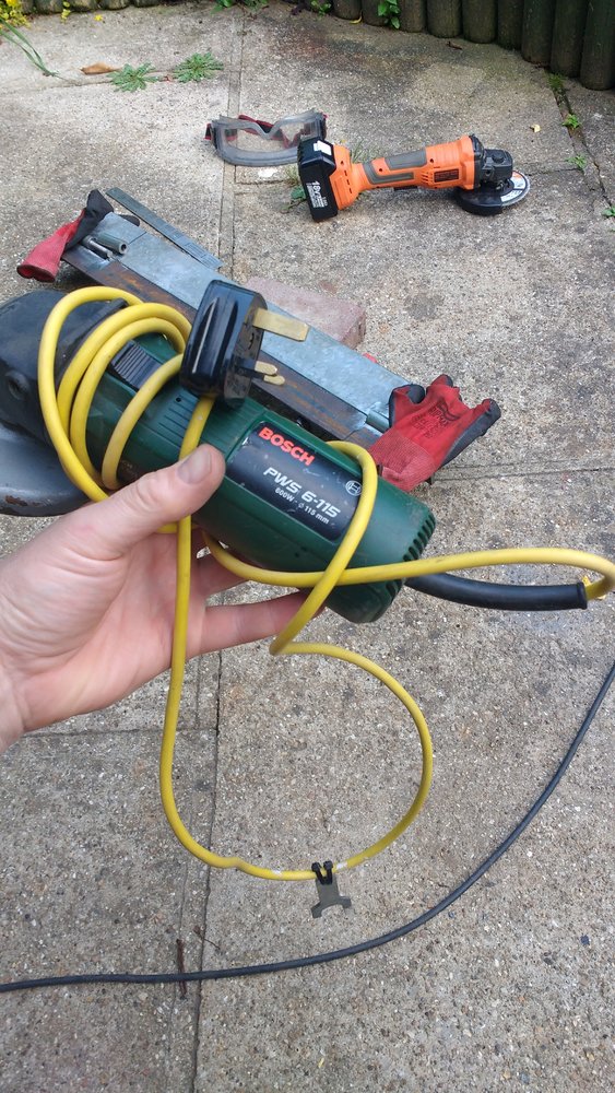

Just treated my favourite old PWS 6-115 to a new lead and some brushes:
(I know the lead's yellow!)
Yellow? Illegal!
On site, probably but at home there's a chance I might see it and not cut or trip over it!
Ooh, I don't know. A nice dark blue would go well on a Bosch!I'm with you on that. I'd choose yellow over blue just because i like it.
