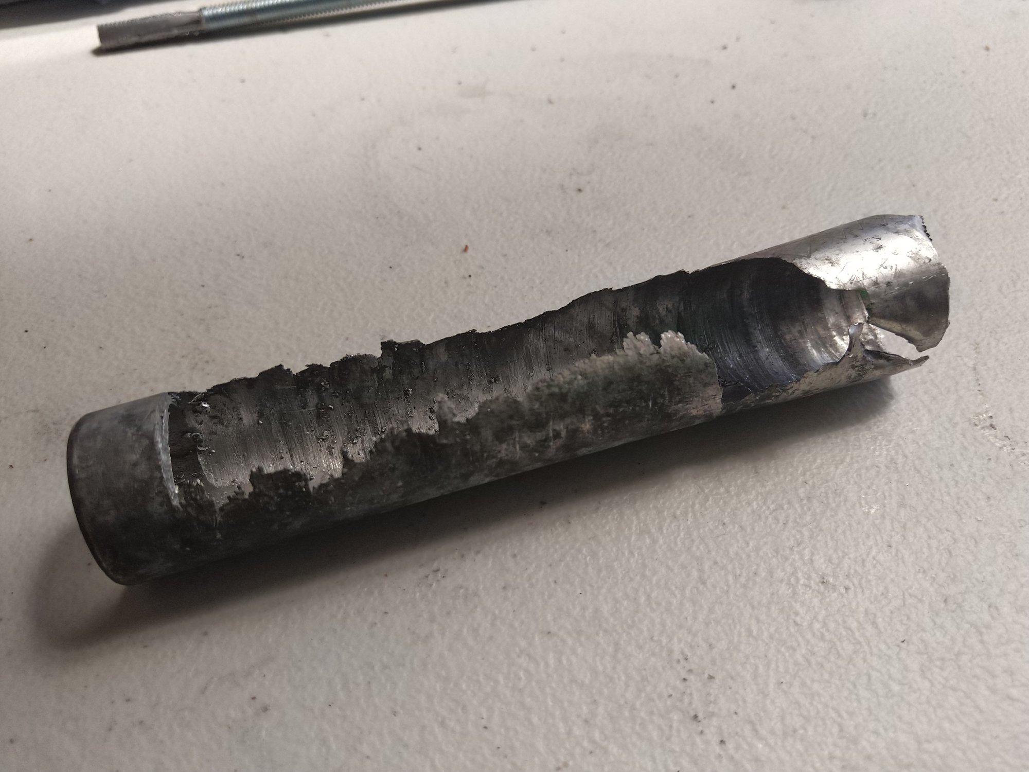

The correct tool is like an end mill but has a chamfer on the end from memory Wylcut swift make them
https://www.ukweblist.com/UK/C96B250657/Wylcut-Swift-(Cutting-Tools)-Ltd
Its a seat post reamer, The machine is basically a motor with a reduction box mounted horizontally with the cutter on a shaft about 12-18" long.
Trying to think who in the UK makes bikes on a big scale as they will have one, the use them to clean the seat tube to remove any paint scabs etc before assembly but they would cut a seat post out
