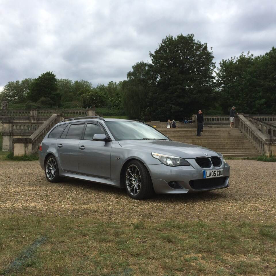

would love an e61....
Jp
Common problem on the E60/61. Mine had a new servo before I got it as it had filled up with water !
If the car has a sunroof also check the drains in the rear corners as it’ll fill your boot and flood the ecus!! Expensive!
