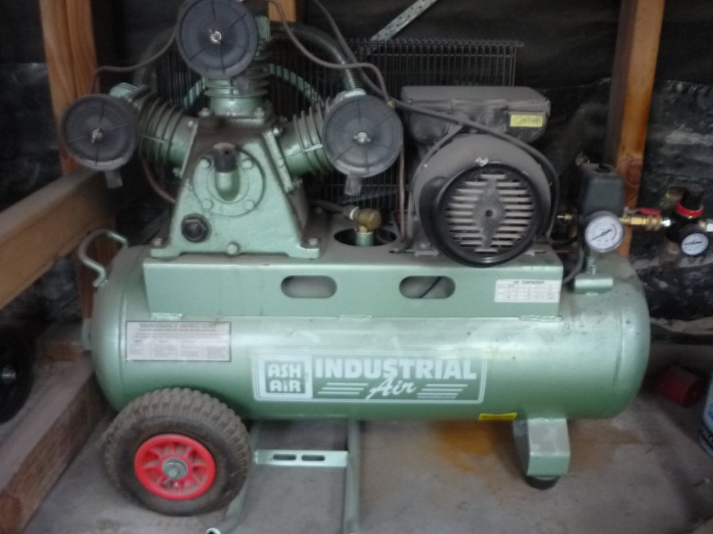

That's not too bad, I've got 30cfm to play with so it should work, I was half expecting 60cfm +It's a lot. With the smallest nozzle I could buy (1/8") and running it from a 15cfm (approx) single phase compressor I reckon you're lucky to get 50% duty time at 100 psi.

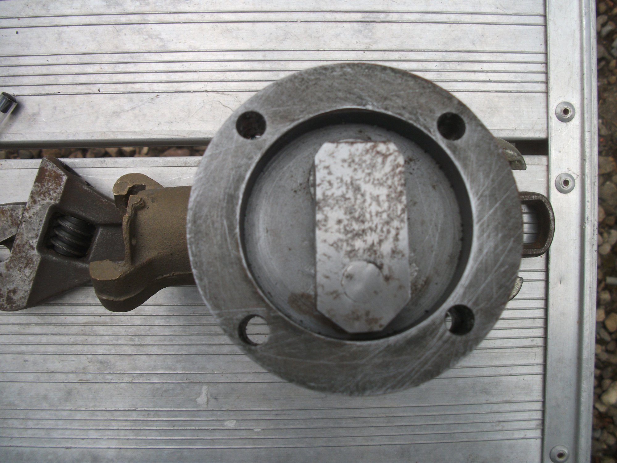

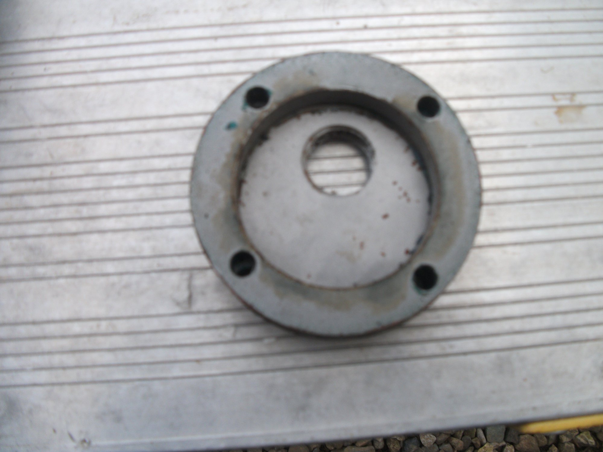

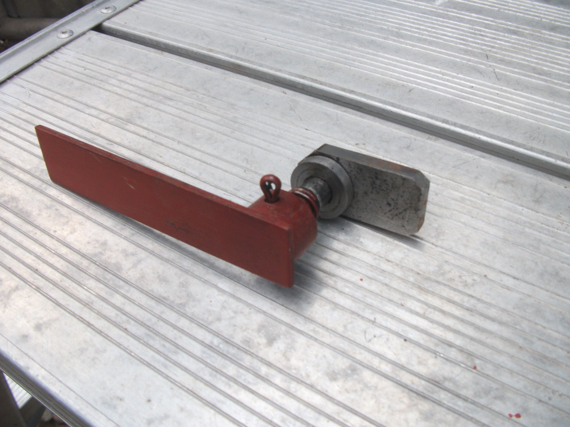

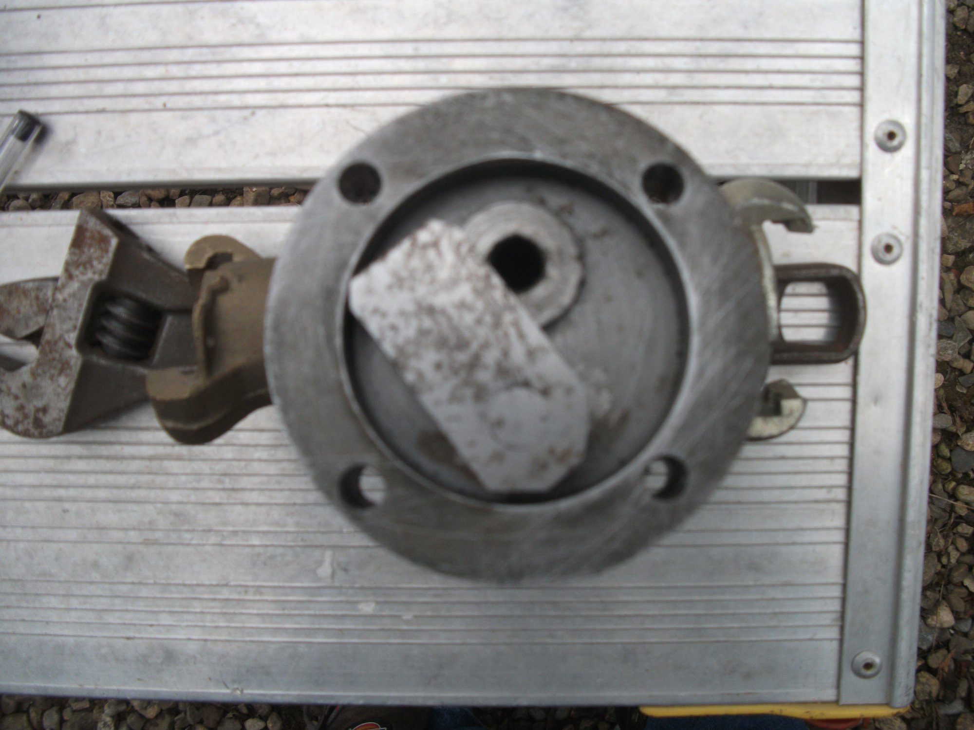

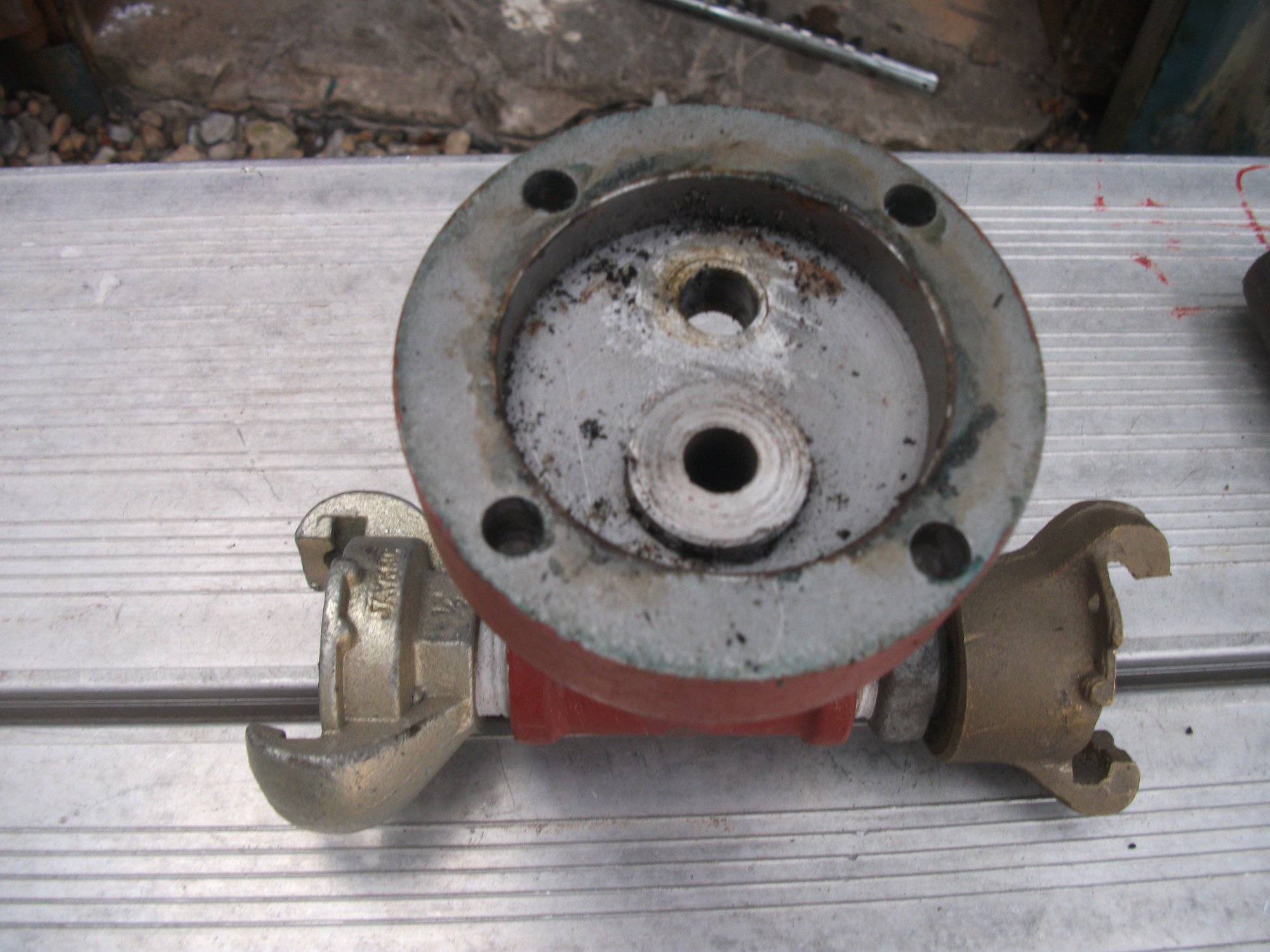

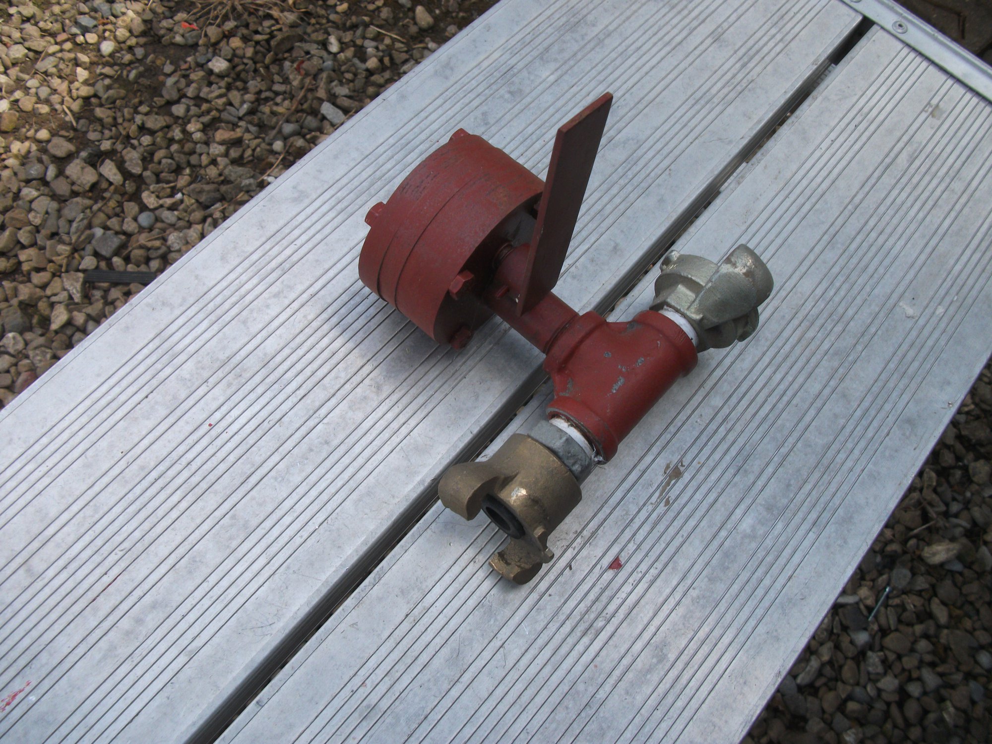

A good question and my best guess is that
1. The piston shape means there is no flat area for the sand to collect on
and
2. The cylinder is not at right angles to the incoming sand flow; again no flat 'shelf' for the sand to collect on.
3. The piston is shiny: like a hydraulic ram
We shall see whether it works but I did notice on my last trip to the blasters that he has something VERY similar (although must bigger) on his pot.
there ok on the larger pots as grit size isnt critical but on smaller units they dont work and can block easilyThanks for the update
There are gate-type grit valves, think normal gate valve with a rubber sleeve for the grit to flow through, the sleeve is squeezed by the piston in the valve. This avoids the flat ledges mentioned above.
