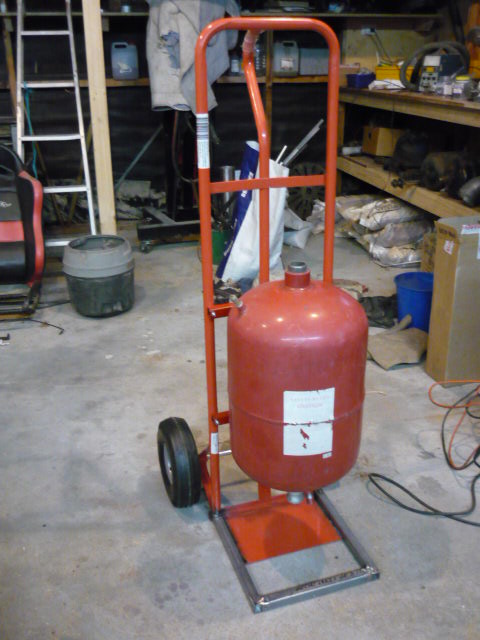

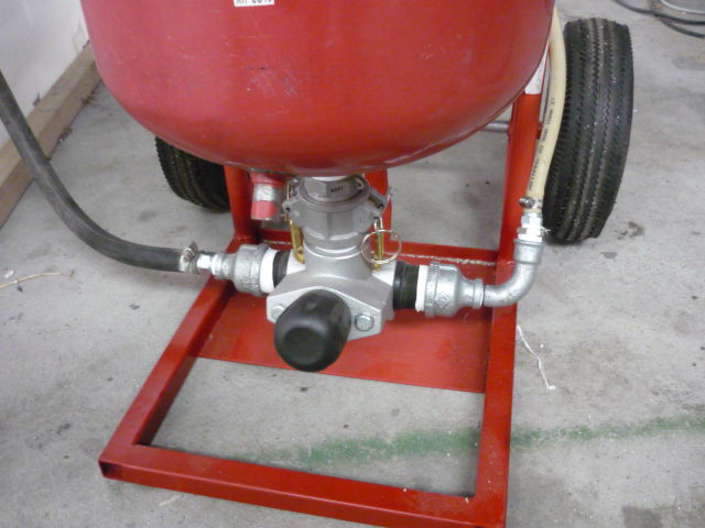

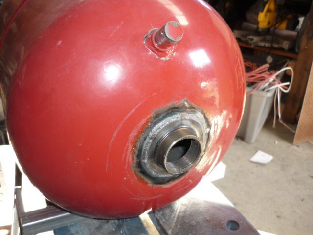

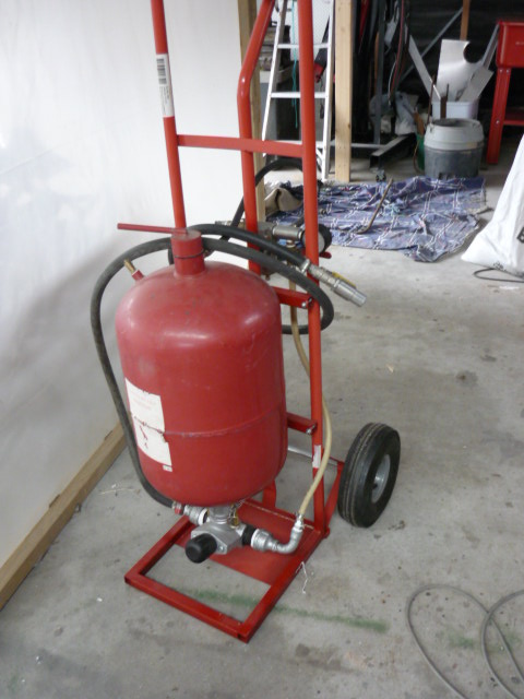

I'm sure fair few of you have one of these pressure pot blasters. It's the standard Chinese n gallon pot that all the tool marts seem to sell.
It works,but only after a fashion so I have been trying to improve mine and thought that I would post some progress.
So what is wrong with the base unit?
- It frequently stops flowing sand. You get it all working, get all the gear on, climb under the car and after a few minutes - no sand!! Shake it, adjust the valves, take it apart; you get the picture. Very frustrating.
- The frame is very weak, especially when the tank is full and the unit very heavy.
- The wheels are not suitable for anything but a pretty flat surface.
- The ceramic nozzles last a matter of a minutes.
