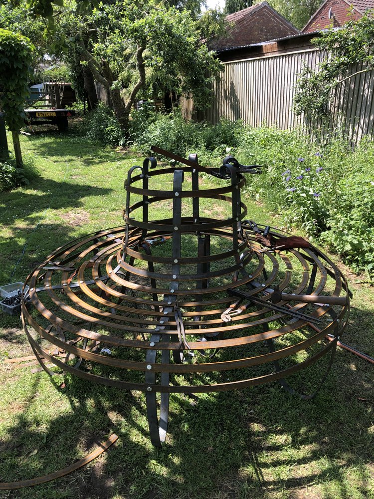

Difficult when the bands are cambered.Got a bit further today, four rings left to roll, but three of them are just flat, no cone so shouldn't be too tricky.
Yeah, been interesting. Supporting a 6m length while rolling them was funDifficult when the bands are cambered.

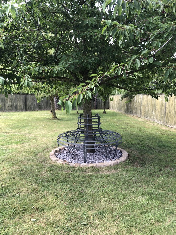

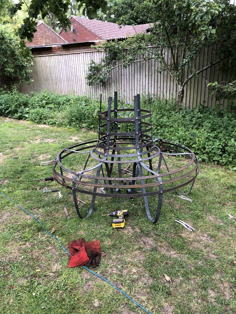

They will come back in and they will be bolted to concrete around the tree giving plenty of room, they are off the ground as it sits like that.That's a great bit of work, well done. Only thing I would say is the scroll feet turned inside seem a bit tight, not much room left for a big tree butt
All in I reckon 8 days plus materials and hot zinc spray when it's done.Thats really nice, how many hours do you reckon in that?
I've done some over 90 degree brackets to pull it back in, they will be riveted to the hoops and then bolted together.When you cut it how does it join together again?
Its a credit to you, hope your going to stamp your name into it in a few places!All in I reckon 8 days plus materials and hot zinc spray when it's done.
So a lot more than I charged for.
That deserves a proper brass nameplateIts a credit to you, hope your going to stamp your name into it in a few places!
Yep, if I priced it properly it would've been £2.75-3kI’d charge £2250-2500+vat for that,taken me 35+ years to stop underpricing!
