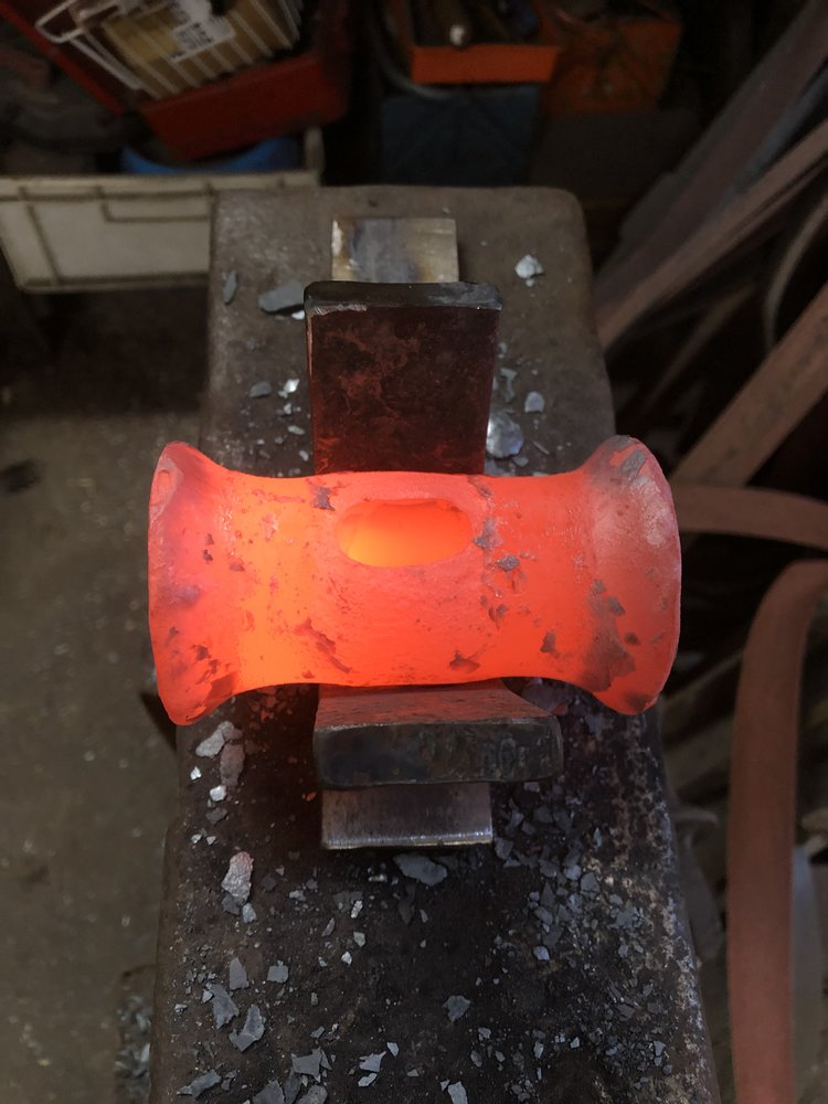

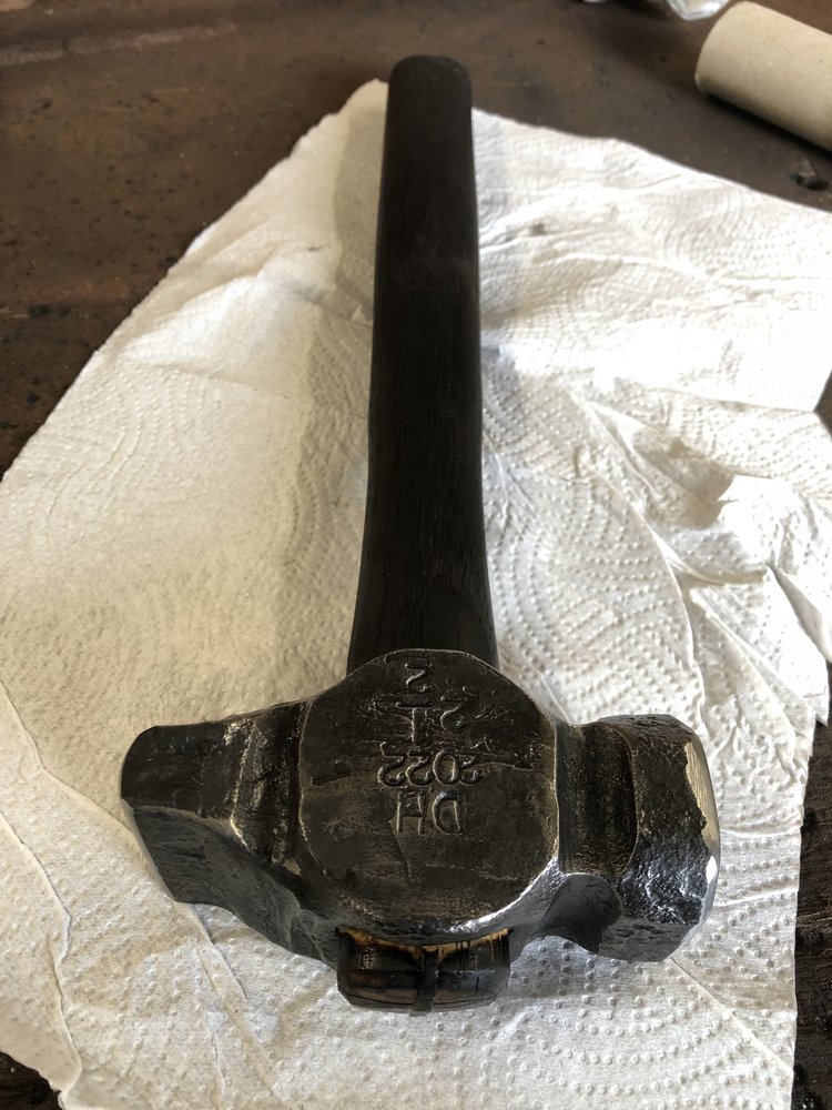

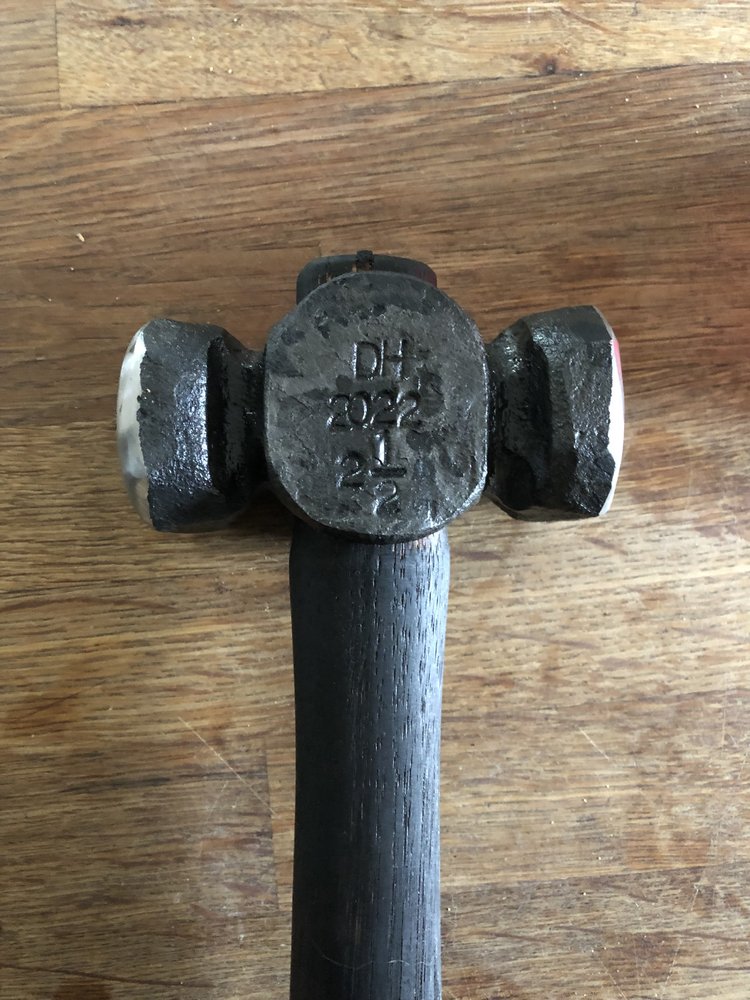

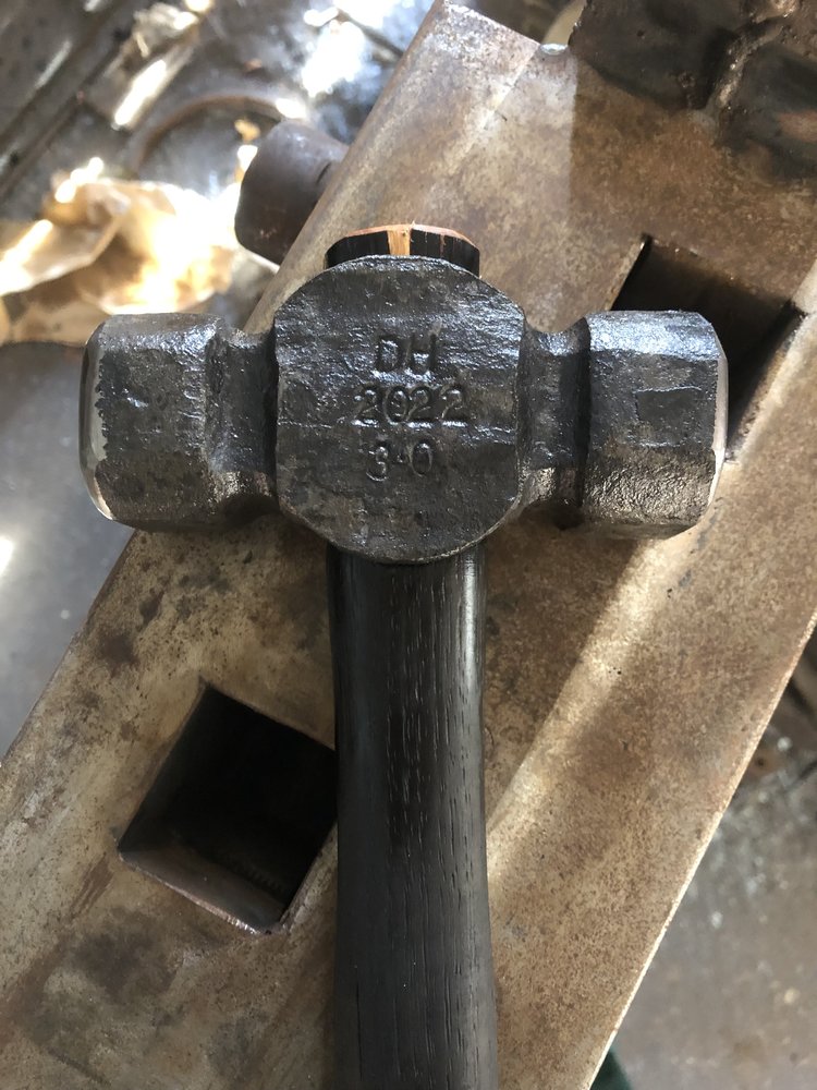

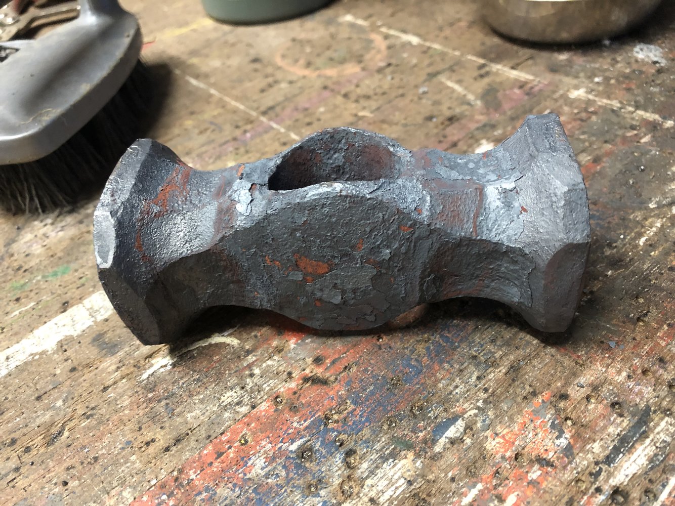

New design, had some hydraulic ram that I fished out of a skip, 41.something diameter which is a bit small for a hammer normally.
Stripped the chrome plating off in an acid bath outside, and stuck it in the forge. This is where I am at now after upsetting both ends to about 60mm round and reducing the length from 13cm to 10cm, then punching the hole with a slot punch (by hand! Normally I would use the fly press). I have just started drifting it in this photo.
And a nice clean slug from the punching
