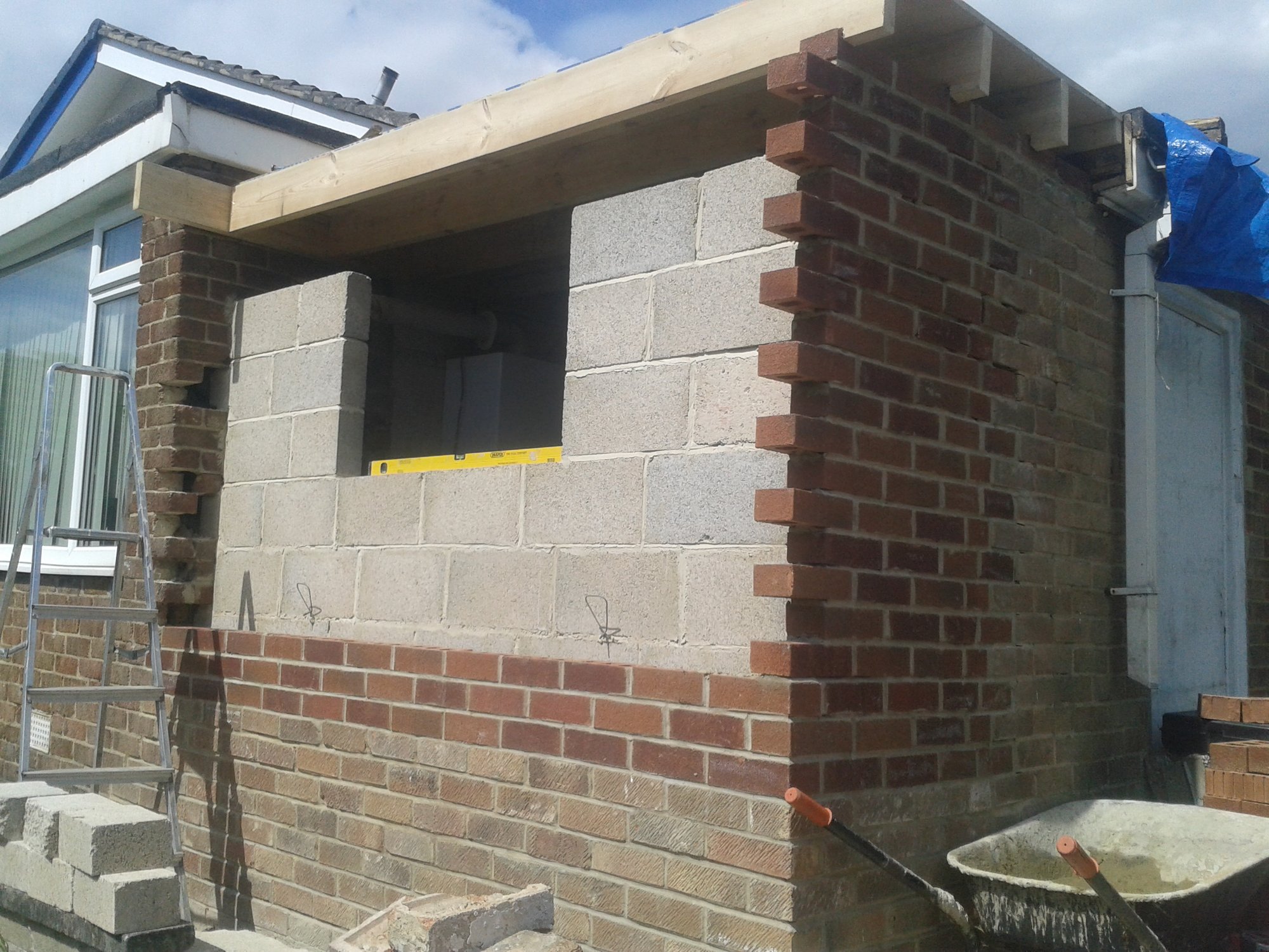

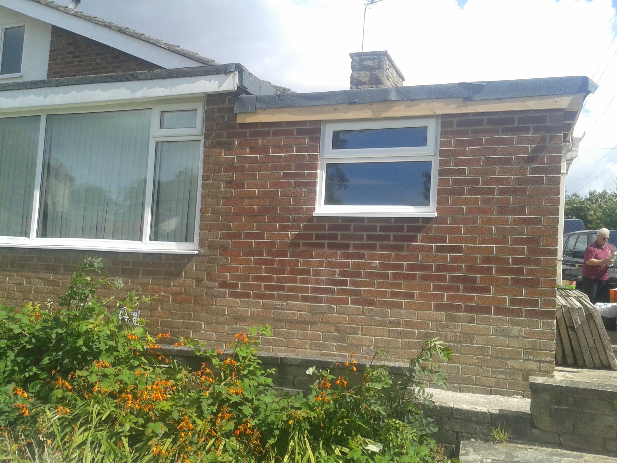

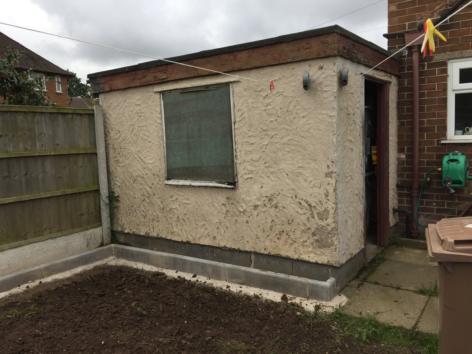

Who the duck done the roofgarage back wall rebuilt and also new double galazed smaller window
View attachment 189818 View attachment 189819 View attachment 189821
only winding you up Gazza lad...i knew a man of your magnitude would not leave work like that anyway man you left yourself wide open putting the pic up in the 1st placei wondered when you might say something
it was a quick seal and meant to be trimmed off so equipment an old car didnt get wet inside the garage, another roofer was coming along doing other proper coats of roofing felt on top
but as im finding out the owner is lieing hes more interested in buying vehicles than actually doing any repairs to his property

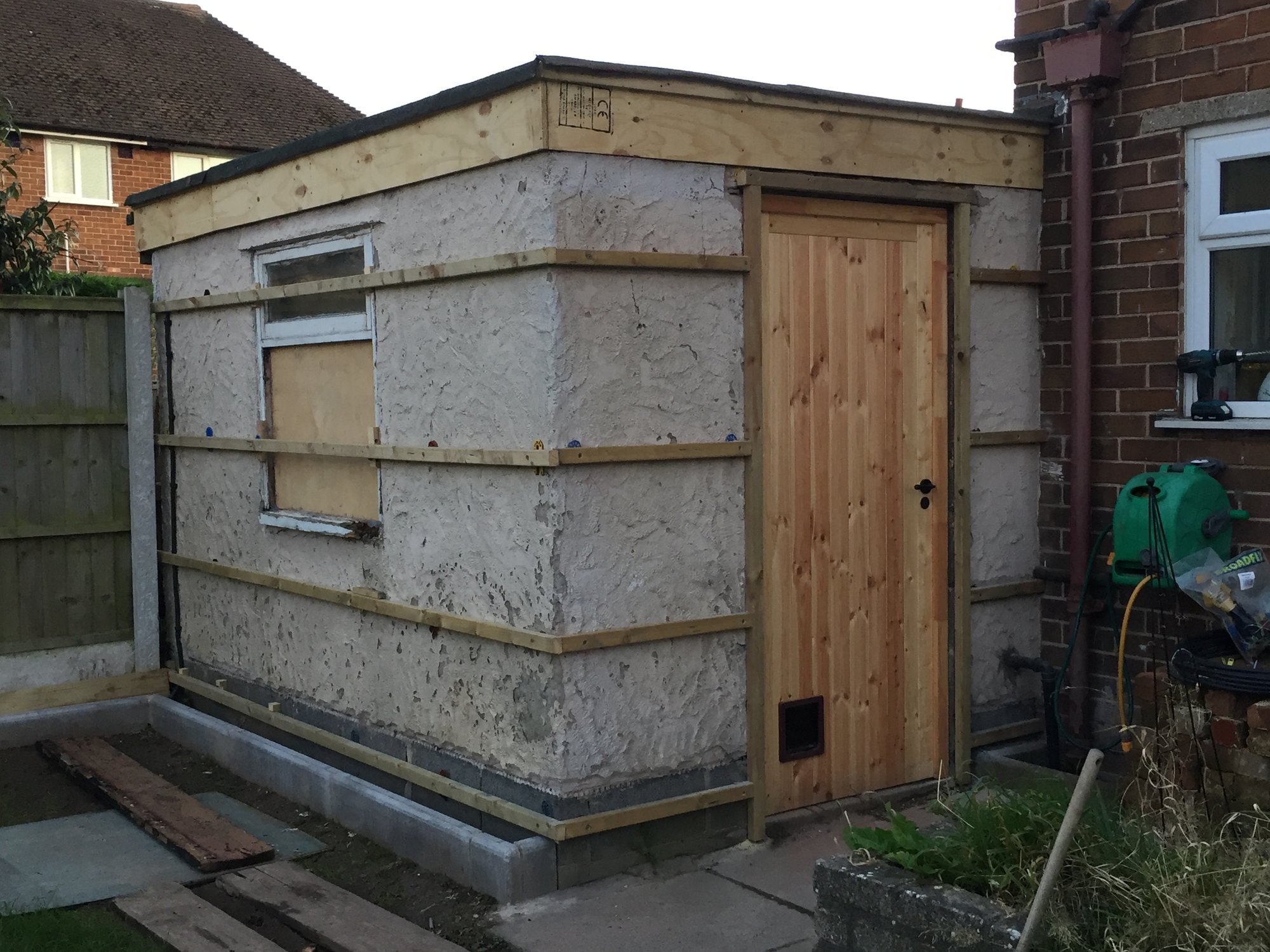

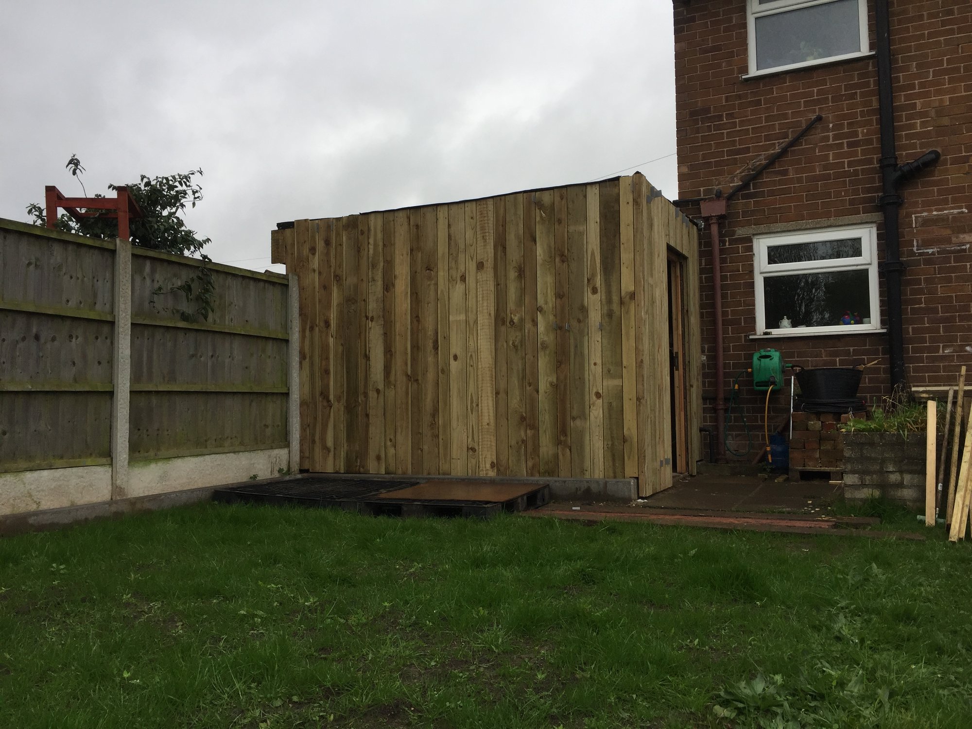

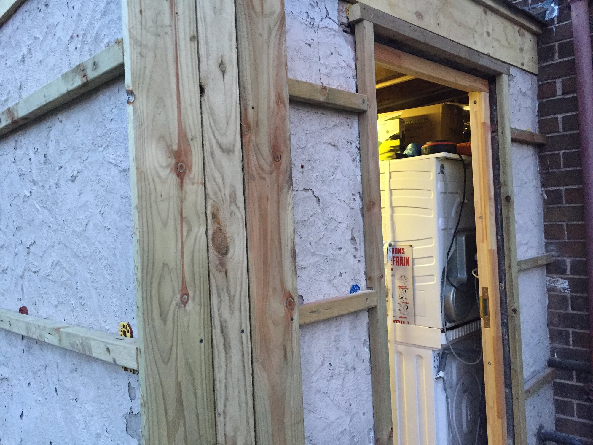

You are doing fine and i work local so i do things between other jobs, Also the base for my shed went in about 5 years ago so factoring that in you will be quicker than meA bit more done...been away with work and the weather has been against me - @Olderisbetter has built a whole shed in the time I’ve been doing this
It was a nightmare getting all the battens to sit reasonably even on that render, loads of shims needed. Not sure whether I saved any time or not. I should have covered the whole window with a big sheet of ply or just taken it out altogether, but didn’t have anything to hand and needed to get on so just boarded the broken pane and sealed everything else up.
I did get some tyvek type stuff, but I’m thinking of not bothering with it as I’m leaving small (3mm) gaps between the boards and it’ll just get wet anyway, so it will be saved for the next shed. Cladding is going straight over the top of the cheap ply fascia.
Cladding should get finished off next time we have a dry afternoon. Haven’t decided whether to do a random effect or just alternate thick / thin. Then for the roof.
