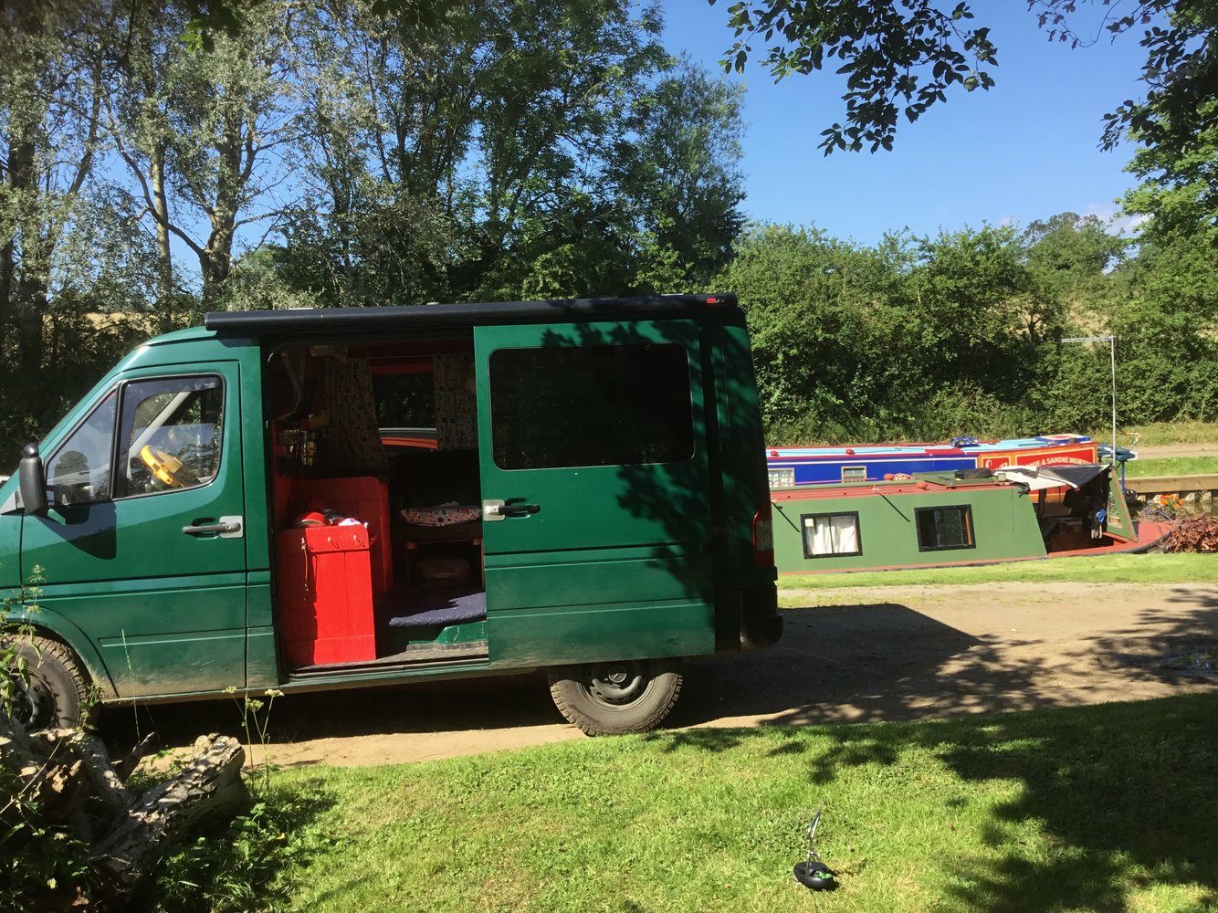

I'm so long out of modern vans, I had good luck with my 2002 Sprinter with a 2.1D engine.......god knows what they are like now....
