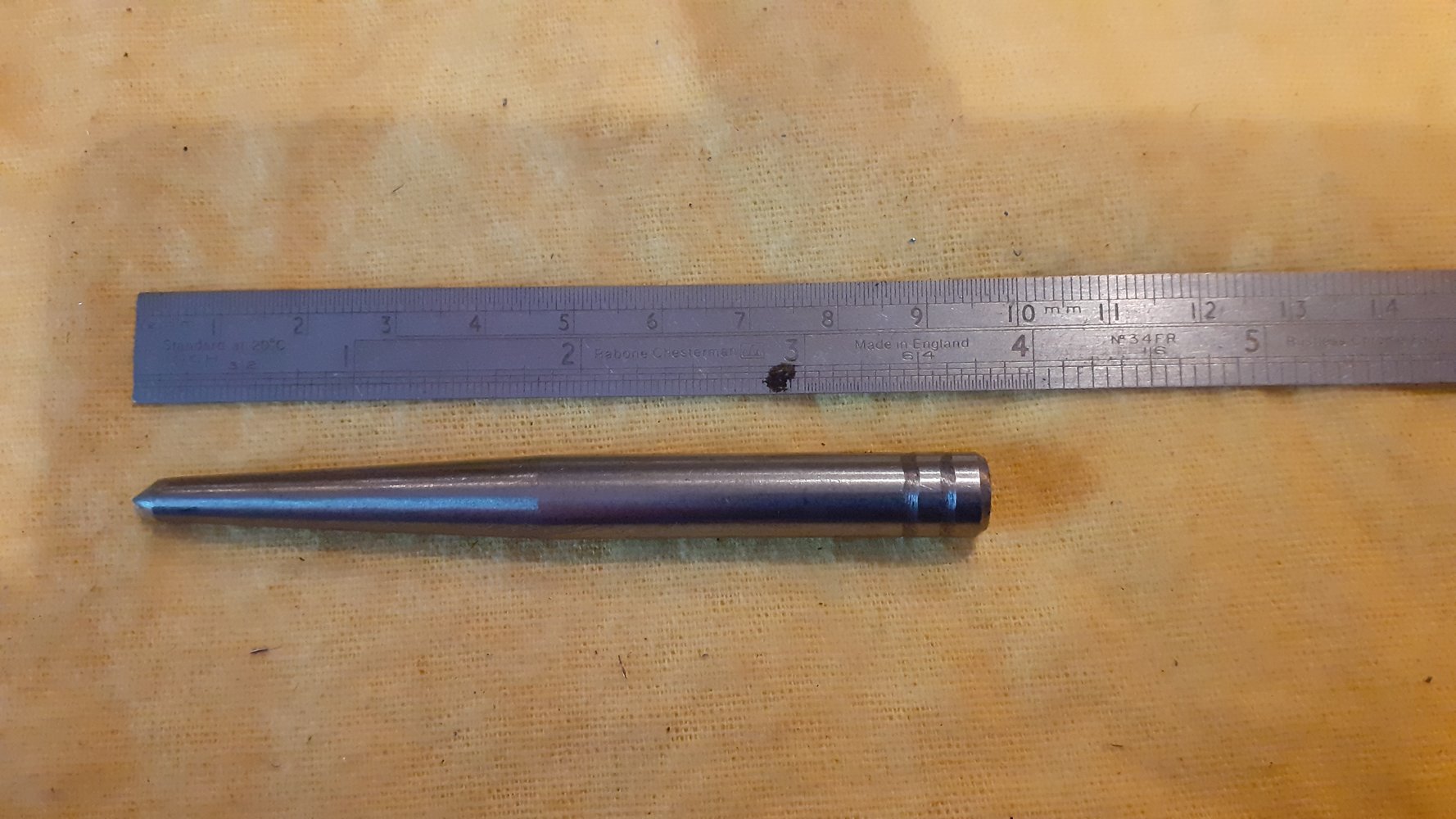

Something hard, that's been designed to be impacted, preferably a few thousand times a minute.What is the ultimate centre punch material?

I have one made from an Exhaust valve somewhereSomething hard, that's been designed to be impacted, preferably a few thousand times a minute.
drive shafts u got any going spare? or torsion bars maybeUsing a tap would worry me, they seem like nasty brittle things that could shatterWhat is the ultimate centre punch material?

I've used a tig tungsten as a punch a few times, I'm always worried but I've never actually had one break.Using a tap would worry me, they seem like nasty brittle things that could shatterWhat is the ultimate centre punch material?

TungstenS make great scribesI've used a tig tungsten as a punch a few times, I'm always worried but I've never actually had one break.

That's why I've usually got one on the bench. Haven't actually welded with one for a couple of years.TungstenS make great scribes
