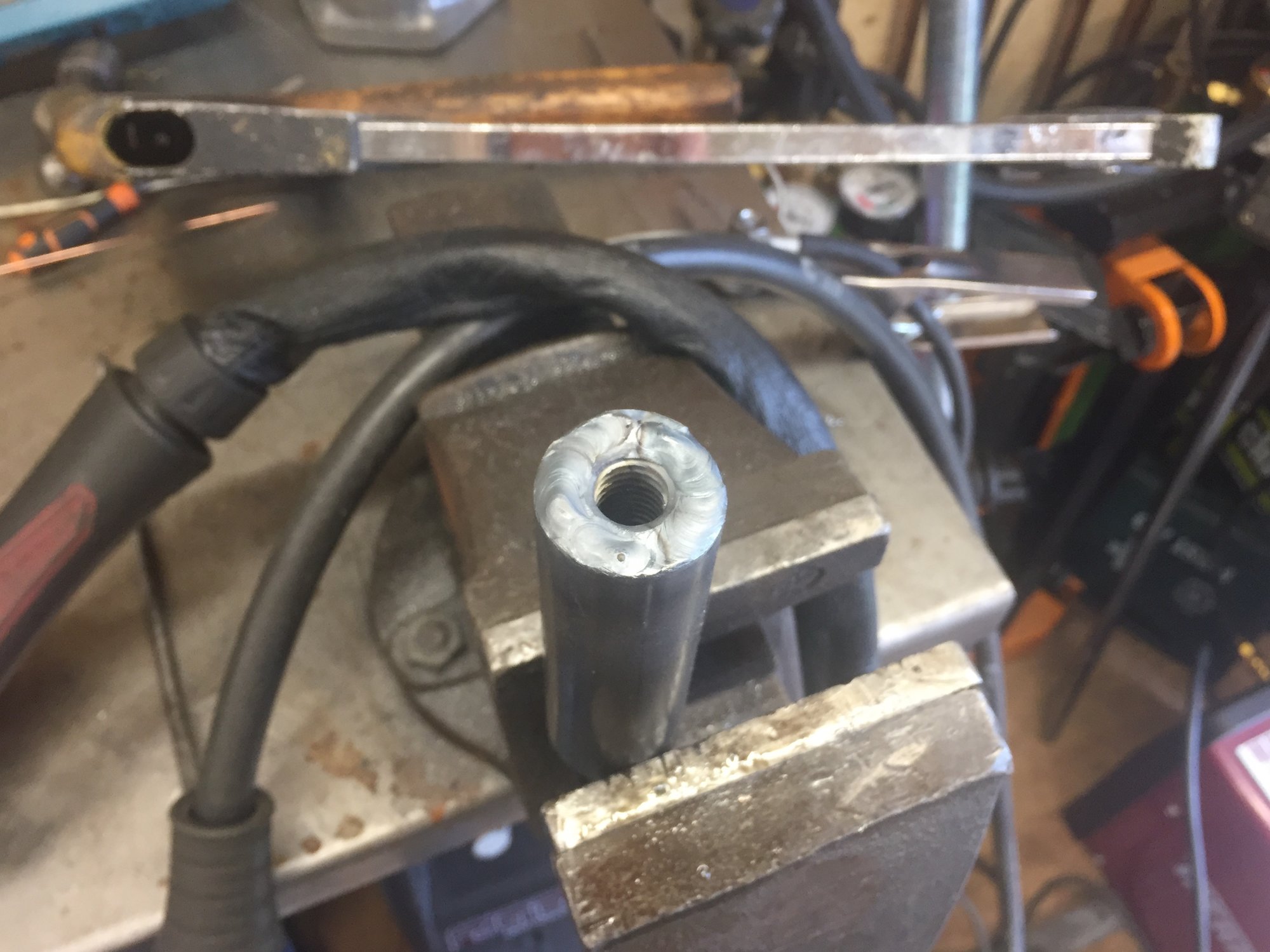

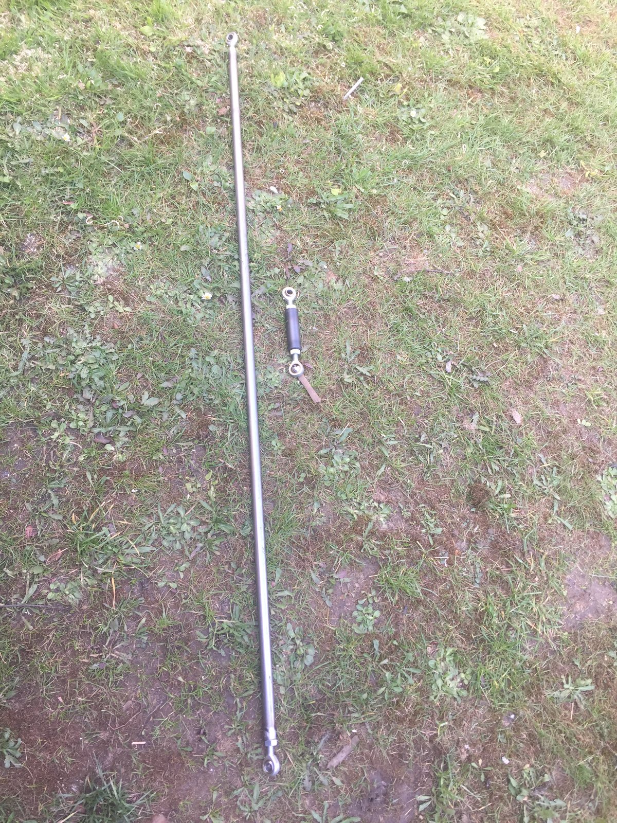

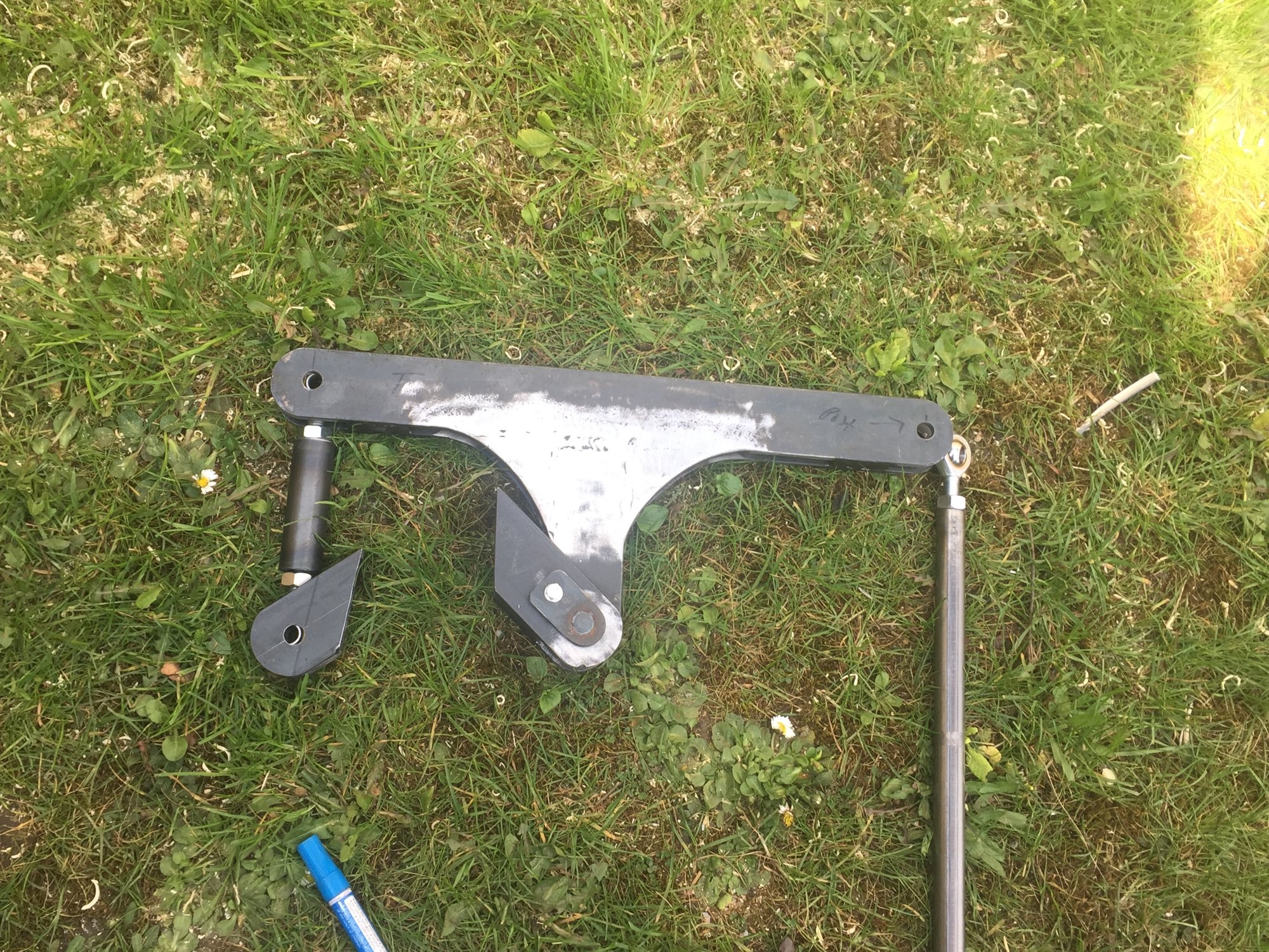

Today I began by welding the left hand and right handed thread inserts into the tubes which gives me adjustment on the mechanism.

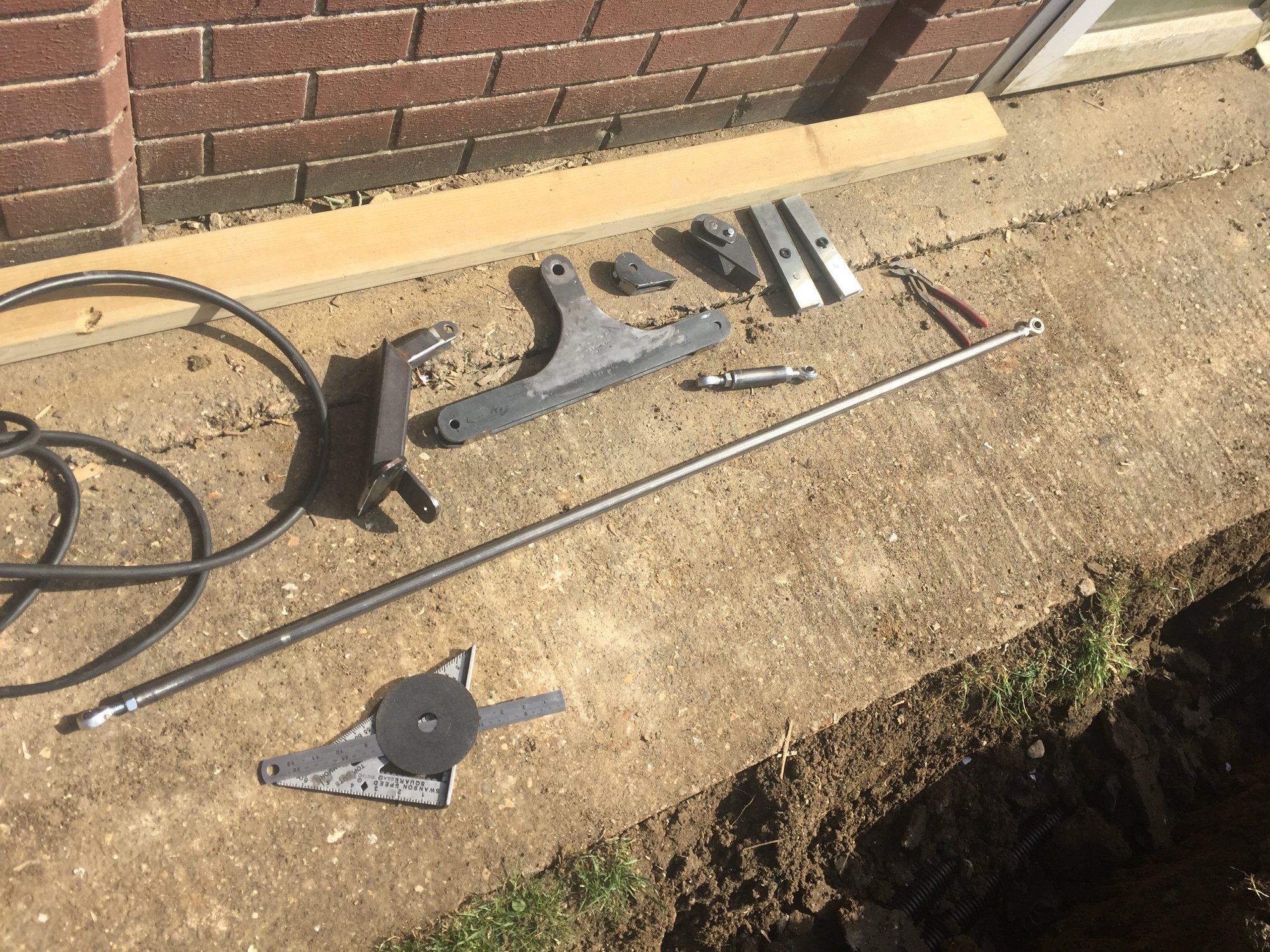

I then made my little pin for the actuator arm to the gate mount. As can be seen here
Here’s it all laid out

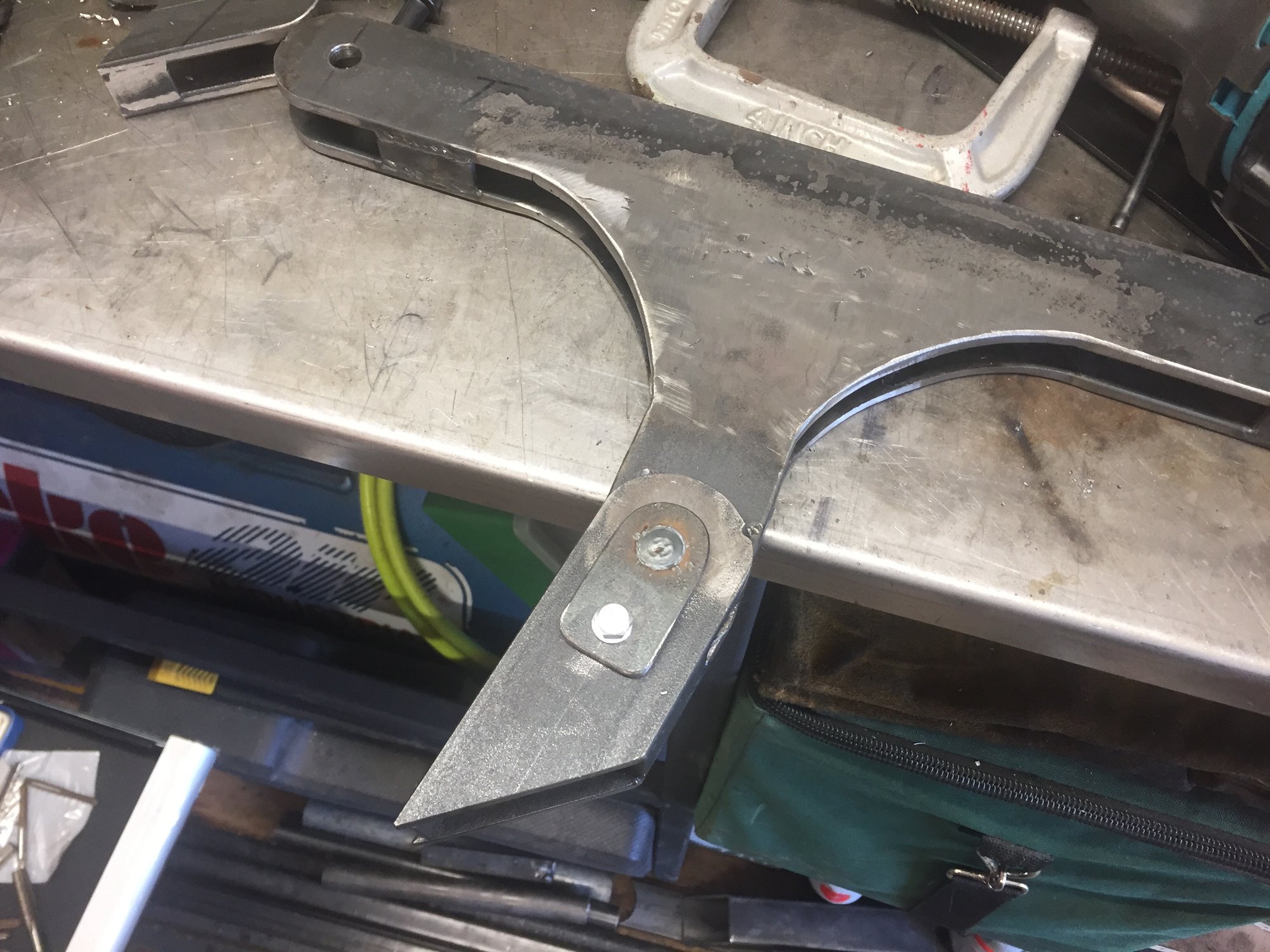

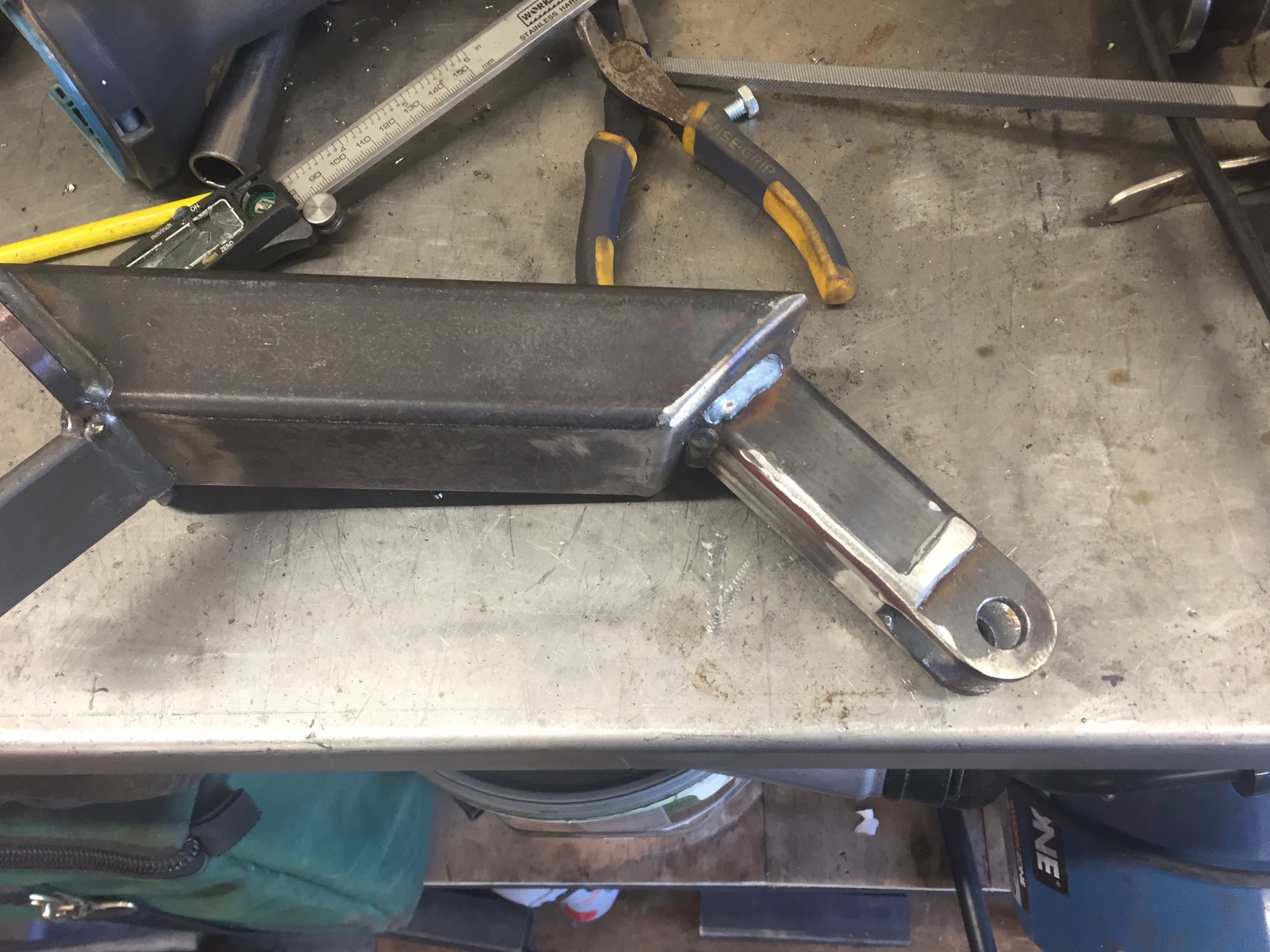

Pondered for a while and came up with a new design for the main post fixing points I think it looks good and functions well.
All the bits ready to weld on.
Main post fixing point bolted on View attachment 224090

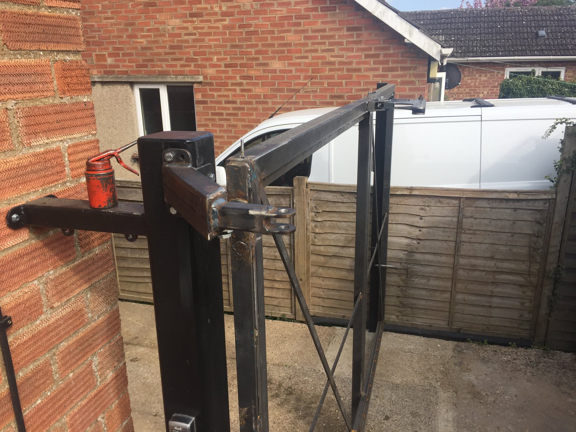

And finally the finished article.
I’m going to leave it all connected for the weekend to find any faults. I need to come up with a solution for the gates banging together. Not sure what material to stick between that won’t look rubbish.
Also the end of the motor mount on the gate side I think is flexing very slightly, overtime this might be an issue so I think I’m going to get another piece of box section and weld it to the end side of the bit that’s already there, then weld it to the bottom gate frame rail.
The mechanism needs a little bit of adjusting as well I think and one magnet seems to be working on half power so there’s a few small jobs to work out. Nothing major and I think it’ll be sorted but time will tell and hopefully it’s nice enough next week to paint outside![]()
