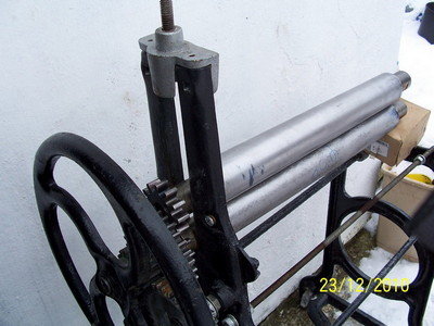

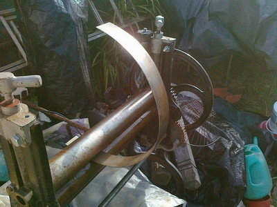

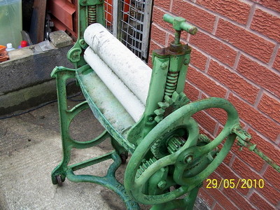

Parm might I suggest less reliance on welding the two ends together with the rebar and making use of the holes in the frame aswell seeing as you are going to be placing a LUMP of granite on it!
This mangle I re purposed had tie bars between the ends and I added some more
