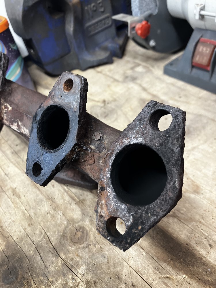

I was thinking that, but assumed they needed to come out for machine work or face skimming.I'd be leaving them well alone if the threads on them still do what they are supposed to do.
No point giving yourself more grief than you need to.
I think pure turpentine would also make a beneficial additive to the ATF as it creeps even in the most microscopic of cracks . Find it on line eBay or an artist shop that sells artist oil paints .ATF on its own is too thick. Try thinners, see if it mixes. Otherwise, diesel is a good one part release agent. The Acetone allows the ATF to get where it is needed before evaporating and leaving an oil film.
No, unless you need to machine the manifold face (super rare event). Leave them alone.I was thinking that, but assumed they needed to come out for machine work or face skimming.

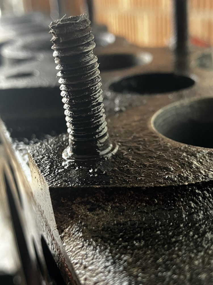

the thread seems to have gone on a couple of them, suppose i could just try and run a die on them?I'd be leaving them well alone if the threads on them still do what they are supposed to do.
Yes of course you will, or do you prefer risking having to drill it out?Looking closely at the studs they don't look too bad...apart from this one
there's an actual thread missing near the top so i don't think i'd be able to run a die over that....
obviously not, just thought the thread was far too gone? I'll give it a go anywayYes of course you will, or do you prefer risking having to drill it out?
Most exhaust manifold stud nuts are copper coated steel, certainly for vehicles from early 1990's onwards.Stick a thread gauge on them to make sure they haven't stretched and use brass nuts when re-assembling.

The old " Rigid " thread extractor tool is brilliant of taking out the sleeve left by milling out damaged studs there are also drill guides in the kit to help you center over a broken stud if you y-use a battery or corded hand drillMostly as per Memmeddu.
But not drilling at minor thread diameter of the stud - if slightly off, the threads can be drilled away.
At that point it would be on the mill table, so easy to drill them centrally and perpendicularly. Generally a pilot hole followed by increasing sizes of left handed (anti-clockwise) drills. Sooner or later the stud will unscrew, the latest at the point of almost drilling away all the central core at one point.
The one item I rarely ever use is a stud remover screwed in anticlockwise hole in the stud. That is a good recipe for further complication!
Exhaust manifolds often require milling flat. They can (sometimes) be sorted by extra gasket thickness but the cure is better than extra gasket material.
Making a jig out of thick flat bar so you put it over a good stud and lock it down precisely over the broken ground flat stud helps in drilling & tapping out the old stump threadLooking closely at the studs they don't look too bad...apart from this one
