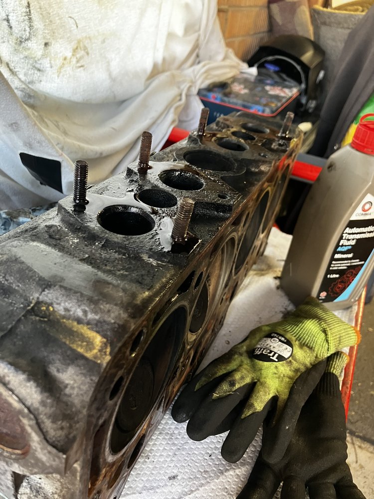

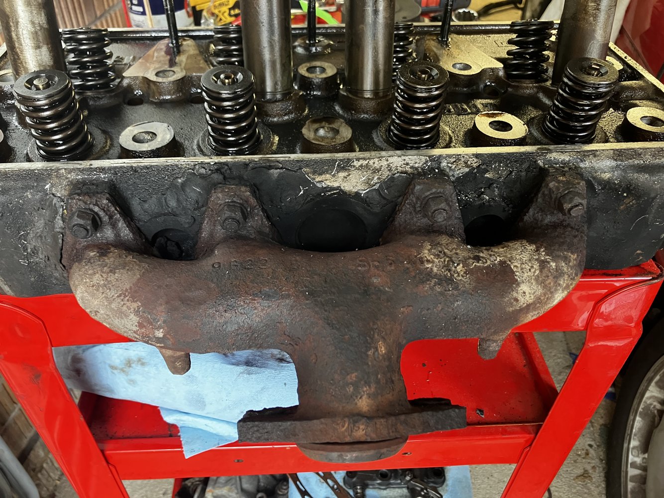

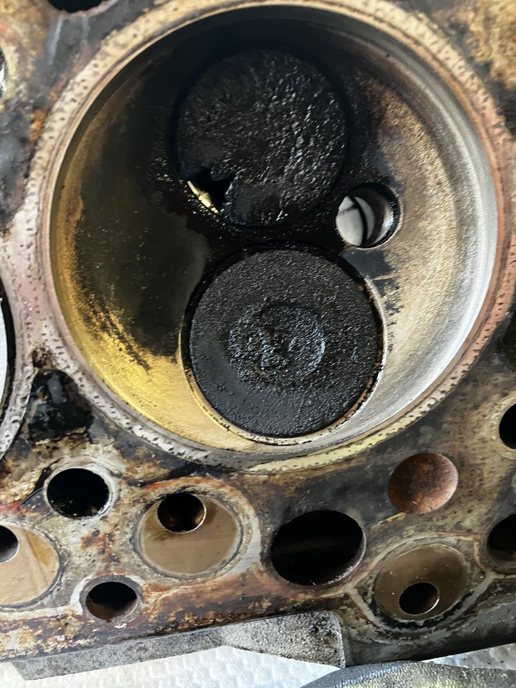

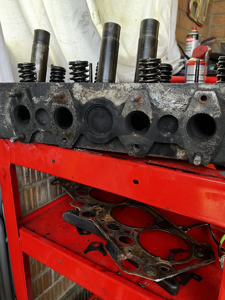

been removing the head from my talbot express due to a holier than thou exhaust valve
Just wanting to remove these exhaust studs from the head now and wondering what's the best way to do it without snapping them?
i'm reyt chuffed that i've managed to get the exhaust manifold off without snapping owt, used a lot of heat mind
my first attempt would be with more heat and a set of mole grips, failing that a couple of nuts locked together and an ugga dugga or even weld a nut on
what do we reckon
i've used copious amounts of penetrating fluid to help too
cheers
