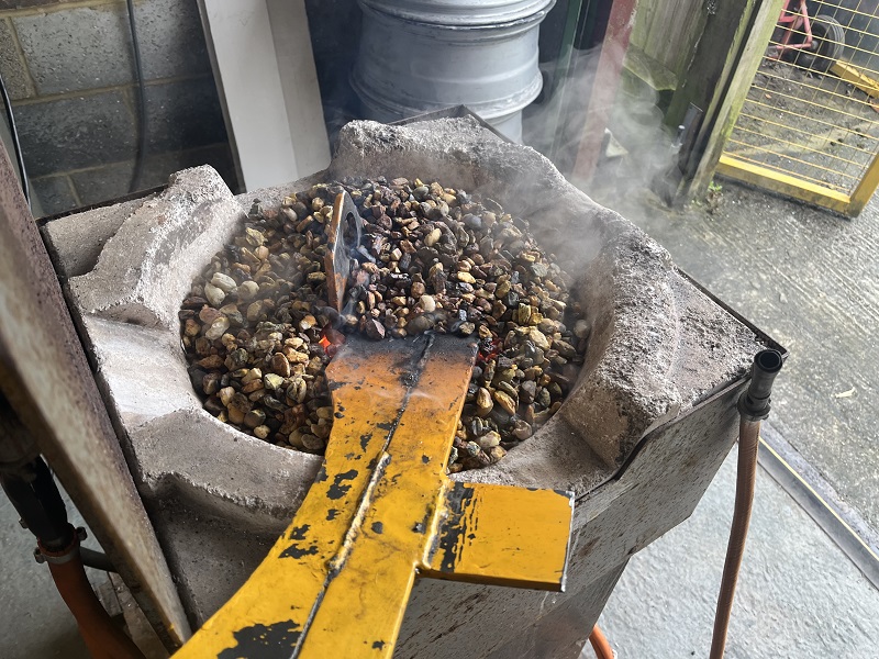

That’s interesting. Did you build that?Google Ceramic chip Forge. Many schools had them and they turn up on eBay regularly.

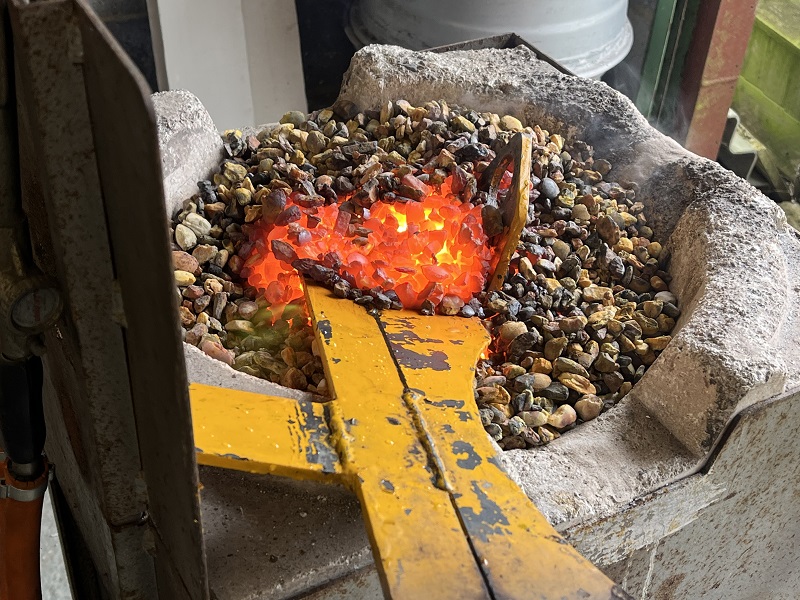

Here is a picture of mine yesterday heating up a massive bit of my JCB 3CX that I wanted to straighten. Remarkably fast, and gets hot enough to do hammer welding, which I have done but years ago. I run mine on domestic 240 volt single phase and a 47 kg propane bottle.
It has the forge basin itself that gas & air is forced though to heat as in the pictures, but it also has a powerful propane and forced air hand held torch - the force air is from an inbuilt compressor.

We had one in my last school, the ceramic chips lasted a long time, I used it fairly regularly & used to change out damaged or contaminated chips as they became worn out. Schools like them because they are clean & not dusty like coke. Downside was not nearly so controlable as coke and tends to retain heat for a long time. They make seriously good toast! Ones we had were made by Flamefast who seem to have cornered the market for school forge & brazing equipment, they are fitted with a host of safety cut off valves etc for school H&S which may give problems & be expensive to fix.Always fancied one of those ceramic chip forges. How long do the chips last?
