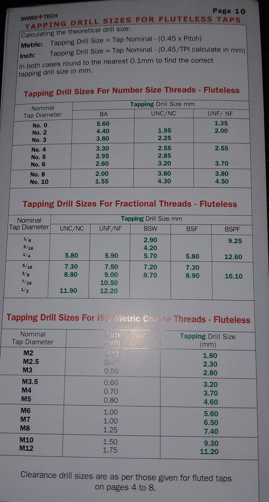

As it's thin sheet in mild it might be worth using a fluteless tap, gives stronger threads....

Drill taps would do that either in a drill press or out.The part is very similar to one of these -
The holes I need to tap are around that internal rim.
It's folded in 1.5steel and the rim is actually a bit narrower than the one in the photo.
