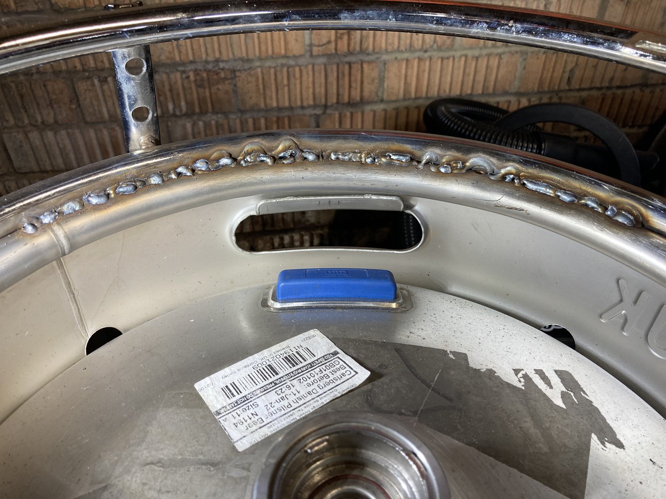

You only 3 or 4 1" welds around the rim to hold the seat on. With the keg being a good bit thicker, i'd turn the power up a bit hold the weld on the rim and flick it up on to the seat base then back to the rim.I meant i did a few runs on some sheet steel before trying this!I'm not sure that meets the dictionary definition of a runYou only 3 or 4 1" welds around the rim to hold the seat on. With the keg being a good bit thicker, i'd turn the power up a bit hold the weld on the rim and flick it up on to the seat base then back to the rim.

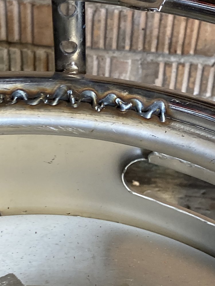

ah good cheers, my biggest problem is guiding the wire bang on in between the keg and frame. Seem to be wondering off so i have to keep revisiting and laying 2-3 beads in one area lolWhere there are beads, it's not bad![]()

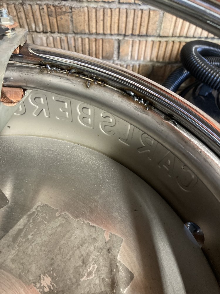

Is your mask/lighting a bit poor...seems to be an issue with aim?my biggest problem is guiding the wire bang on in between the keg and frame
I reckon i went overkill on the shading, always put it to max setting out of paranoia, put it down to about half way and that's helped a big deal, something i should have thought of to begin withIs your mask/lighting a bit poor...seems to be an issue with aim?
