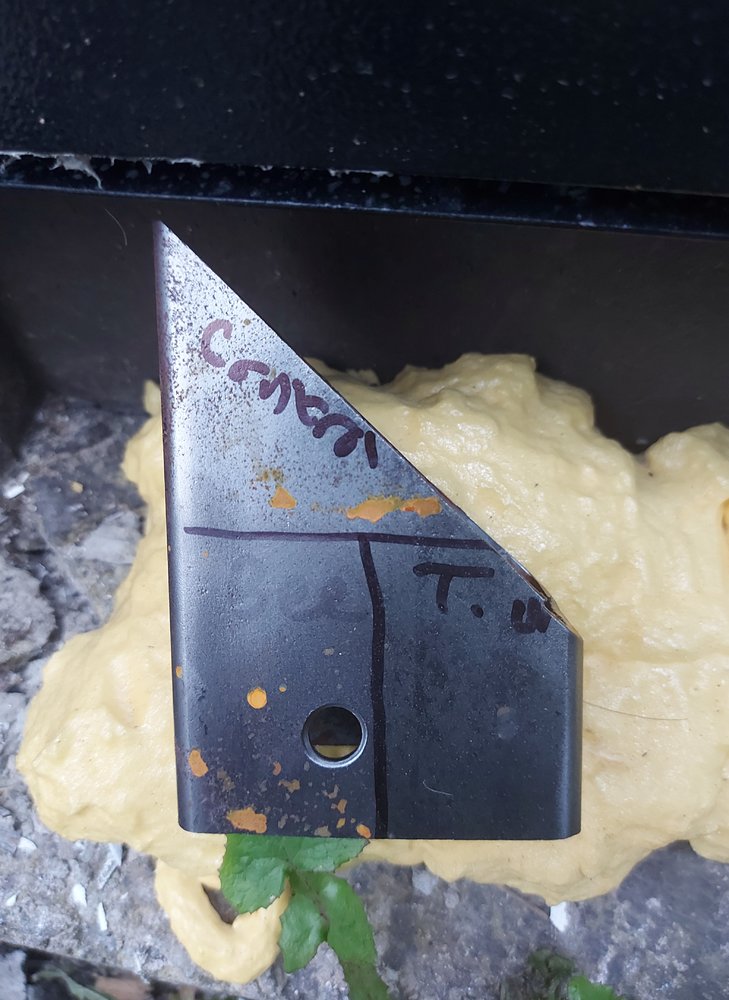

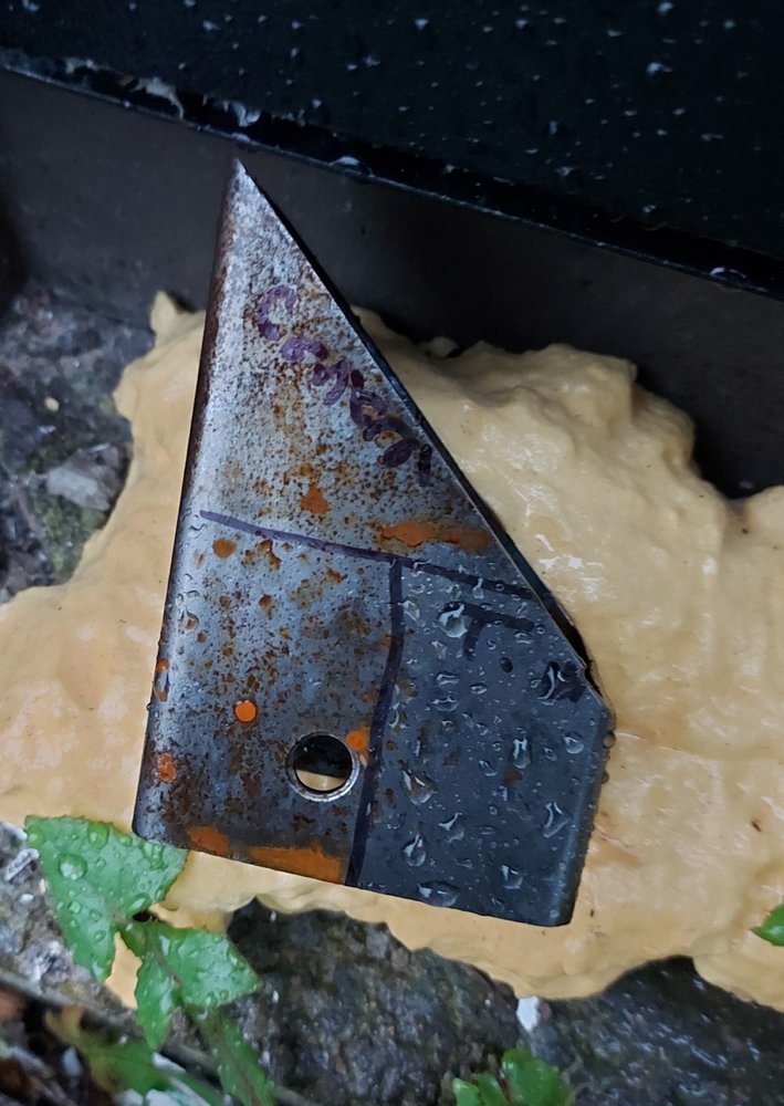

?the wax dont look much differance to the top untreated part ?
I've never had any tool wax. How does if feel compared with the Bee's wax; do you have any intuition, based on the feel or the look why one should be better?
I wonder if it the case that the Tool wax is a better wetting agent? You look at a piece of metal and you think it's fairly smooth and polished, but under a good microscope it looks like a ploughed field (unless it's been electopolished or similar). Maybe tool wax gets down in to the surface detail better?The tool wax seems a bit looser consistency. It goes on and off easily enough and leaves no residue to the Touch.
