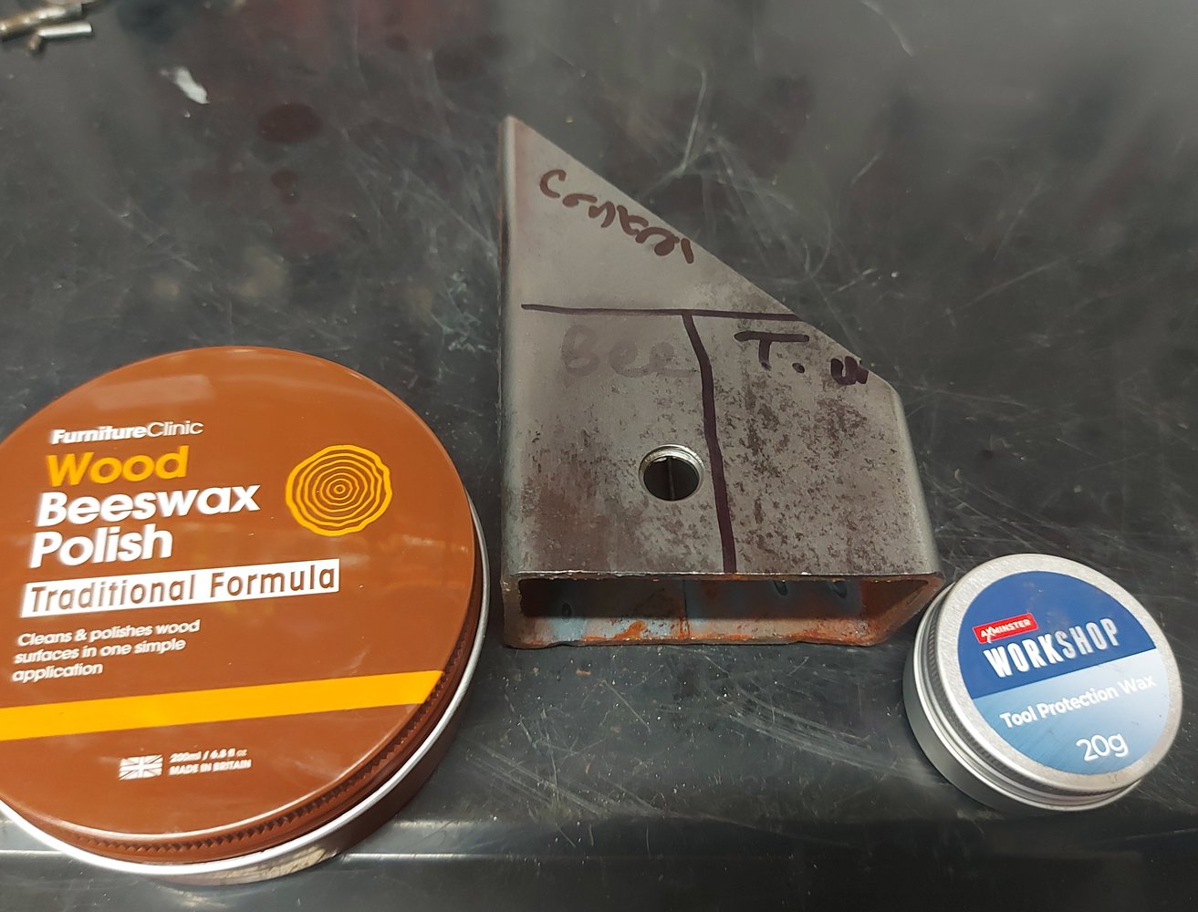

Heard of people on here using Bees Wax to protect tools. And also the small cans of Tool Protection Wax by Axminster.
Which one is best?
I took a scrap box section off cut which had rust and wire wheeled it clean. Wiped with acetone and then applied small areas of both products with separate clean rags.
This is just a basic test so don't give me grief please!
I'll set it outside my garage wall where it will get some rain but not fully exposed and report back in 24 hours then for a few days after and see which of the 2x waxes seem to protect the mild steel from flash rusting the longest.
