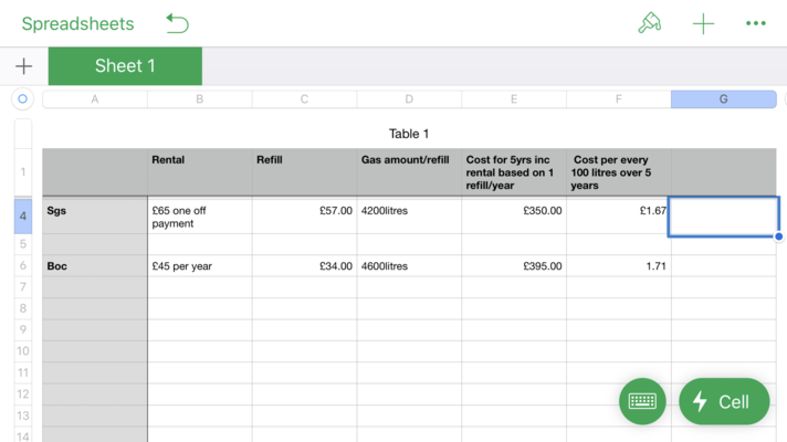

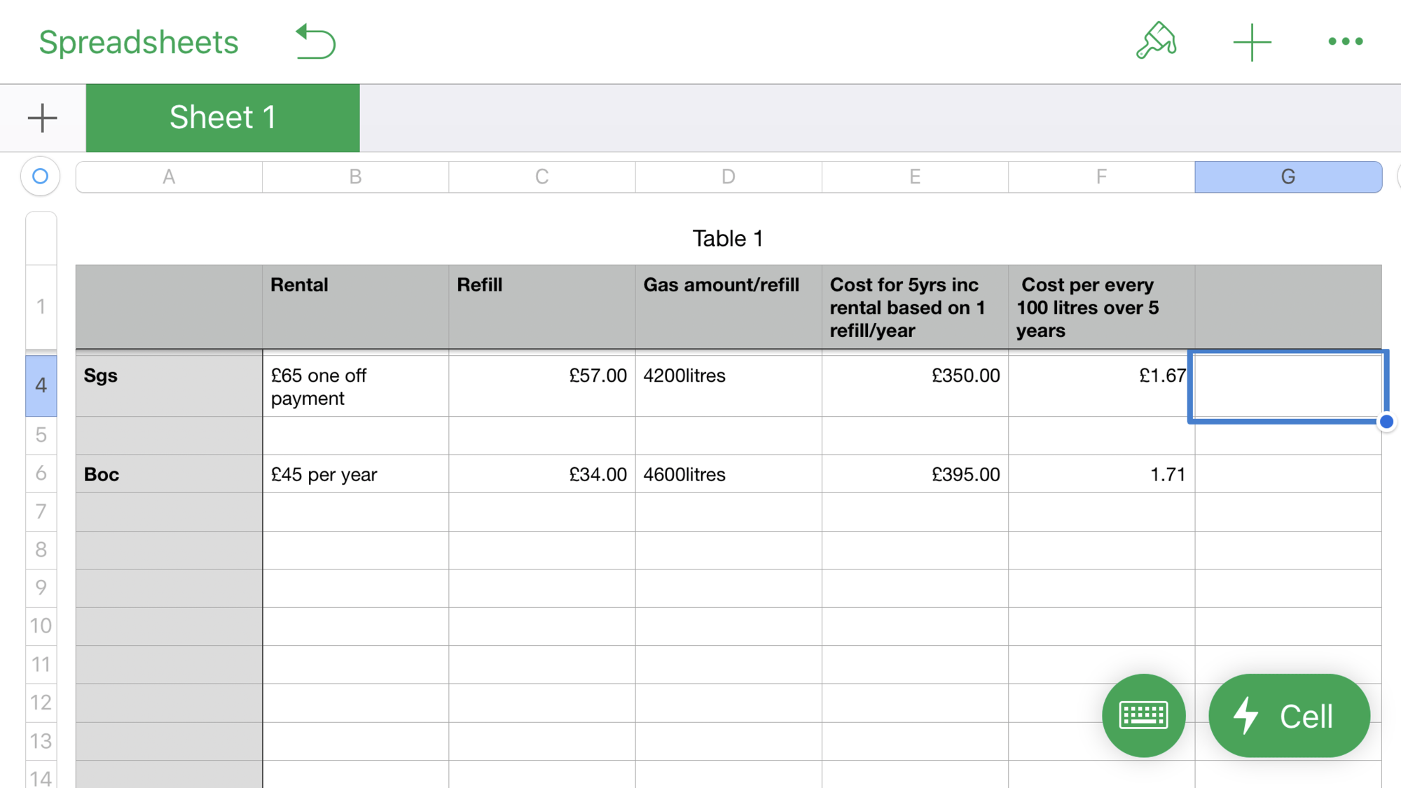

If I’ve worked it out correctly, given the lower sgs refill pressure and having one refill per year (which I’d never do, so just for comparison) I’m fractionally better off with sgs, Hardly anything in it but certainly no worse + my deposit will come back if I switch. unless my maths is wrong.
If you used only two full bottles over 5 years (light user) then the cost per 100litres is £2.13 with sgs and £3.18 with boc (£293 compared to £179 over 5 yrs)
I’ve included the sgs deposit in my calculations although there is the argument that as you get it back it shouldn’t be included which makes sgs even better value for the light user.
So if you are doing more than one bottle a year, boc works out best, a bottle or less a year then sgs works out best.
