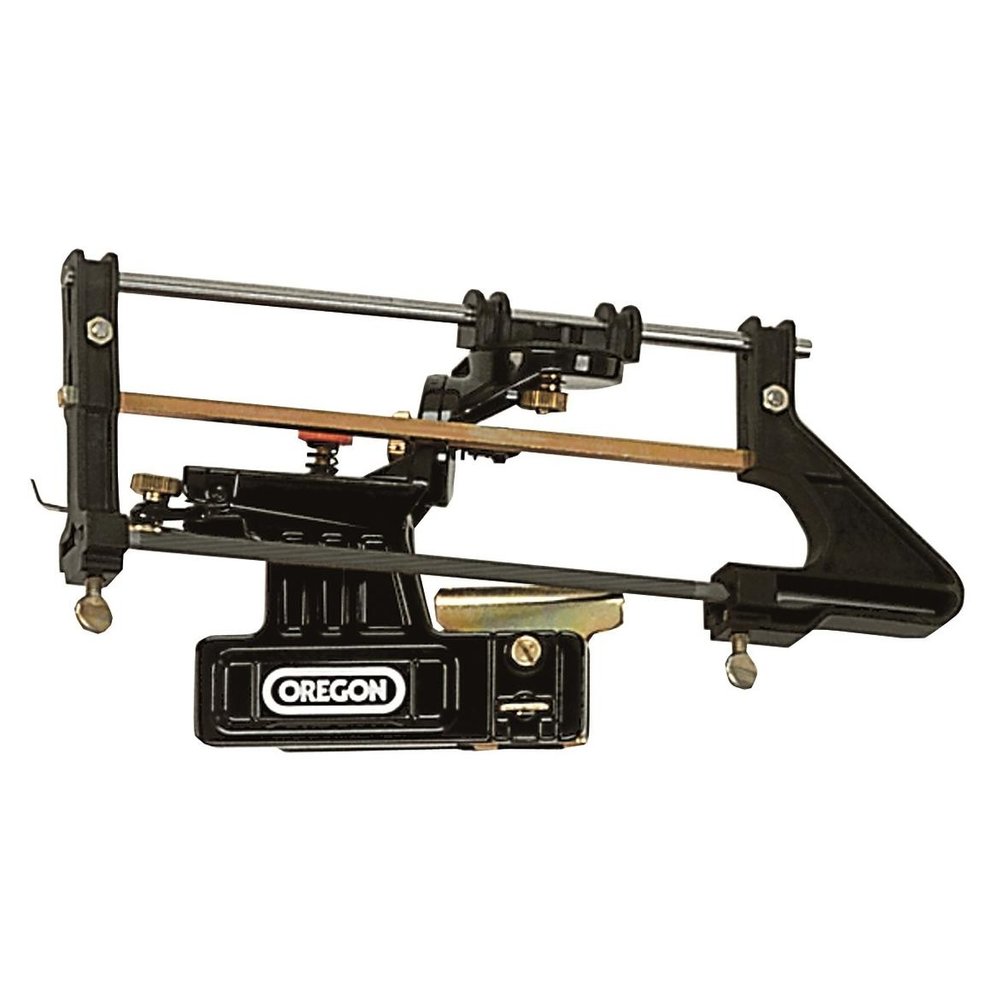

Can I afford a rescue chain? When I did a quick google it looks like these are specialist sawsAll chain requires compound angles, it’s not a hard skill to learn,
all the cheap electric chain sharpeners eat chain, you only need them to reprofile after a really bad session where the chain is mangled

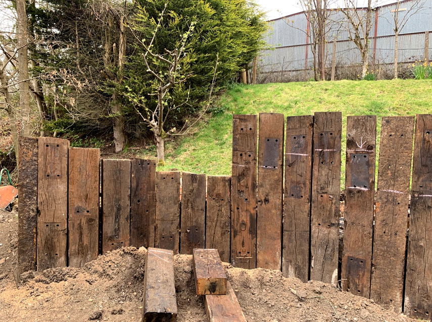

for used sleepers get a rescue chain or use a circular saw, total waste of time to use a regular chain as it will take the teeth and chrome off in seconds unless you are extremely lucky
