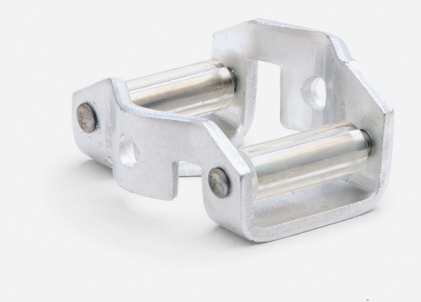

This is my favourite chain sharpening guide, I've tried a few and they all work well, but this one is hard to beat.
Husqvarna File Gauges | Husqvarna .325" H25 File Gauge
Husqvarna .325" H25 File Gauge available online now from Sam Turner & Sons | Take a look at the Husqvarna Chainsaw Filing Accessories - available at a low, competitive price.www.sam-turner.co.uk
They work well.
The issue I have with husky chain is that it's a compound angle, ie back and down, so those rollers are really useful.
Stihl chain is just 30 degrees on the horizontal so much easier to get right. There's even a little line showing the angle on each tooth. I know it's a wear limit but it does both

Those lines are handy but you also have to keep the file the same on the horizontal plane and as a hobby user think the backhanded blades get a different angle
