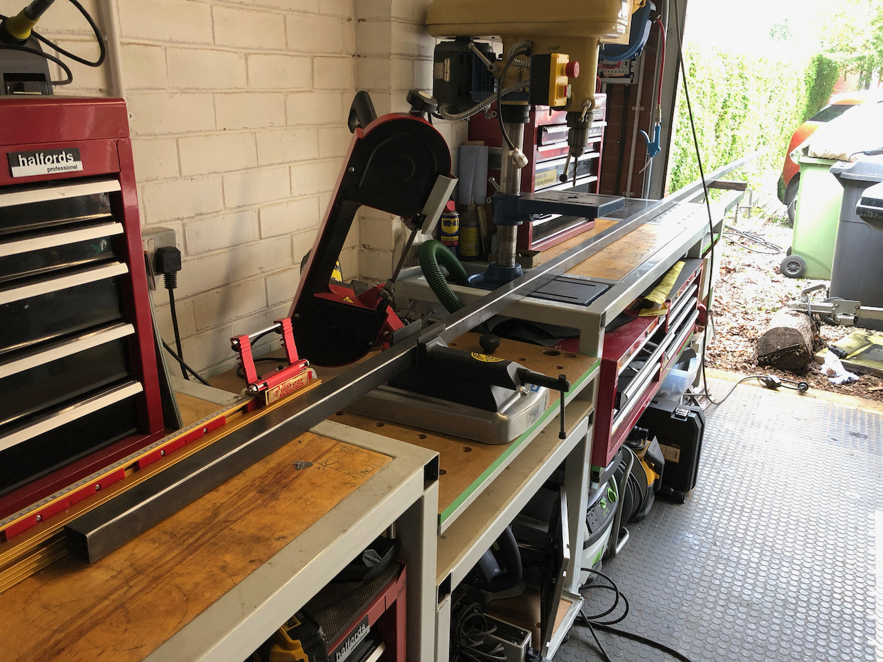

I spent a good hour tidying before I took the pictures of my benches.Love tidy workshops

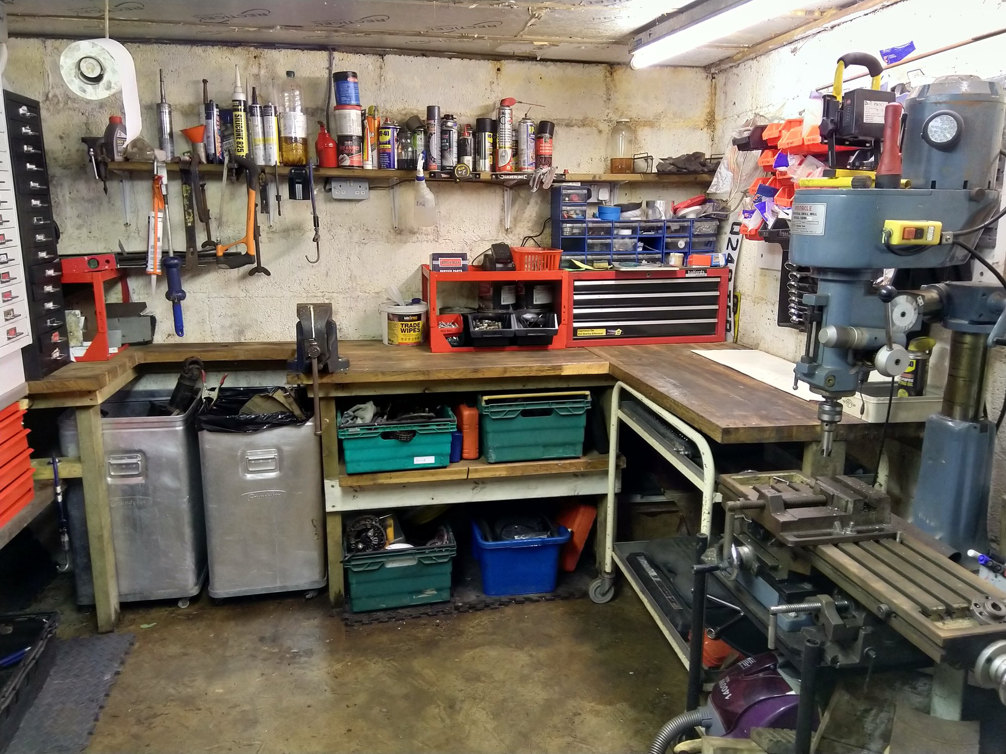

A breakfast bar is better, if you can find one, they're thicker & wider than ordinary tops.![]()
I once planned big long benches along 2 sides of my old 5 x 6 shop, but a workmate pointed out that they will simply end up full of junk, and I'd end up working on a small area. He was right.![]()

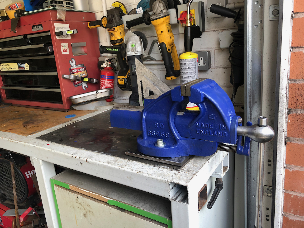

I've used scaffold board, kitchen worktop and doors over the years all have worked fine. For my current place i made the workbech units with 18mm ply inserts that can be flipped or replaced and so far works a treat. I do have various half inch plate inserts for whacking things and small welding jobs which saves the ply from heavy abuse.
