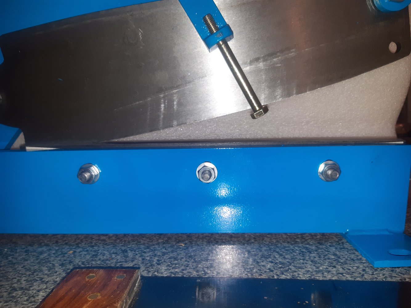

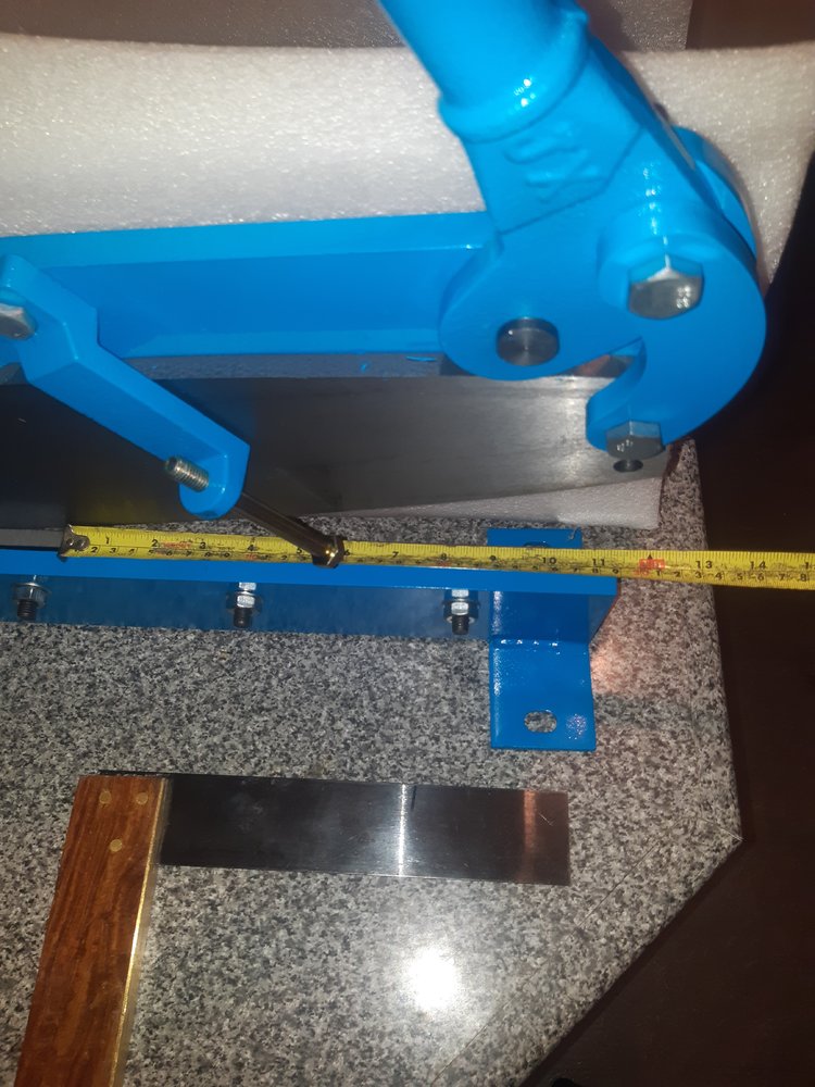

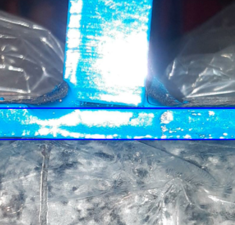

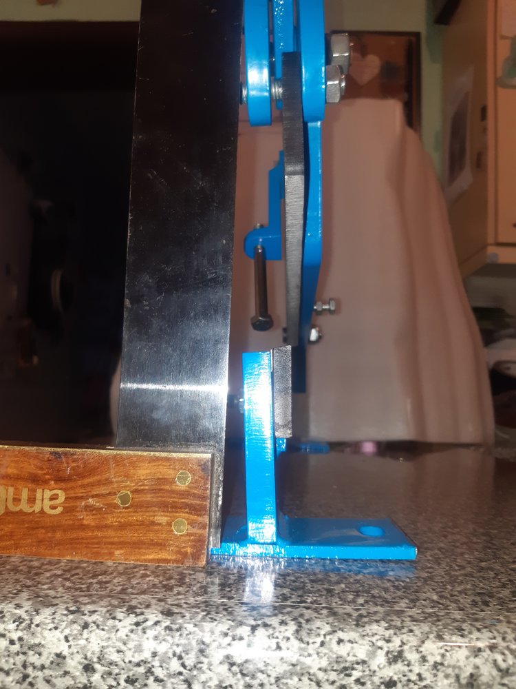

That has been welded without being tacked or clamped. Right hand side (in above post) done first. Distorted to right then left hand side welded without any attempt to correct the lean. Absolute garbage. Not worth £60.
Welded to exactly line up with the existing bend you suggest??
