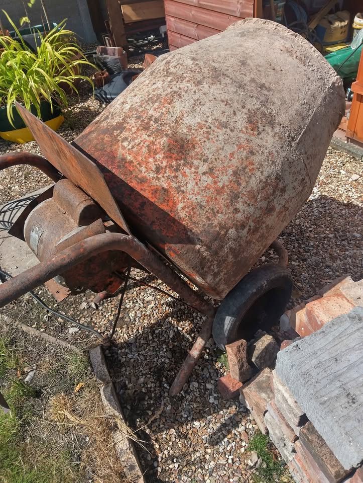

apart from all the cement still stuck on behind the paddles![]()

Just give the dried on mortar/concrete a well placed meaty wallop with a two pound hammer on the clean side of the paddle / bars , most of it comes off without any damage to the paddles or bars .apart from all the cement still stuck on behind the paddles![]()
it dont come off the paddles where there welded onJust give the dried on mortar/concrete a well placed meaty wallop with a two pound hammer on the clean side of the paddle / bars , most of it comes off without any damage to the paddles or bars .
borrowed mine out and had to use an air chissel to get most of it off without damaging it then shot blasted it out . needless to say no one else will get to lend itLearned my lesson about lending out too, post #16 .it dont come off the paddles where there welded onborrowed mine out and had to use an air chissel to get most of it off without damaging it then shot blasted it out . needless to say no one else will get to lend it
