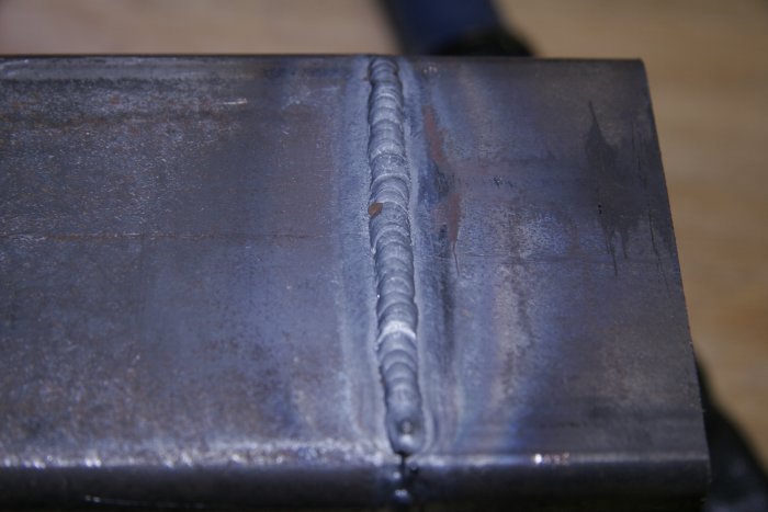

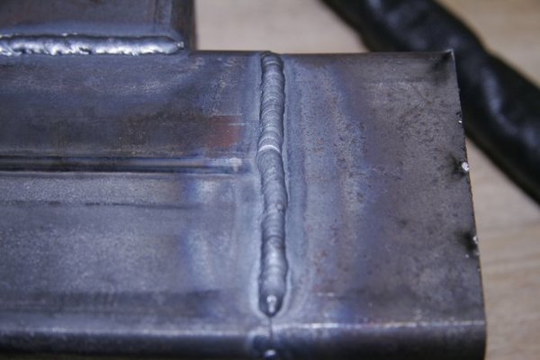

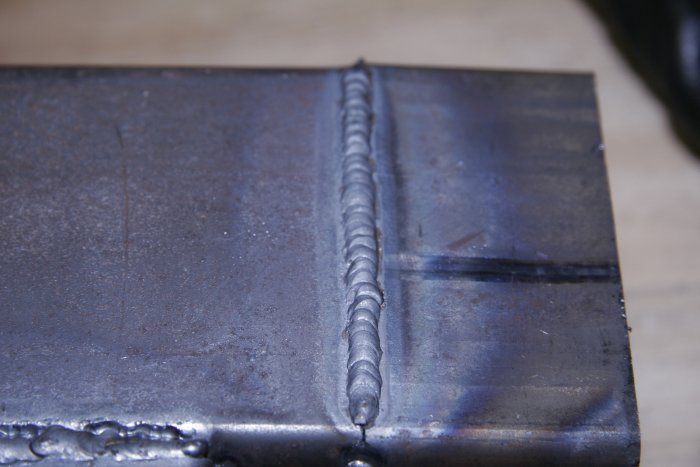

My butt welds were reasonably pleasing. On the 80x80x3 SHS I was practicing on I started off at 90 amps but ended up at 80 by the time I'd got round to the last face. I think some are a little proud and one definitely sank a bit!
I was a little worried I was giving it enough oomph but I broke one of the welds (visible in a later photo) and it seemed OK.

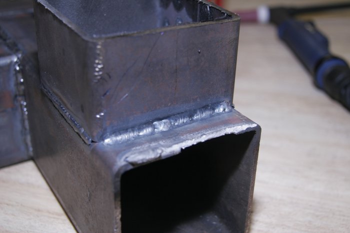

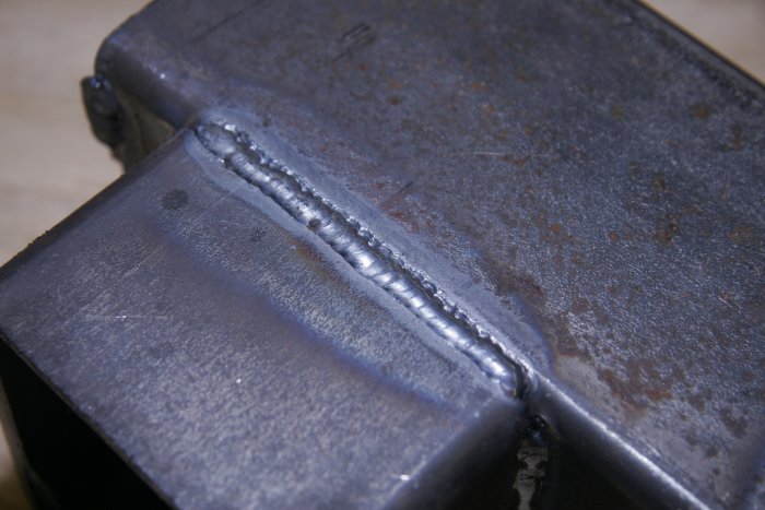

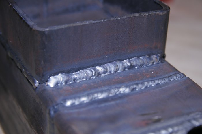

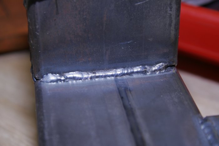

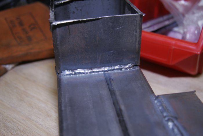

Next up was the fillet weld. Thought I'd give this a go without filler first off so as not to over-burden the grey cells. Here I found that once I'd got a pool that spanned the fillet I could move it forward though I kept getting ahead of myself and having to pause to get the pool going again.
After that I tried with the filler. Again, I ran into the problem of rod sticking to work. I had the rod laid flat along the fillet and was rocking the ceramic back and forward along the join. My cure was to twist the rod in my fingers as I pushed it gently into the pool but I can't help feeling I'm just not doing the weld right in the first place!

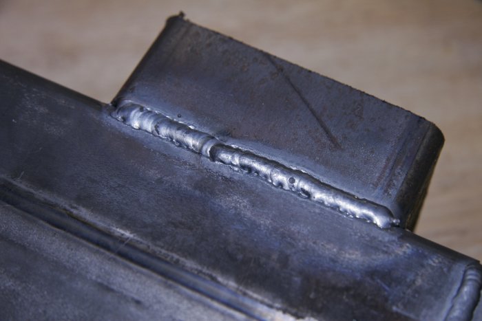

Finally I tried doing the butt welds left where I had welded to fillets earlier on only because of the radius on the tube corners there was a large gap. TBH, these felt reasonably easy but I was interested to notice that there appeared to be quite a bit of undercutting on the corner of the tube. This had me baffled as I'd have expected to have had problems melting the edge of the other side, not the corner. Anyone brighter than me able to shed any light on this (chortle, chortle)?!
