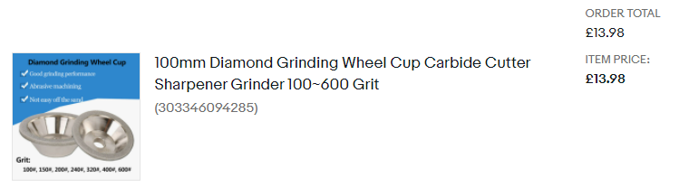

For sharpening I used to use a 4 1/2 inch grinder and a flap wheel. Takes a while and destroys the flap wheel after a while but it does the job. I use as Dremel type tool now with diamond wheels, spinning the tungsten in the cordless drill and this gives a nice grind without any really deep grooves so the arc start is crisp and it doesn't wander.
