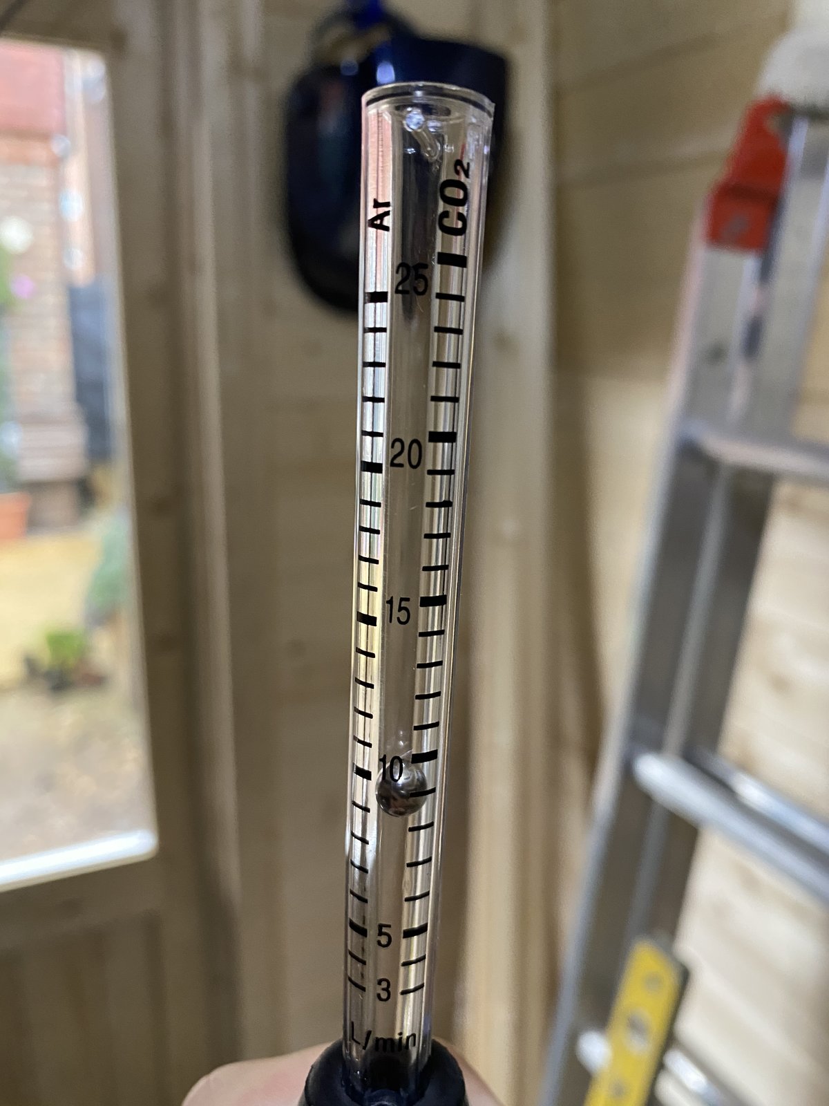

Set the flow meter on the regulator a tad higher than you want, put the peashooter on the torch and fine tune the flow at the torch by using the knob on the regulator mounted flowmeter, look at both readings, if they are about the same then all should be well, if there is a big difference then you could have a leak or a blockage.
