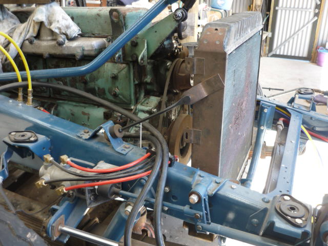

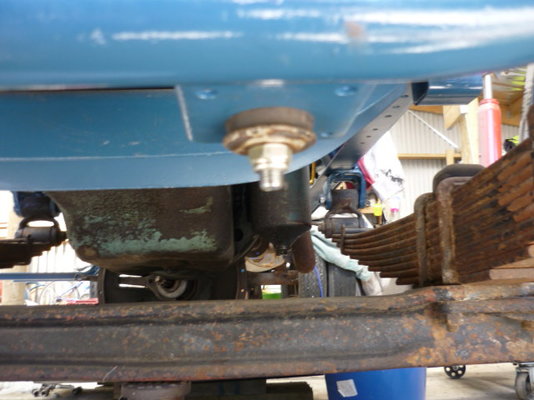

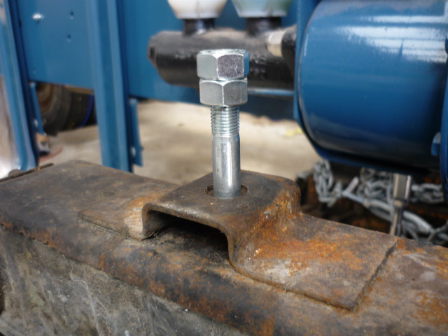

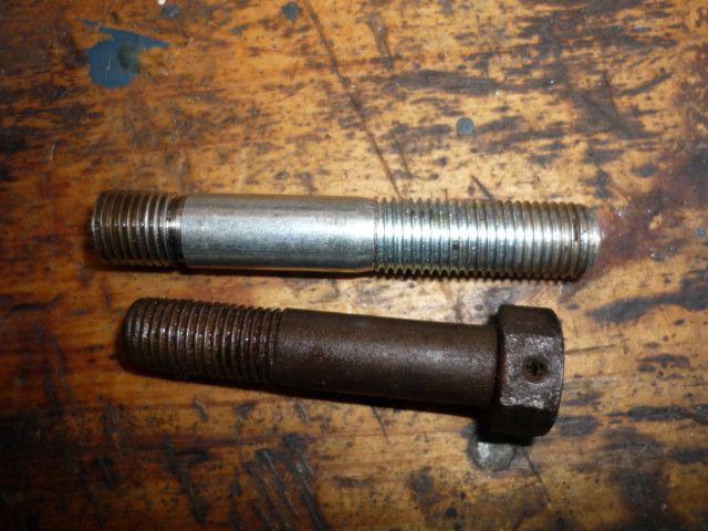

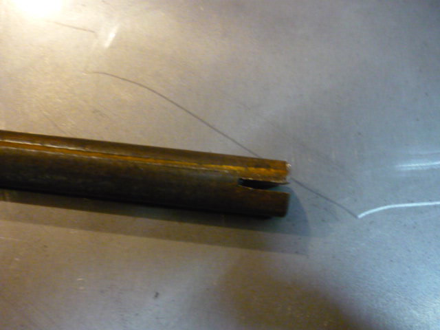

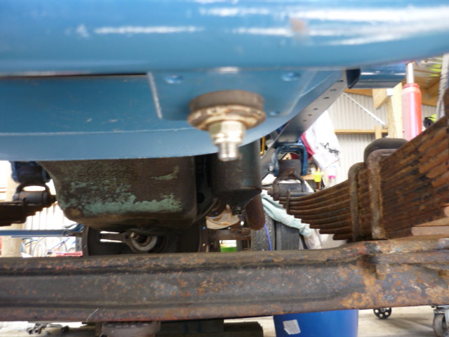

Not very interesting but progress never the less. The Radiator sits on rubber bushes and a pair of bolts that were lock-wired to keep them from turning. It was tricky to line up the holes from underneath and easy to start the bolts cross-threaded so I made a couple of studs by turning down some bolts
These could be locked in place
and then the whole thing dropped in from above with nylocs instead of lockwire

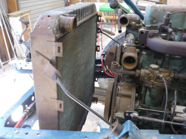

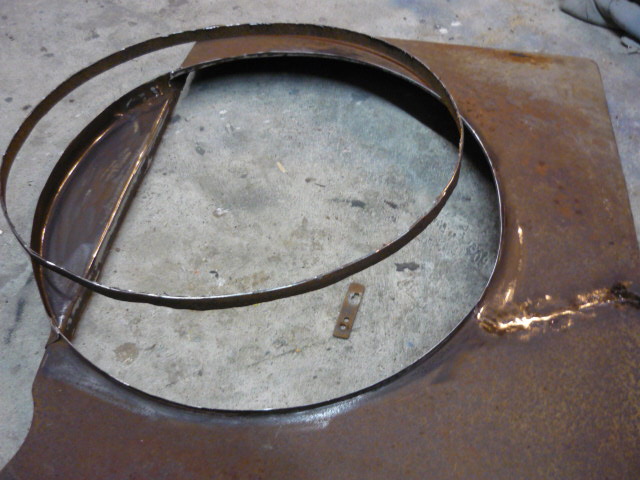

The top of the radiator has two steady bars, also on rubber bushes
