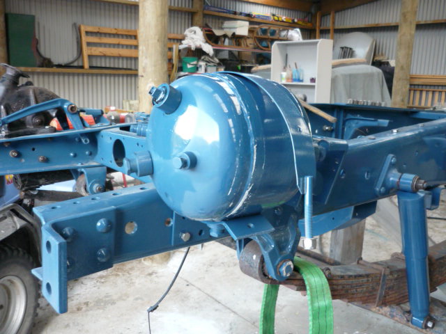

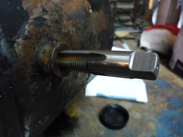

Anyone know what thread those fittings will be? I had assumed NP because of the GM connection but the guy from the truck parts store reckoned more likely BSP

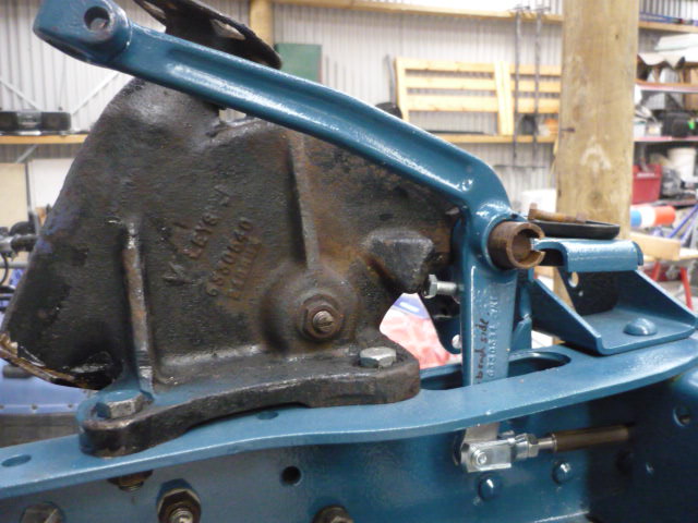

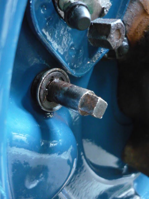

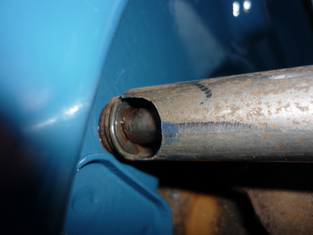

The original clutch mechanism was simply a bar joining the pedal to the release lever and was fiendishly heavy: you had to brace yourself against the seatback to move it. I picked up a new air servo on ebay some time ago; I think it's a Man Diesel part
This servo is operated by hydraulics so the pedal needs to activate a master cylinder instead of the old push rod.

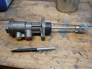

I picked up a master cylinder and clevis from these people carbuildersolutions.com
This has (I think) a bore and stroke that will match the servo.

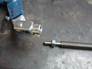

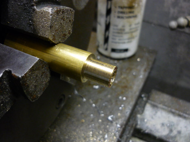

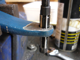

The original clutch pedal needed bending slightly in the vise and thinning down to accept the clevis. I reamed the hole out to 7/16"

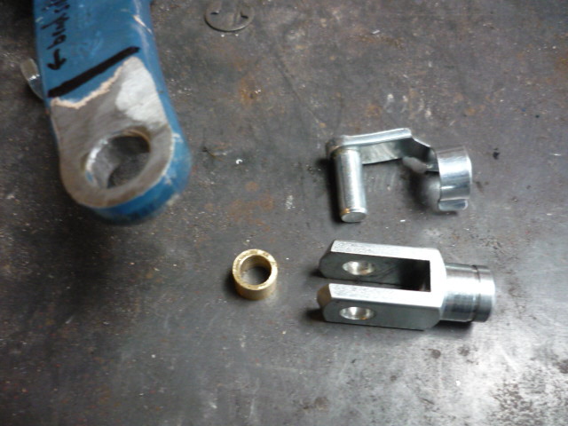

and made a brass bushing for the clevis pin
Quite a milestone actually because it is just about the first successful thing I have made on my lathe!

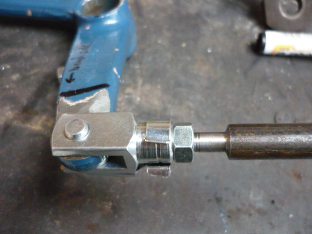

The spring loaded 'captive' pin for the clevis is a really neat idea: much easier than messing about with split pins.
So flushed with success I made a steel pushrod complete with 5/16" UNF thread cut on the lathe (woohoo!)

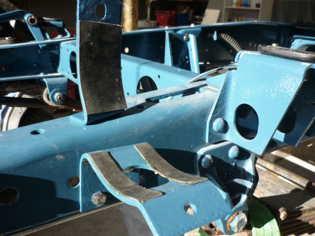

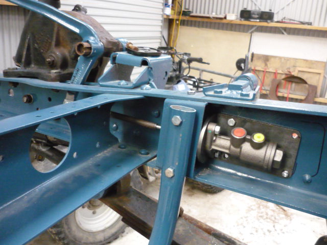

The whole thing sits on the truck like this, with the master cylinder tucked into the chassis rail.
I'm not sure that I have the pedal stroke correct but it will be good enough to get started. It's difficult to tell without the cab on and the other pedal fitted and so on.

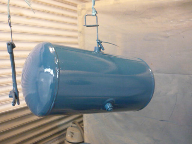

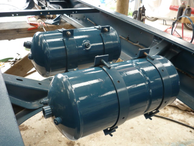

Did you manage to borrow an endoscope or some such thing as a tiny web cam with LED lighting and have a look inside the tanks .. it would be a pity if you get it all re built and the air tanks are internally rusted to a dangerous state .
It would be sensible because of the age of things to do that and also to get the tanks pressure tested to about 210 psi . ( fill a tank with water and with it behind a safety wall pump it up to 210 psi ensure it holds the pressure for three min release drain and place some where to warm to evaporate the majority of water left inside then spray in a water displacee cum protector film like WD 40 to get a light oil coating inside .
