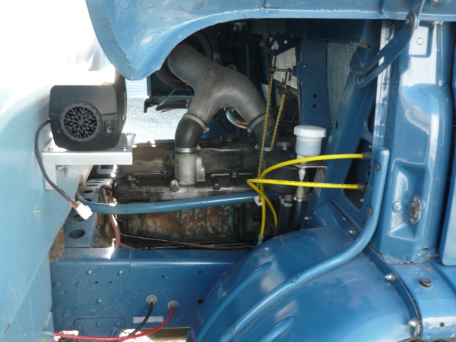

Seeing the guys are now using these to heat their sheds as wellNothing of great interest but fitting a 4kW diesel heater. Having no insulation whatsoever it gets a bit chilly in there in the evenings.
It's Chinese knock-off a German heater and about one third of the cost. I haven't run it yet but first impressions are good.

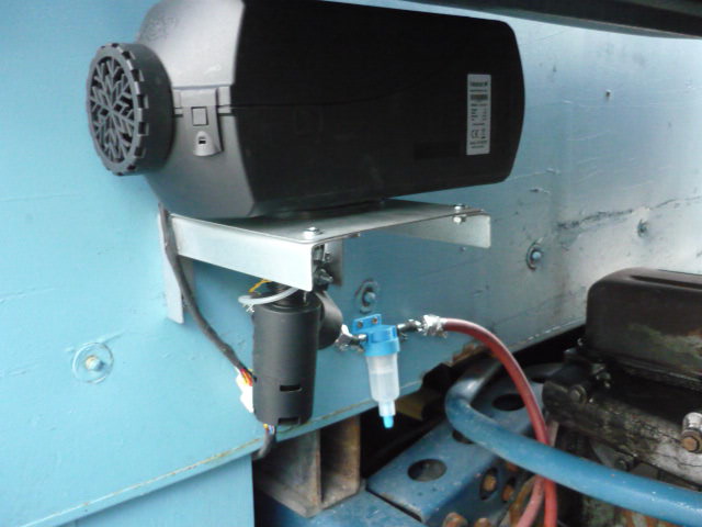

Sitting it behind the cab keeps it dry and it is nice and close to the diesel lines.

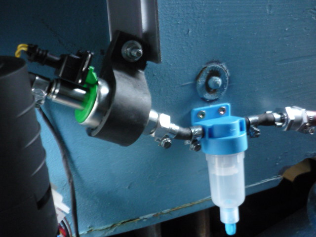

Temperature is controlled by an electronic controller and this little dosing pump and on the far right you can see the non-return valve that I fitted so that a fault in the heater can't stop the truck from running.
