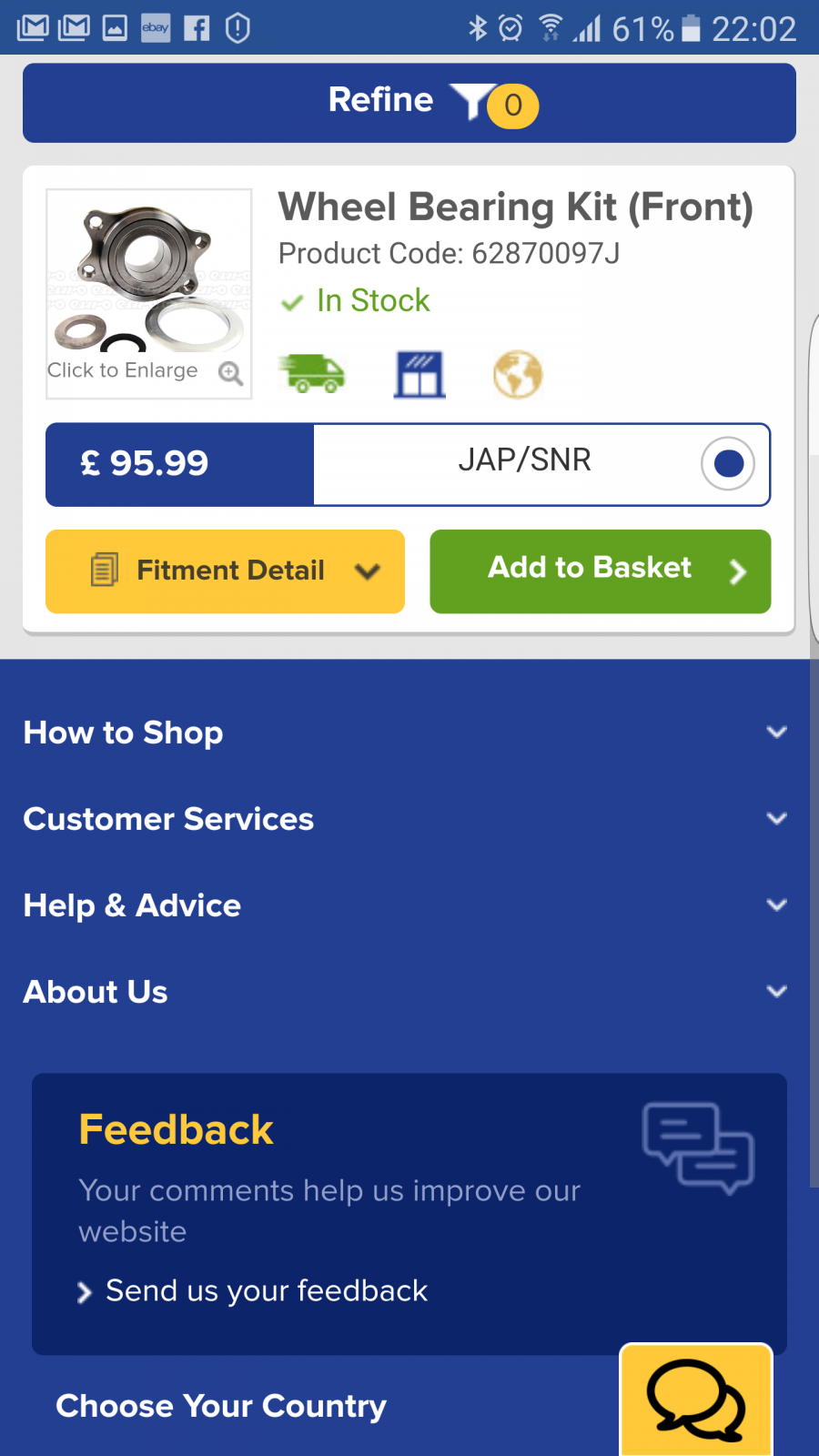

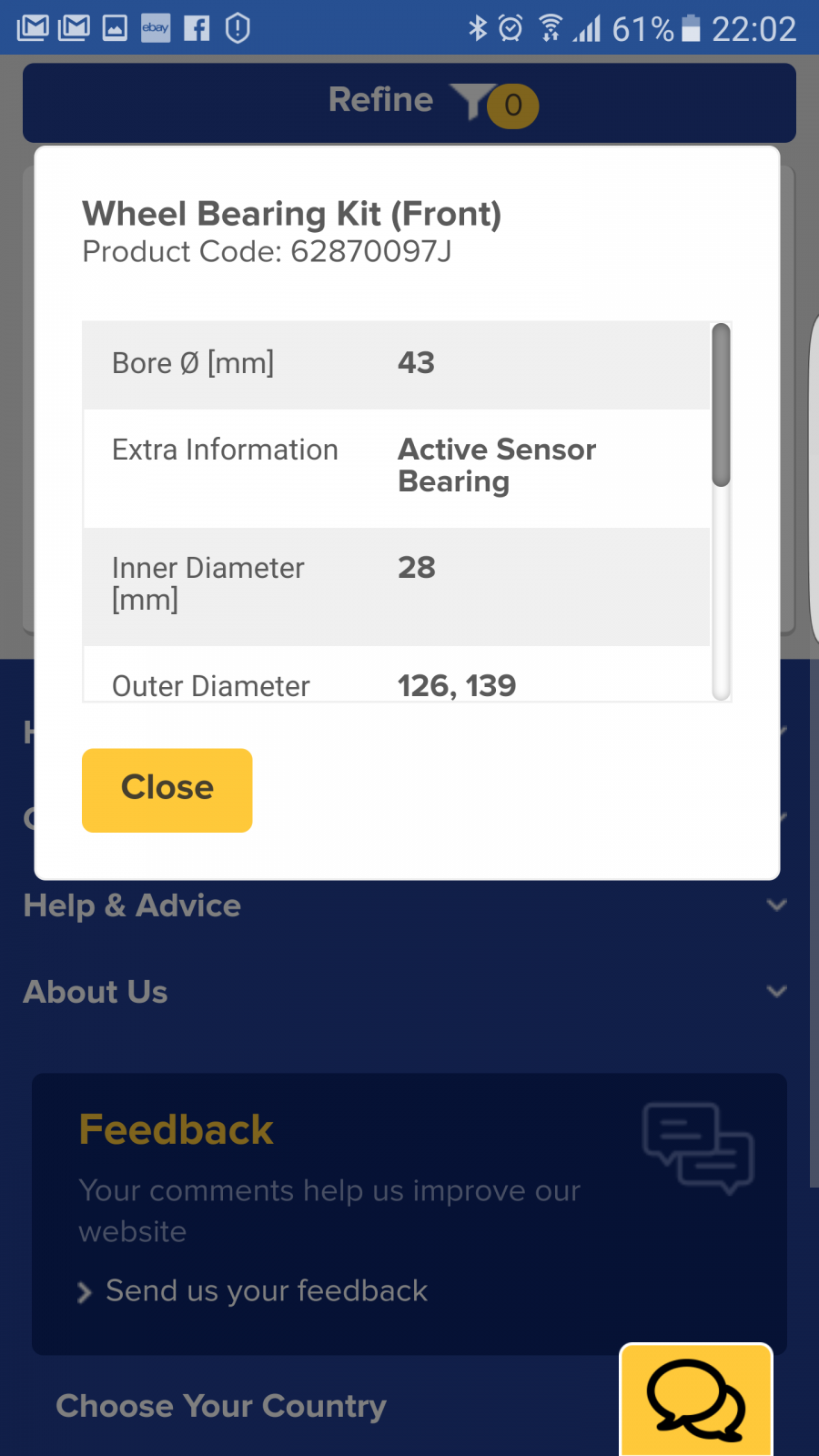

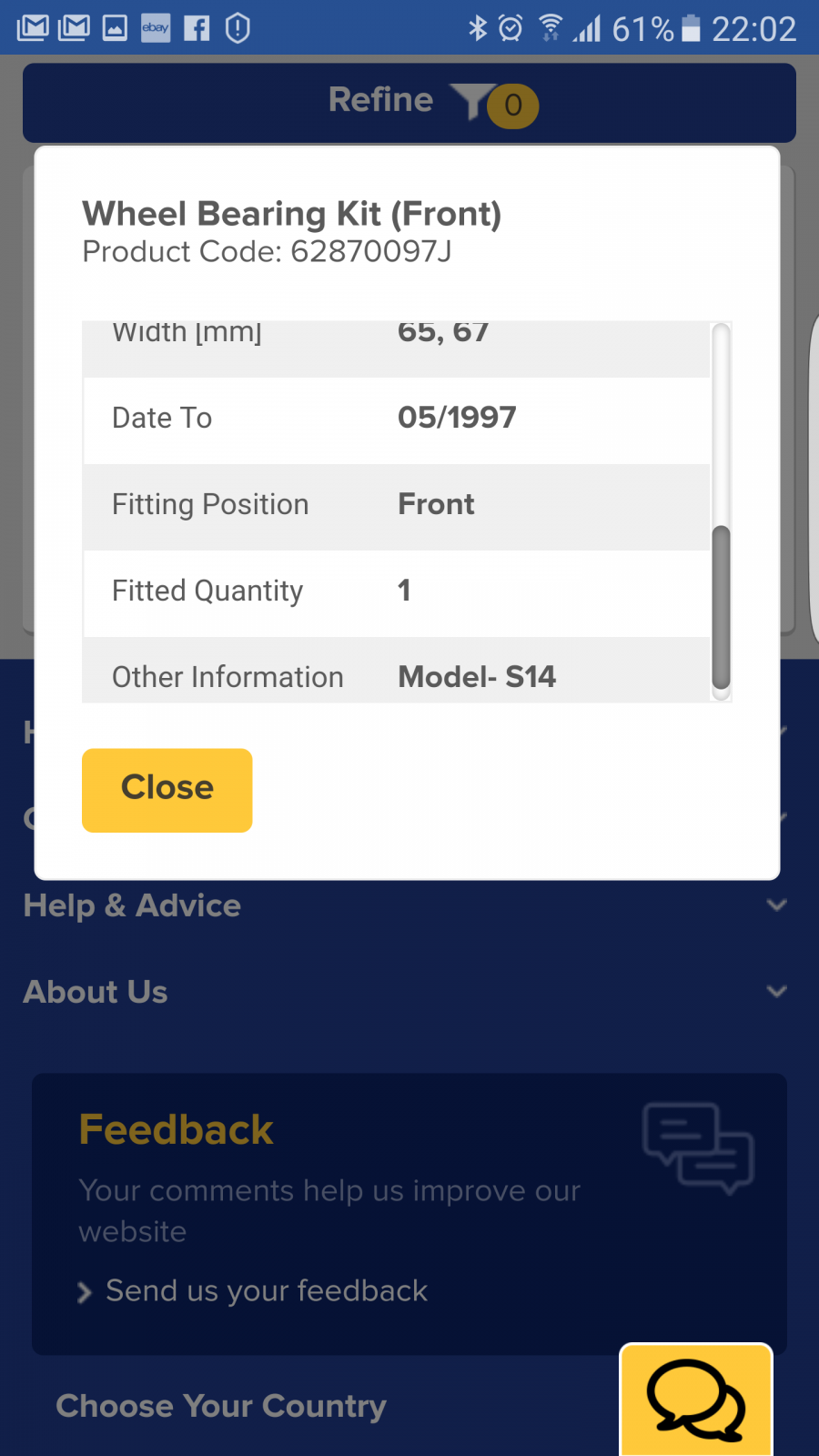

Sadly as we have found out they now have a monopoly and they all sell then for 150 a side which IMHO is taking the ×÷=%_ for a couple of bearings.you cant get bearings for s14 front hubs, they come as a complete unit with the drive flange. you cant just swap in new bearings to your old hubs either trust me.
slide motorsport/garage D were selling them for about £120 each a while back.

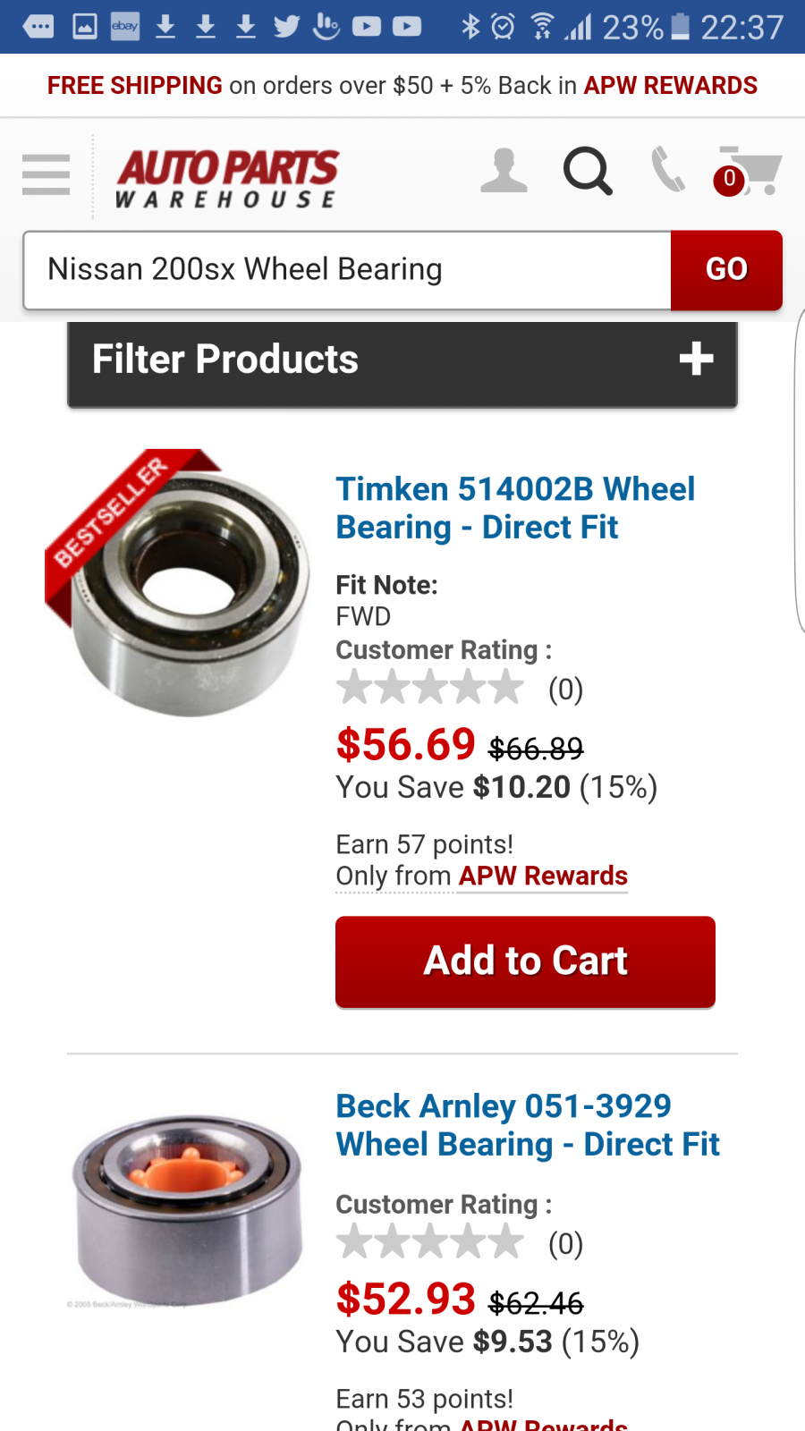

That was the same for 205 rear brake drums, bearings not available and new drums were needed.
I found out if you press them out, they had a ID number and we had them matched.

http://www.toolstation.com/shop/p89...=89691&gclid=CjwKEAjwgo6_BRC32q6_5s2R-R8SJAB7
