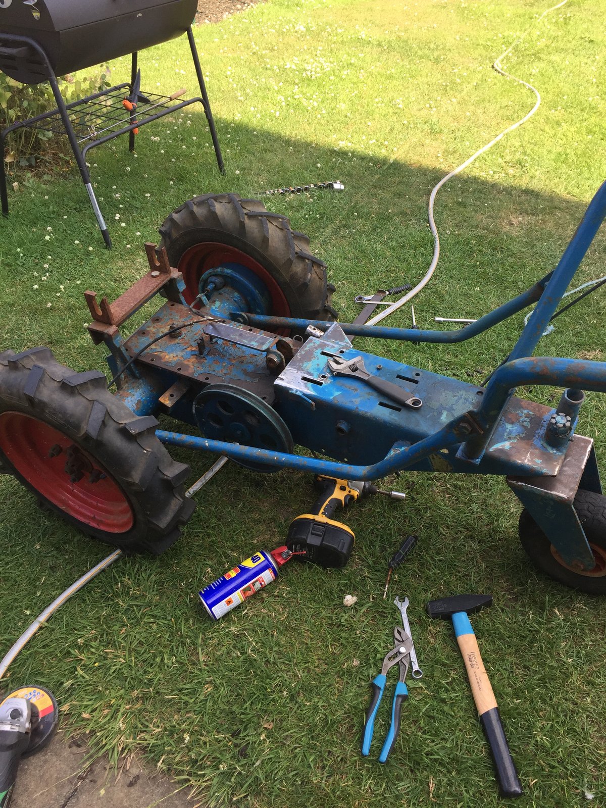

    Been looking for one of these for a while to help with some work I’m going to be doing here at later date, managed to pick this one up cheap, it has few issues but in knew that that’s why it was cheap.

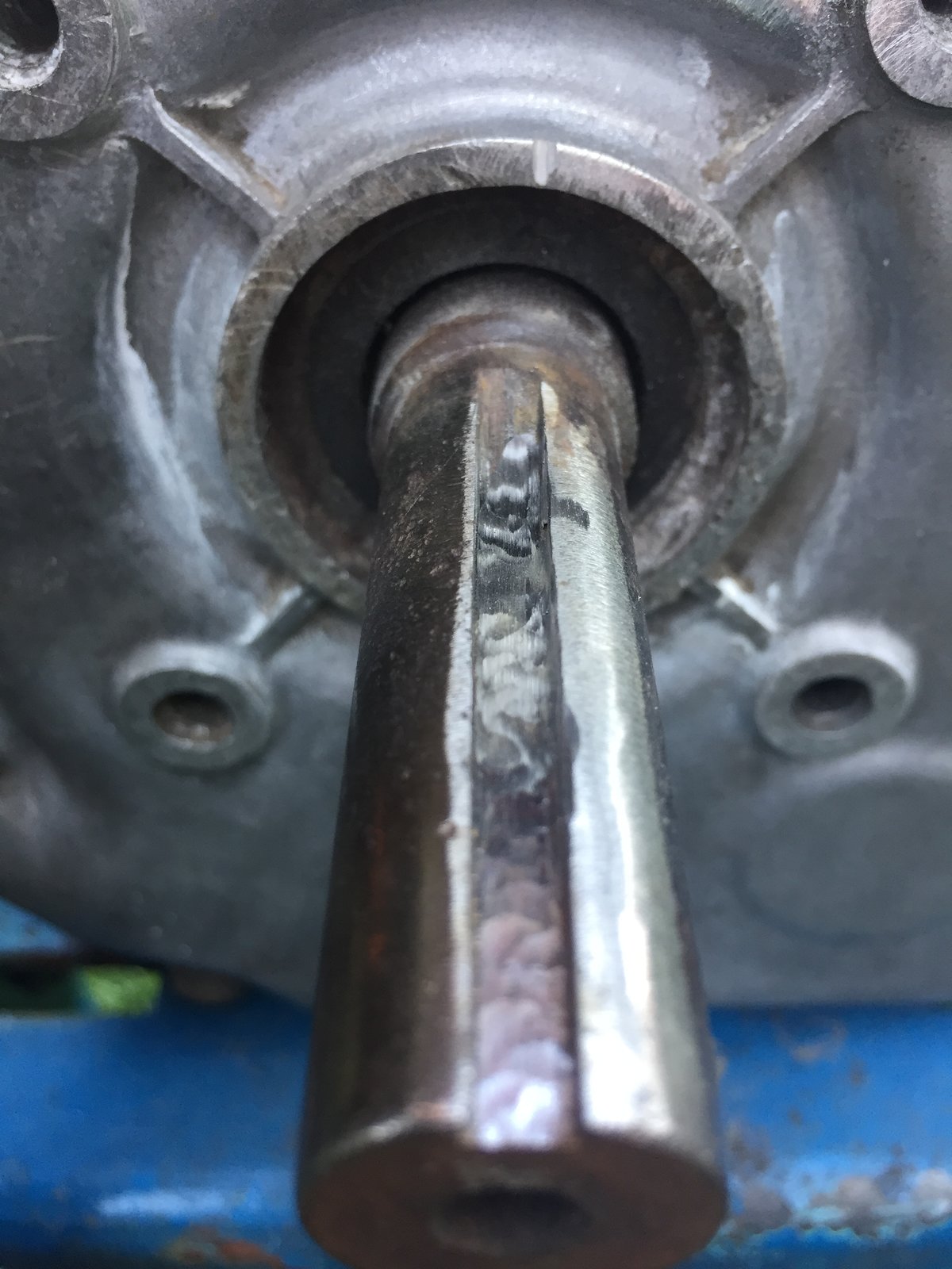

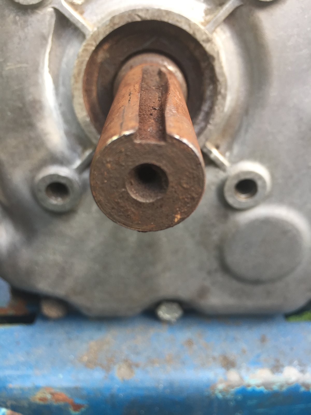

    Problem number 1 key way worn in the engine output shaft that holds the clutch unit in place.
    Cleaned it up, welded, ground out, filed, we will see how long it lasts

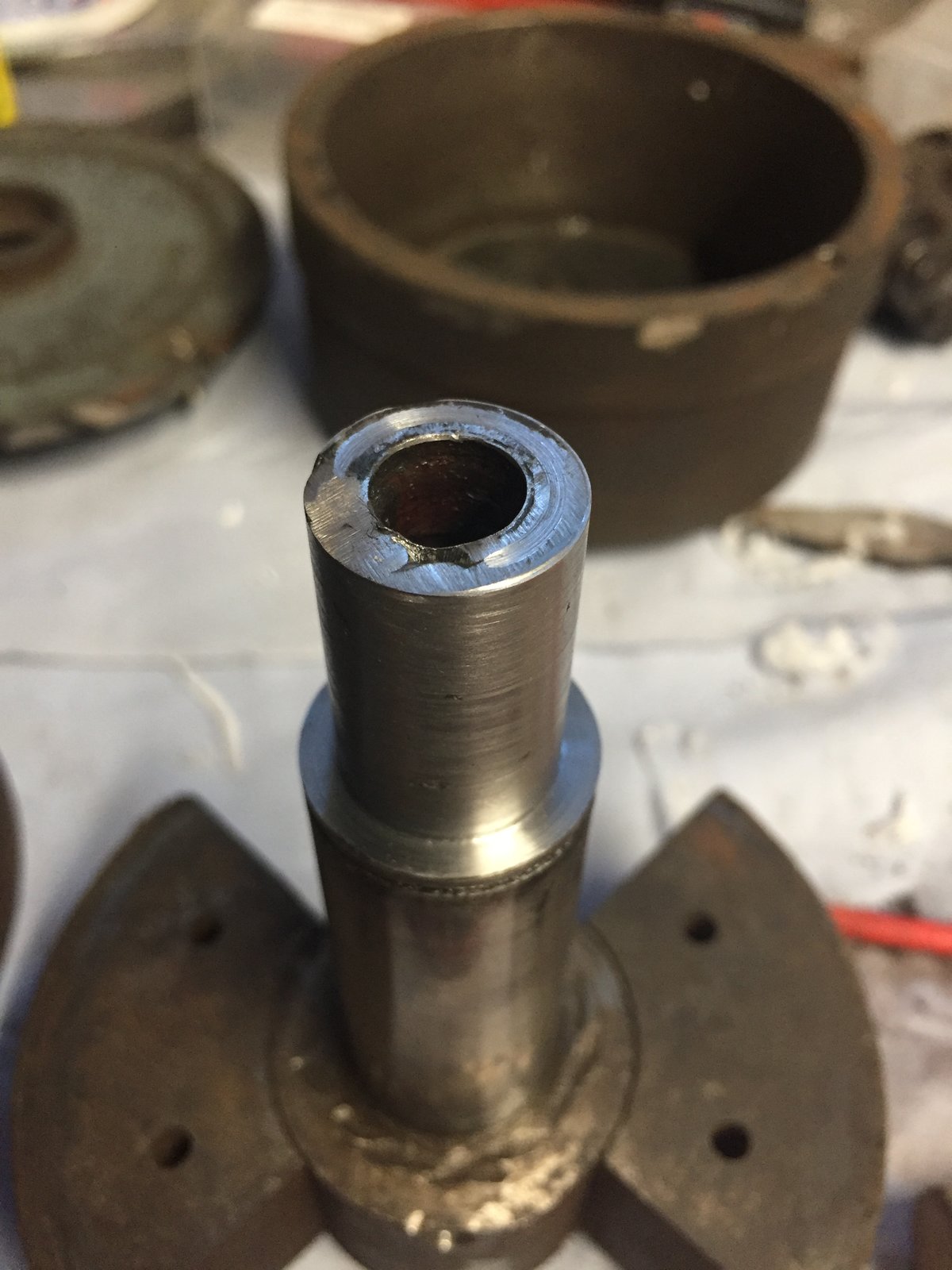

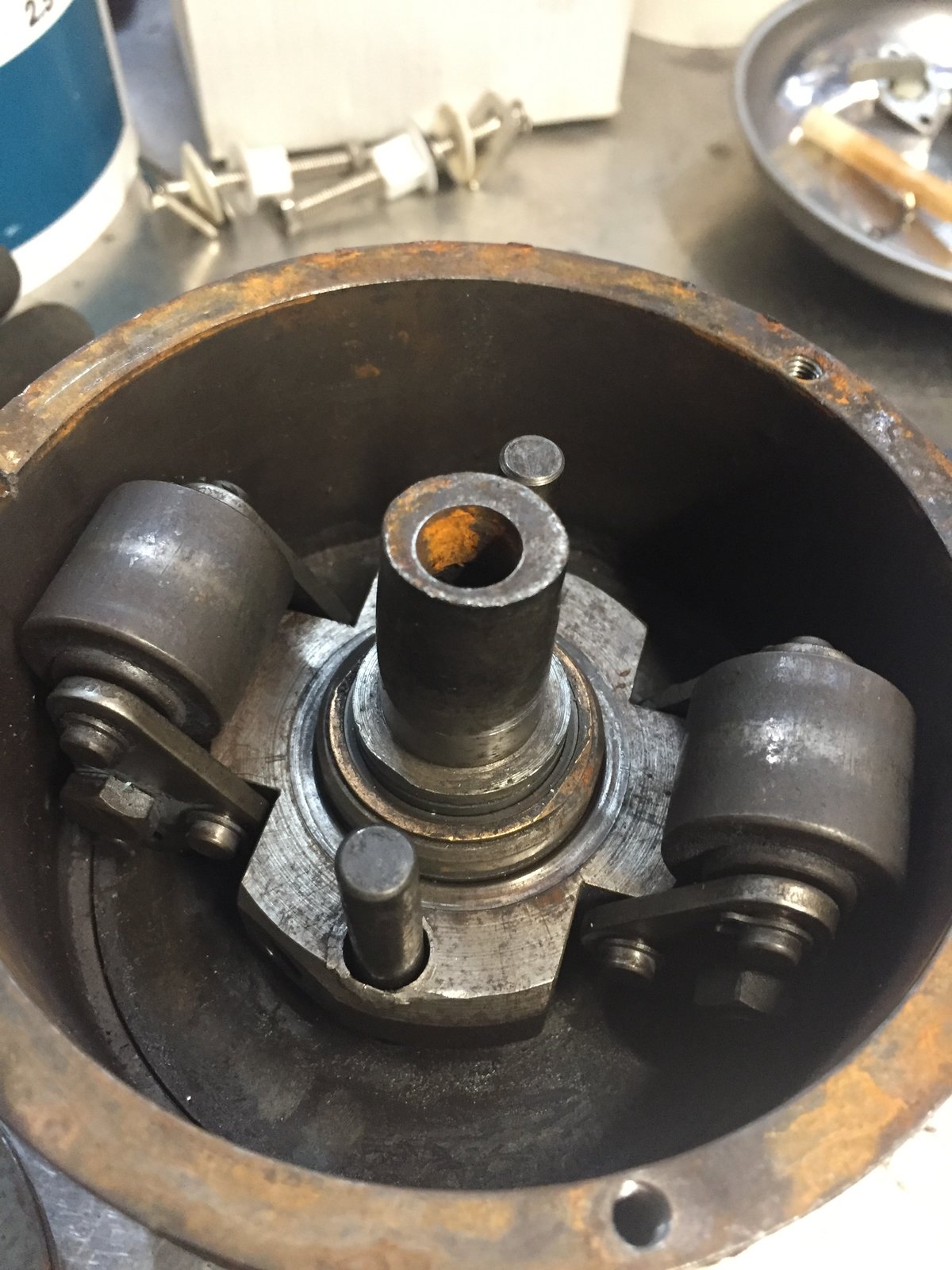

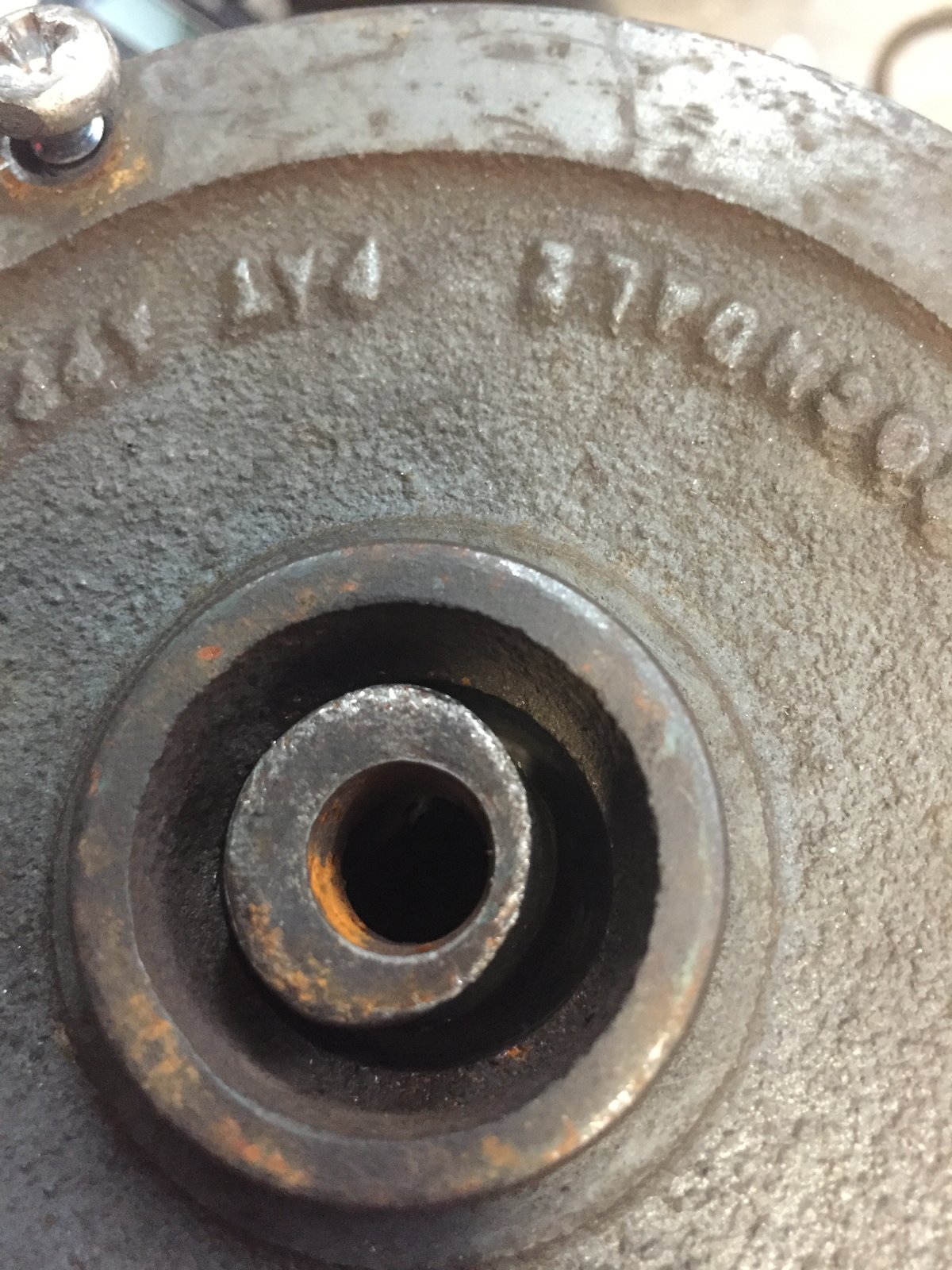

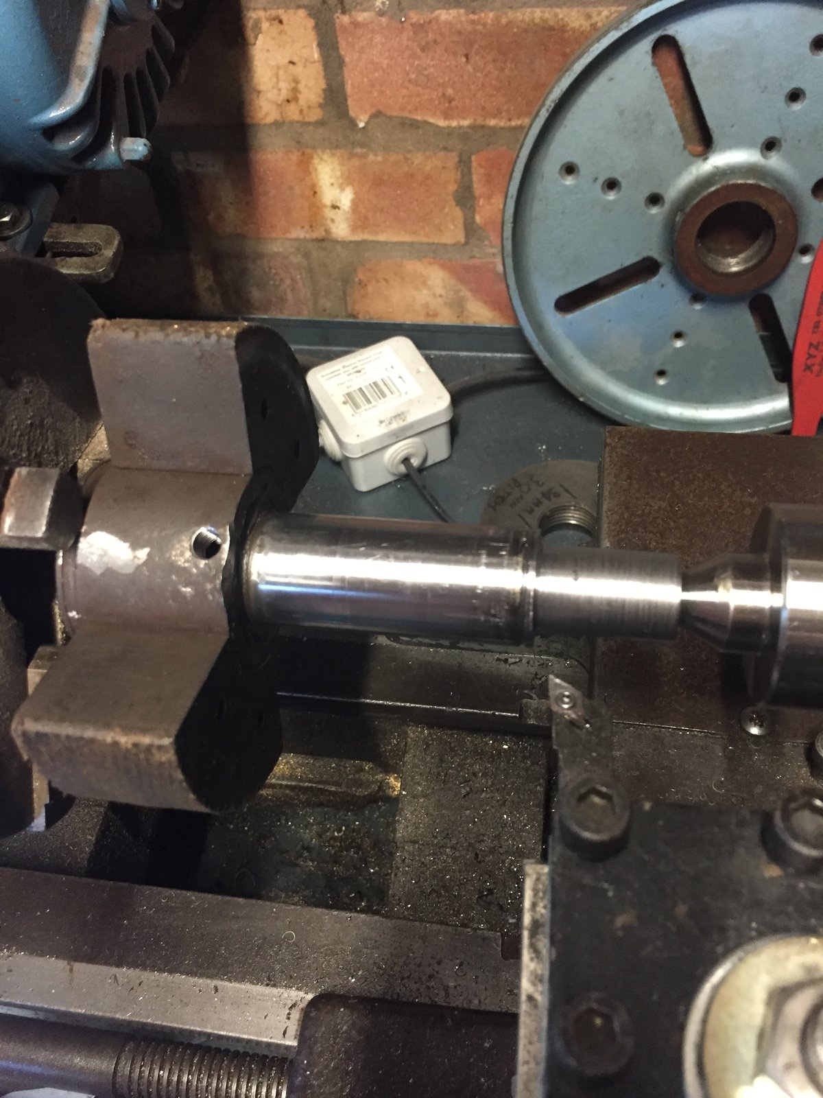

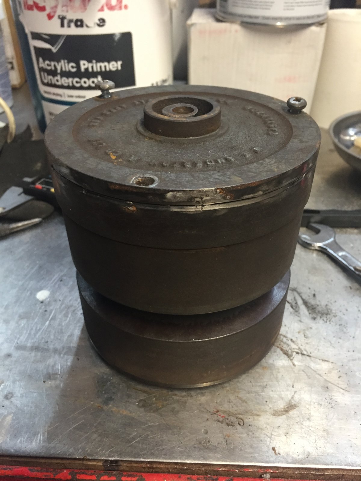

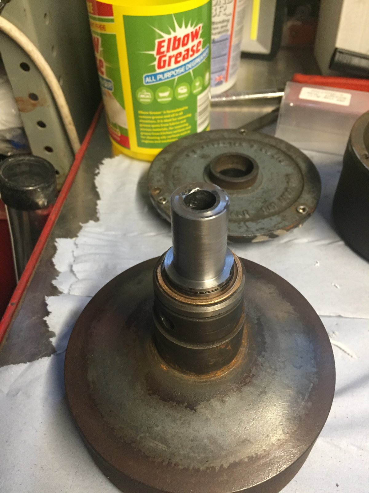

    Problem no.2 The main issue the torque converter/centrifugal clutch/variable drive unit is completely worn it has been got at a number of times, you can tell as it’s held together with self tappers and snots of weld.The central shaft for the torque converter is badly worn and 2 bushes completely missing.
    99750449-B4EA-4C20-8D5F-C757CE6F07AA.jpeg E4DA2A89-62B4-4DA3-9BD6-0B137FDB3679.jpeg
    So removed the welds , drilled and tapped the case to get rid of the self tappers, cleaned the shaft up with the angle grinder, built the shaft up with weld and machined back to something near correct.
    Now awaiting delivery of 3 new bushes and it can be assembled and tested.
    There is a bit of welding to do on the skip, I need to redo the fuel pipe and fit a filter, it needs an a air filter. I am going to take the top of the gearbox/diff and check in there and change the oil too. I’m sure there will be more, I will keep you updated if you’re interested.

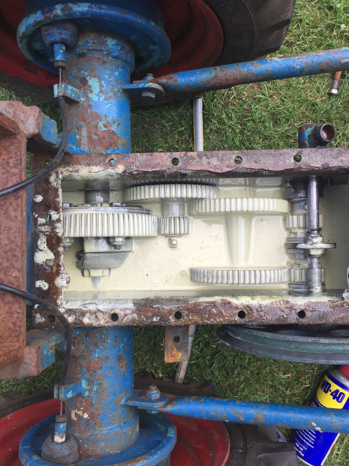

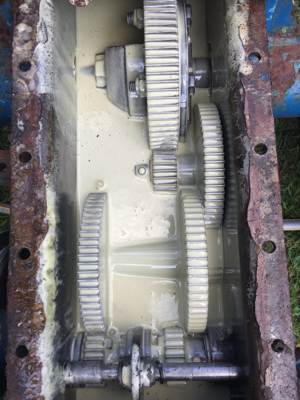

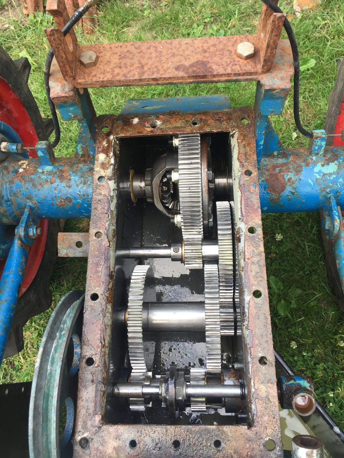

    Done a bit more today, started taking it to bits while I wait for some spares
    Prepare yourselves!, please confirm that the gearbox oil has emulsified and its not some 1970’s special gearbox cream that I’ve never heard of.
    What is best to wash it out with, petrol, diesel, paraffin ???
  10. angellonewolf
    angellonewolf Member
    Messages:
    5,655
    Location:
    bristol england
    water got in there ?to make it milky ?
    id go with petrol as its what ive got but there are better than me on this
    vw-al and stuvy like this.

    That’s better, 5l of EP80/90 on order.
    Need to make a new gasket next
  13. mike os
    mike os just a little insane.....
    Messages:
    6,998
    Location:
    North Wales
    Doesn't look bad in there
    Pigeon_Droppings2 and vw-al like this.
  14. vw-al
    vw-al Member
    Messages:
    99
    Location:
    Rugby
    Yea it’s not bad considering the state of the oil and the abuse it’s probably had over the years, it’s about 40 years old. Some of the teeth have a few marks on them and there is a bit of wear, with new oil and a bit of care it should last a few more years

    can i see a few metal bits in the bottem there in the pic ?
    vw-al likes this.
  16. Country Joe
    Country Joe Argoshield Dark
    Messages:
    1,673
    Location:
    Somerset - United Kingdom
    I thought there might be a bit of swarf left there in the bottom of the thing/sump/gearbox?
    But that would have been the most complex gearbox I'd ever (if I'd been doing this!) have opened - something would have to be so far beyond redemption, before anyone let me take any kind of engine apart - that I never have!
