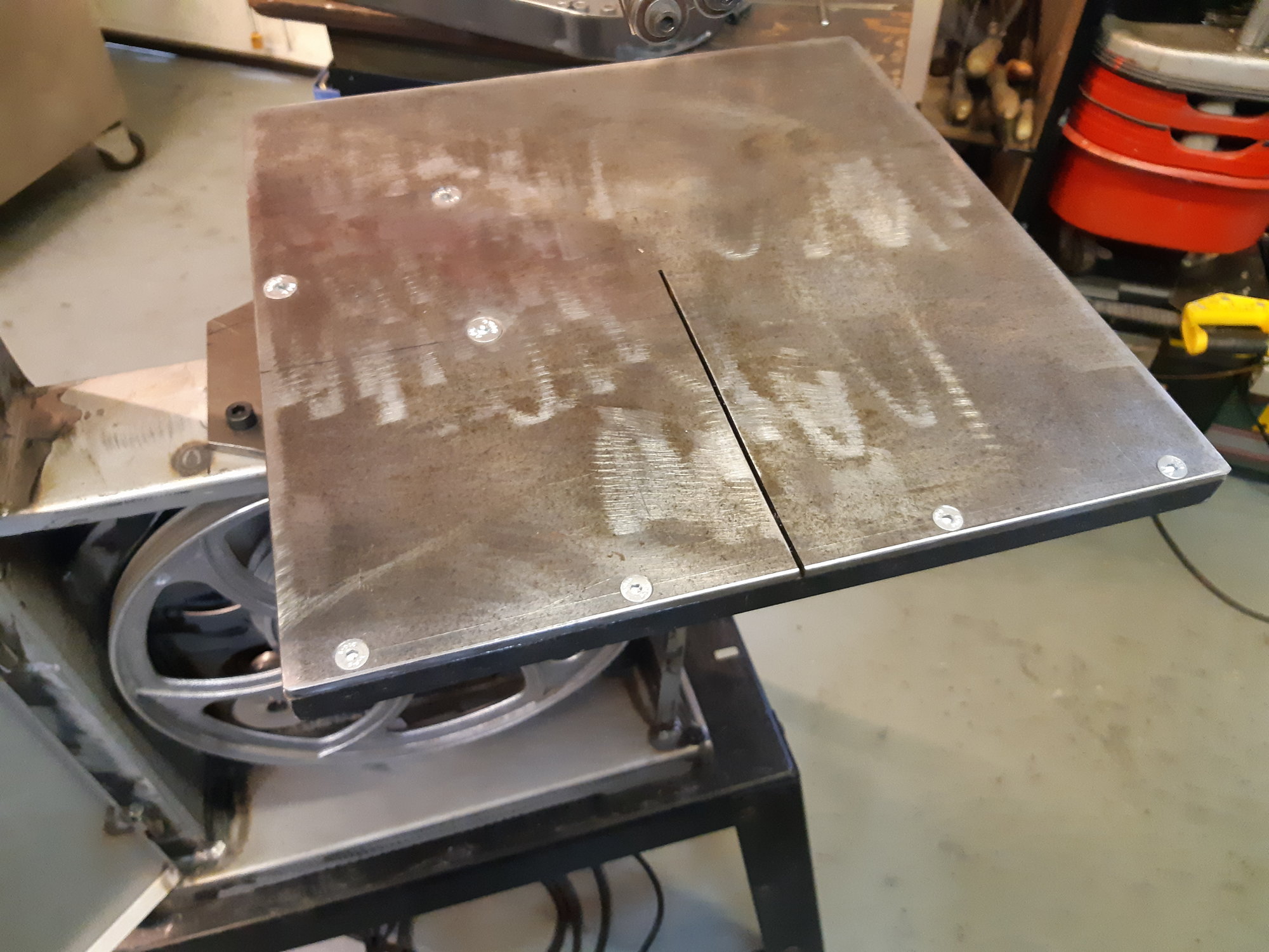

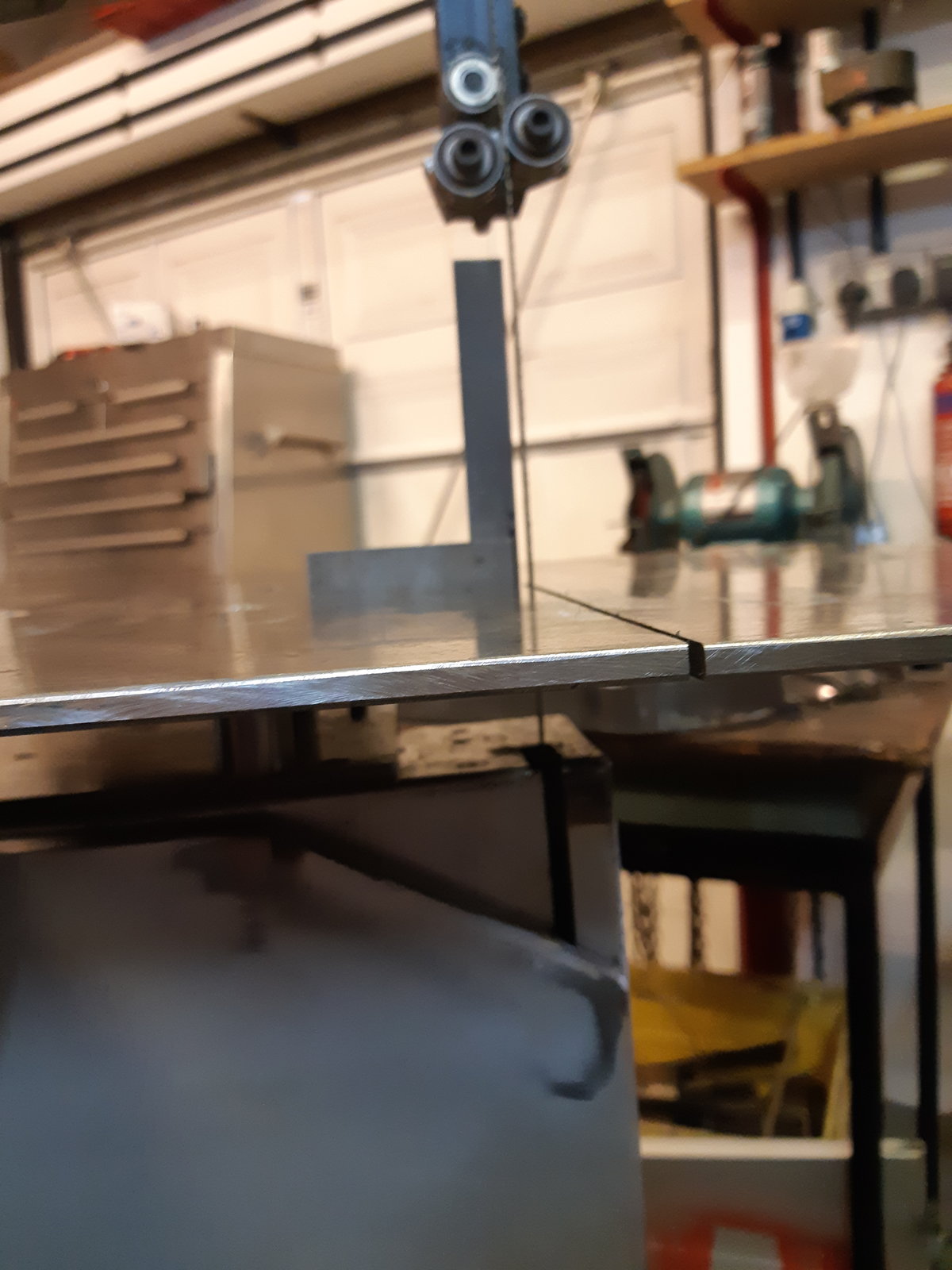

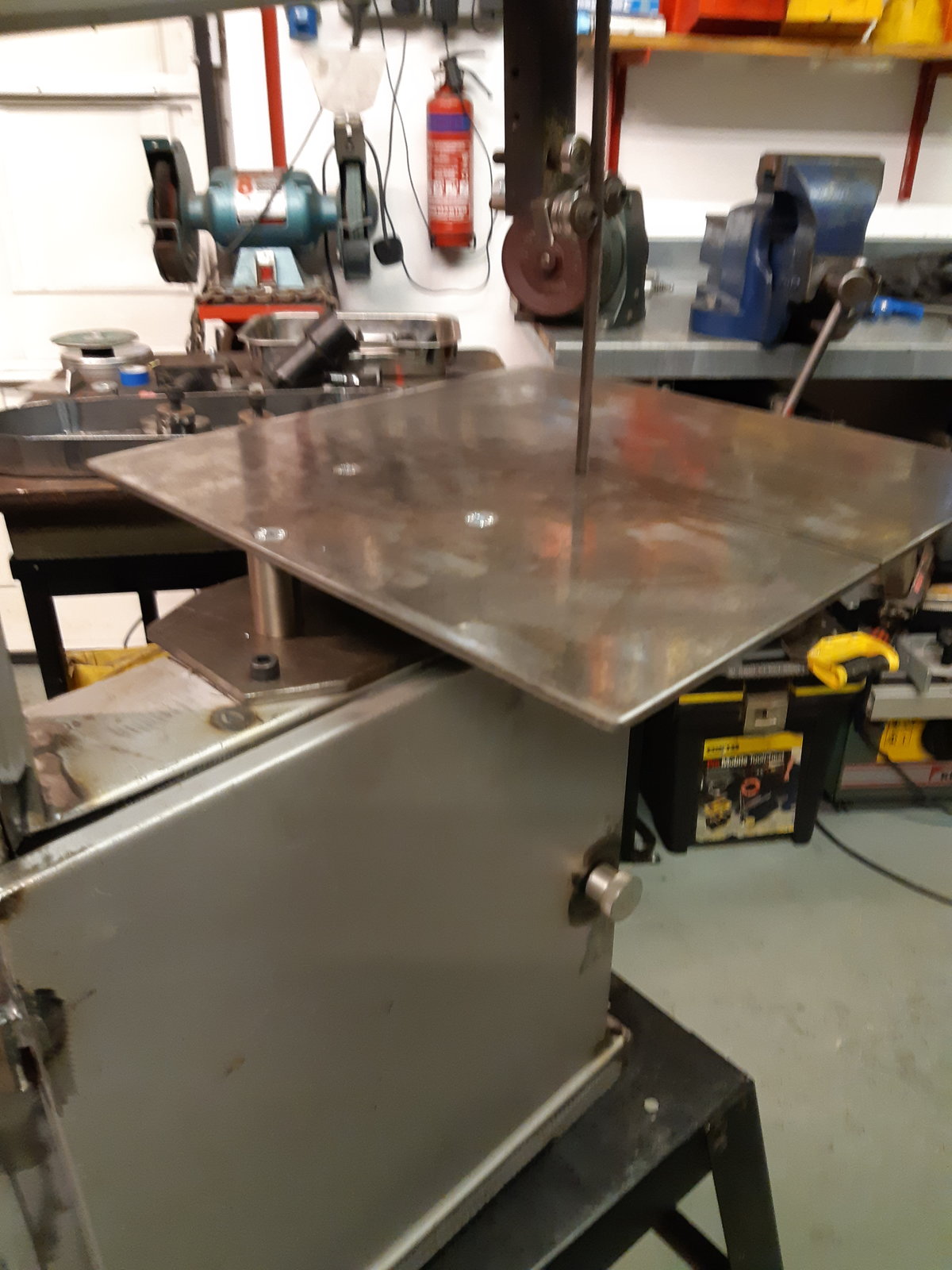

I have a similar Rexon nearly 15 years old , but mine is a two speed jobby , done by putting belt on a different lower pulley that is at the bottom of the machine. it's goo fairly heavy built but I've noticed over time the throat has closed up by about 6 mm and the blade does not run central to the cutting slot as a result .
Managed to jack it apart again with a bottle jack once I'd removed the table & guides . This time I've marked the blade tensioning knob abd always backit off thre full turns when I've finished cutting so there is no tension in the blade .
