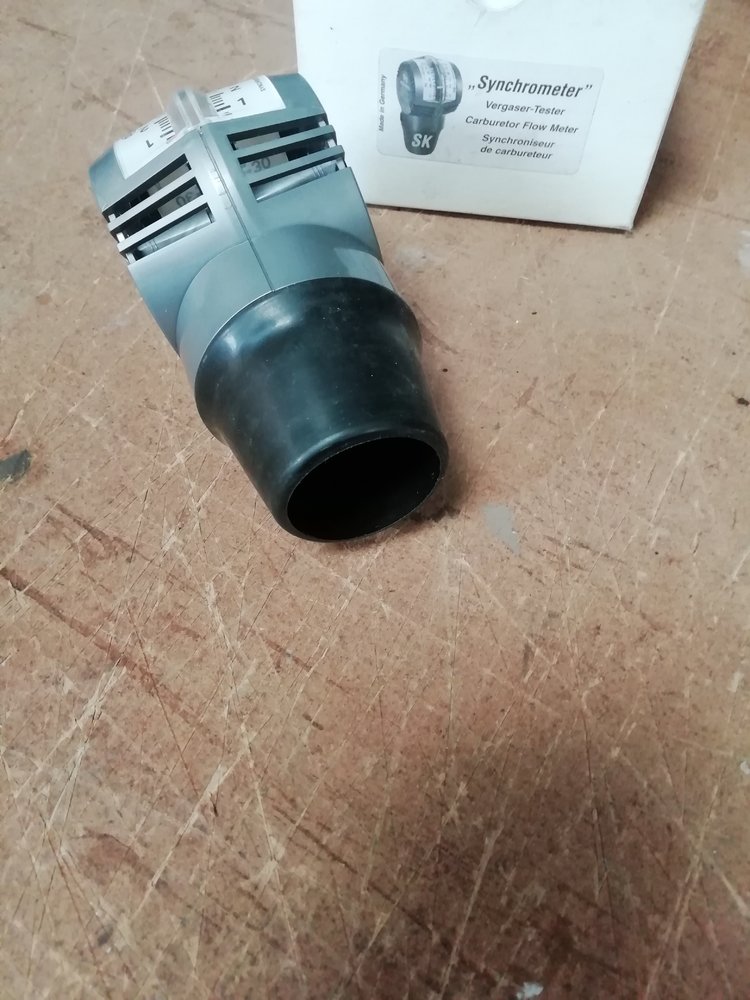

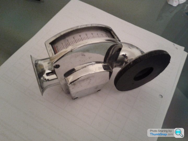

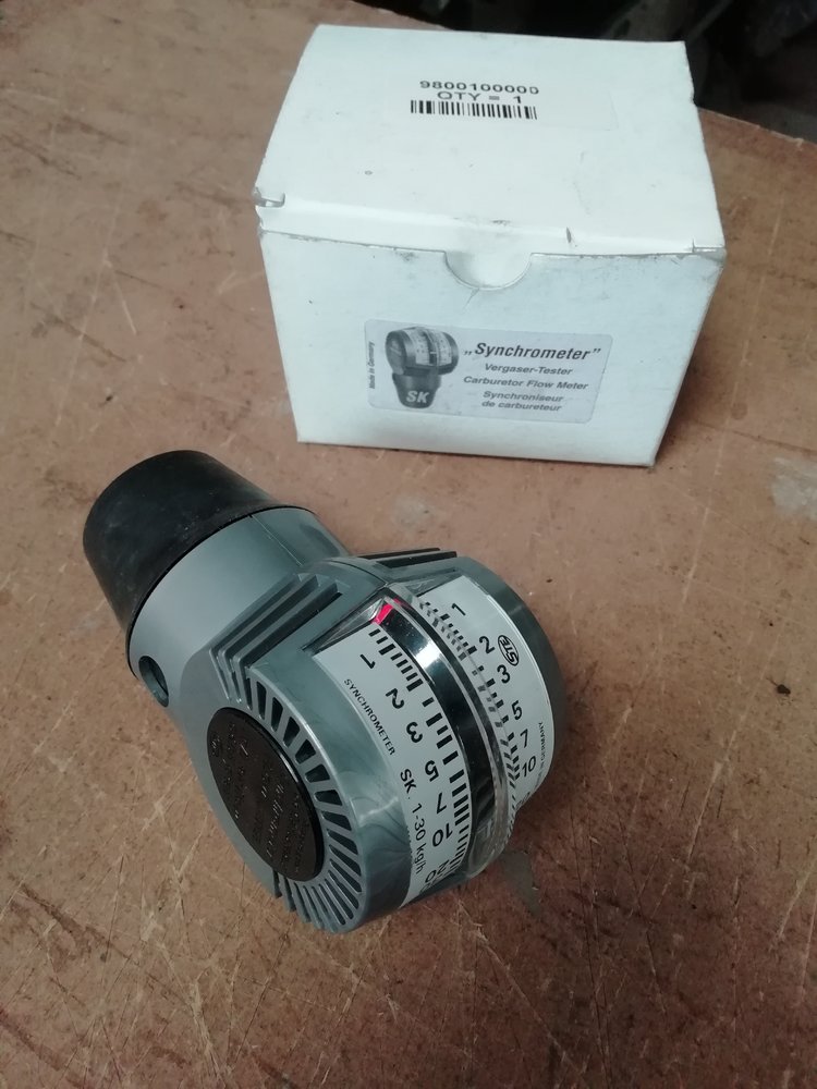

What's the alternative?Yes, but not needed in my experience, unless you want to save 5 minutes - less probably.
By ear?
Sigh ^^What's the alternative?
By ear?
Sigh ^^i

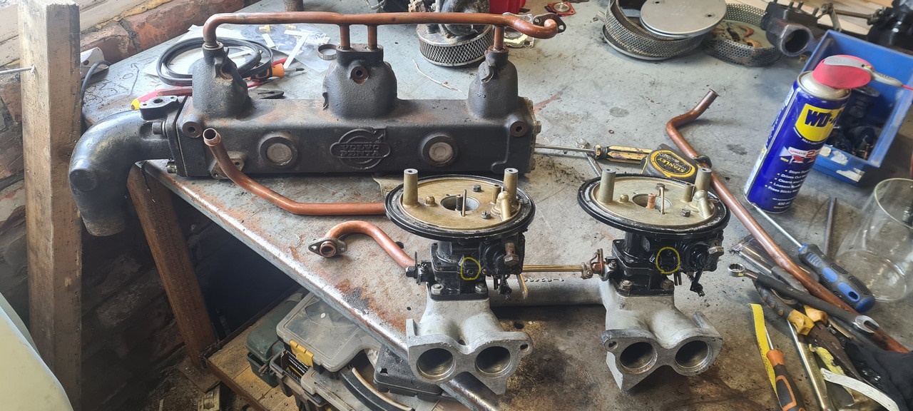

), as well as a couple of Jenvey throttle body set ups - and assuming the jetting is correct/needles etc, I've managed so far without anything other than the hose idea - cars have been checked and tuned on rolling roads, but I can't recall anyone complaining my balancing was off.Try a vacuum gauge and then tell me a rubber pipe stuck down your lug hole is betterI know attendees to this site like to over complicate, but flippin' 'eck.
If you've never done it with a bit of tube, try it. If you can hear the hiss, its surprising accurate way to do it - my mate turned up with a set of those synchrometer balancer and couldn't tell any difference.
Been playing with twin carb set ups, Webers, Solex, Dellorto, and SU since I was 18, 34 yrs ago (crikey), as well as a couple of Jenvey throttle body set ups - and assuming the jetting is correct/needles etc, I've managed so far without anything other than the hose idea - cars have been checked and tuned on rolling roads, but I can't recall anyone complaining my balancing was off.
Not when mapping for trialling use . . . lots n lots of partially open, in slightly increasing increments . . .Try a vacuum gauge and then tell me a rubber pipe stuck down your lug hole is better..carbs not balanced will not show up on a rolling road as its normally full throttle and main jets feeding fuel and not pilot jets.
Yeah, I've got the same issue - maybe spent too long as a youth with an angle grinder inside the wheel arches of old cars . . .Even with non stop tinnitus.
I'll balance my 4pot Kawasaki then I'll put the gauges on. I know my ninja is terrible with the slightest imbalance
always a good bit of banter goes on and different ideas.
