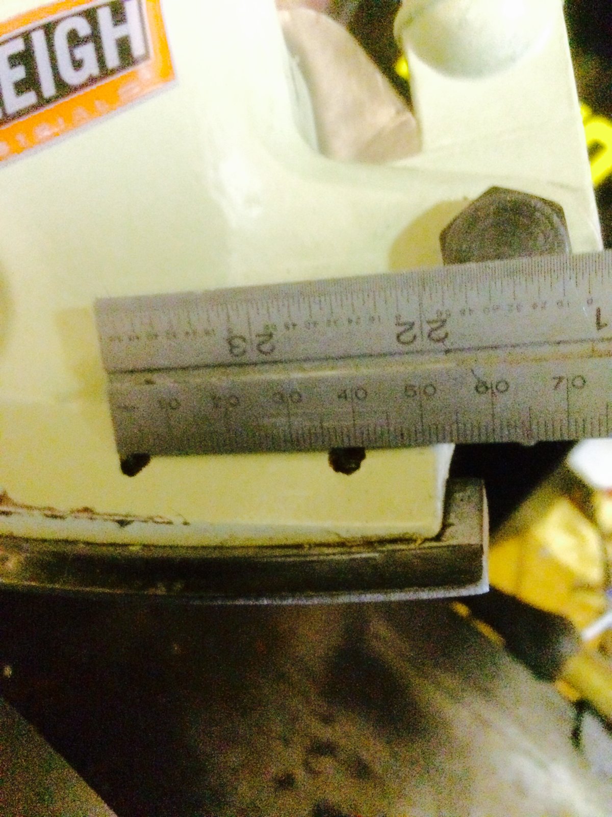

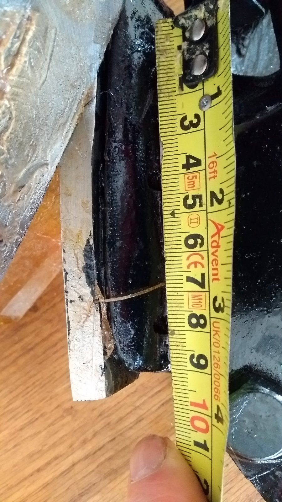

My blades measure up exactly the same apart from the top hole pitches may differ.No worries. It's still at home so measured with a tape and without my glasses but should give you a good idea. I could measure itmore accurately but am away tomorrow so would be next week.
Bottom blade: 100 x 33 x 7mm
Top blade: 125 x 23 x 8mm. 3 screws 40mm apart and front screw is 17.5mm from the front.
When you say 40mm apart are you talking centre to centre, inside to inside or outside to outside. Mine are 40mm from the very longest pitch.

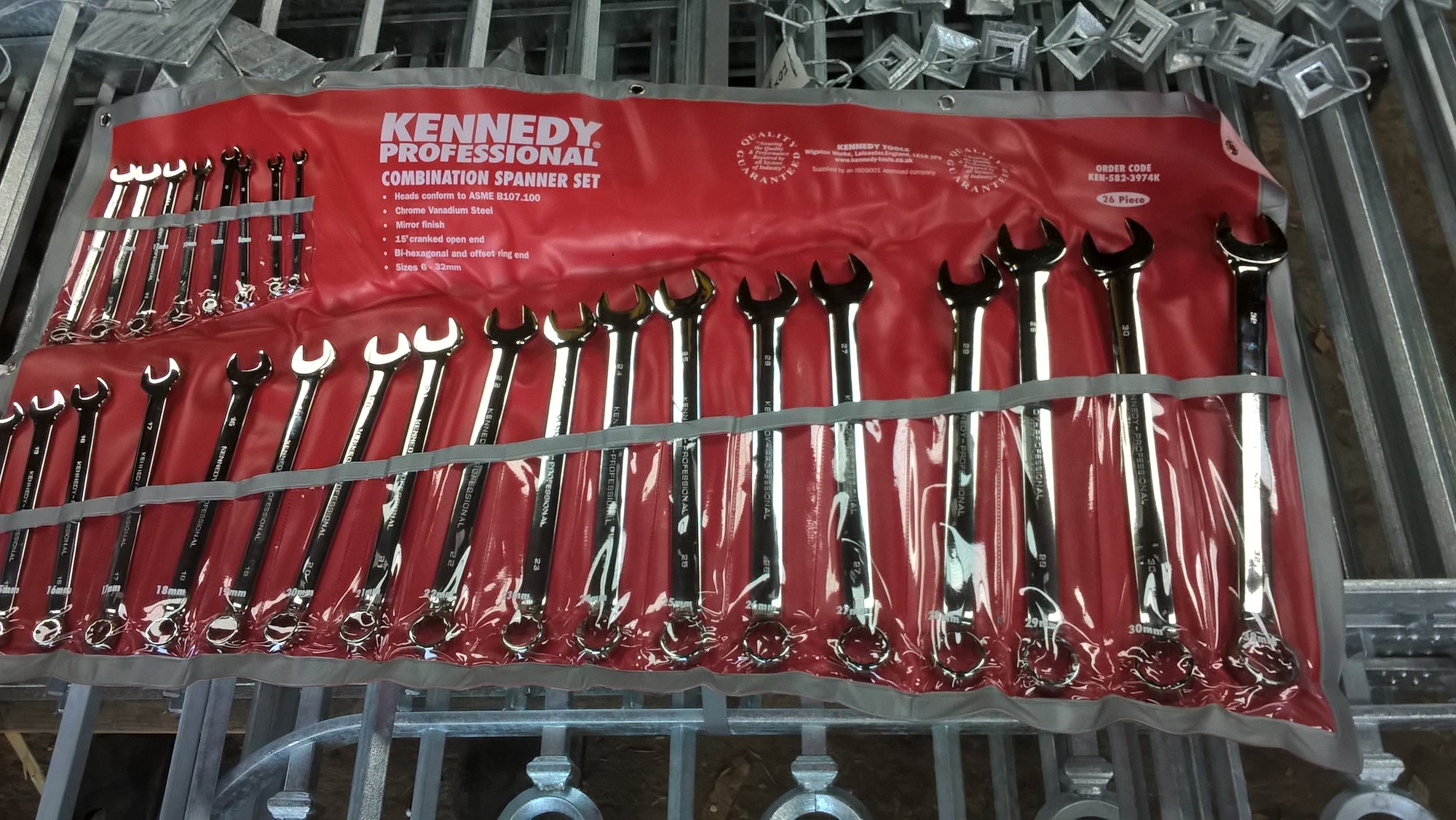

io bought the full set from bootsale cheap then realised 2 were missing a 22mm and a 24 mm cant remember the price but I think the pair of them cost me about 24 quid
