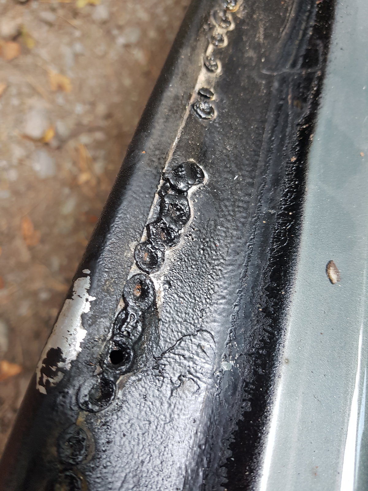

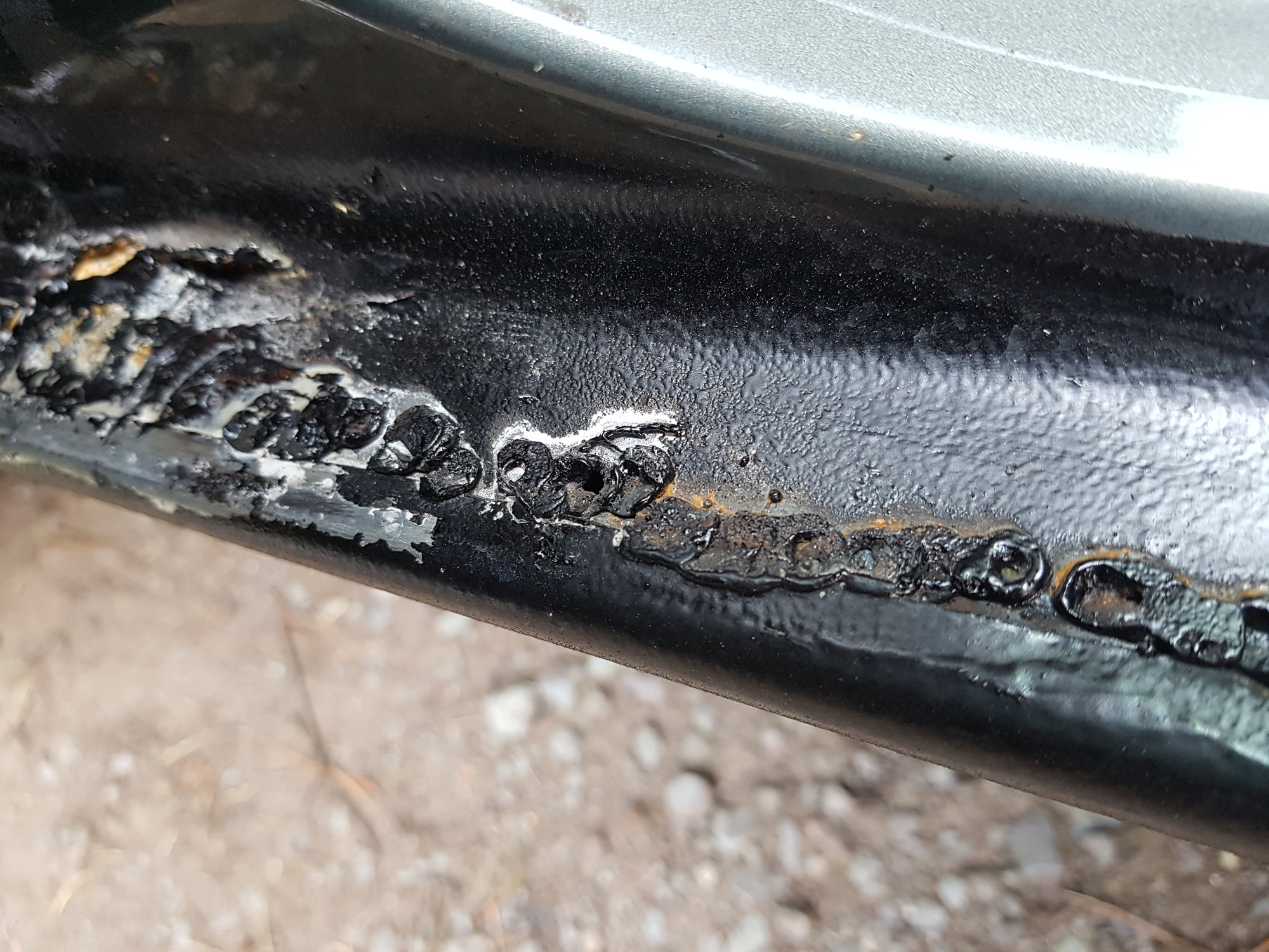

Looks funny but after years of vibration and rust it will not be funny. It looks like speed is to fast and not enough gas.
You might remeber youtuber ChuckE2009, he did a repair on a small car trailer that had a cracked weld, reason it was cracked was large crater in the end of a weld, this aint far from it
