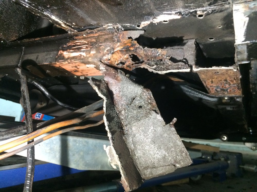

) to repair the sills on his HB Viva. When he gave it back I asked if it had done the job but it turned out he'd carved a lump of wood to fit instead and covered it with underseal. Car passed MOT !
That's a joke..it just goes to show what actually goes on .Here's another doozy- someone replaced the floor panels and just covered over the rust on the crossmember with a body panel thickness patch. I didn't drill out those plug welds - it was never welded. The forward edge was just stuck down with mastic. In some ways I'm glad because it made chopping the tin can repair easier. I can understand why MOT inspectors get a bit fussy about repair work in structural areas when people do work like this.
at all the above.
Problems with poorly done repairs on old cars maybe have a lot to do with the fact that the cost of having the repairs carried out properly, is in many cases likely to be more than the car is worth? If a car owner gets quoted say £2k for welding work, there is always going to be someone prepared to do a bodge job for a lot less, and I guess thats the reason there are so many death traps on the road nowadays, some of which are much more dodgy than your car.
If someone gets quoted £2000 for repair work (which is almost certainly going to be bodged to some extent), but finds someone else to do the work for £1200 (more of a bodge obviously), they will almost certainly go for the £1200 job.
To get the work carried out properly to a high standard will cost maybe £4000, and is the reason why so many "classic" cars are improperly repaired.
